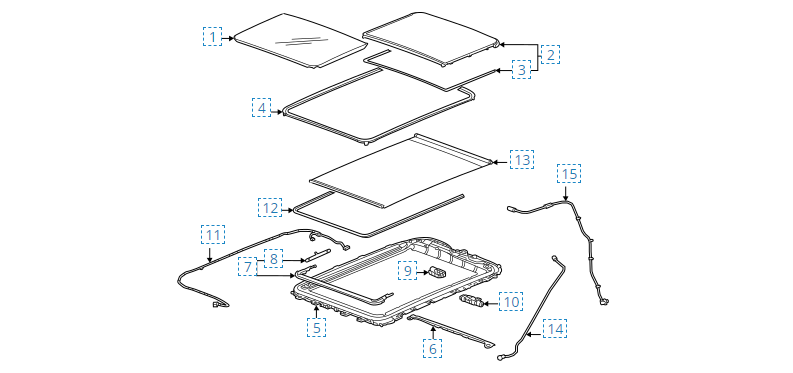

My 2021 Tahoe HC has the panoramic sunroof. On the sunroof, there is a wind screen that pops up when the sunroof is open. The arm that holds that screen up on the driver side has broken. Does anyone know where I can find that part? Or does anyone have an idea of what a dealership would charge to fix it?

Here's the parts explode for the sunroof -
I'm assuming you're looking for item # 7?

Thanks. What sight did you get that off of? I think I'm actually looking for #8. It is the spring loaded piece that holds the air deflector in the upright position when the roof is open that I'm looking for.

https://www.gmpartsdirect.com/ - Disclosure - I will never order parts from these guys, their reviews are terrible. However, they have all the GM parts explode diagrams that you can reference to get the part number. From there I take the part number and either buy it at a place like Rock Auto or E-Bay.
