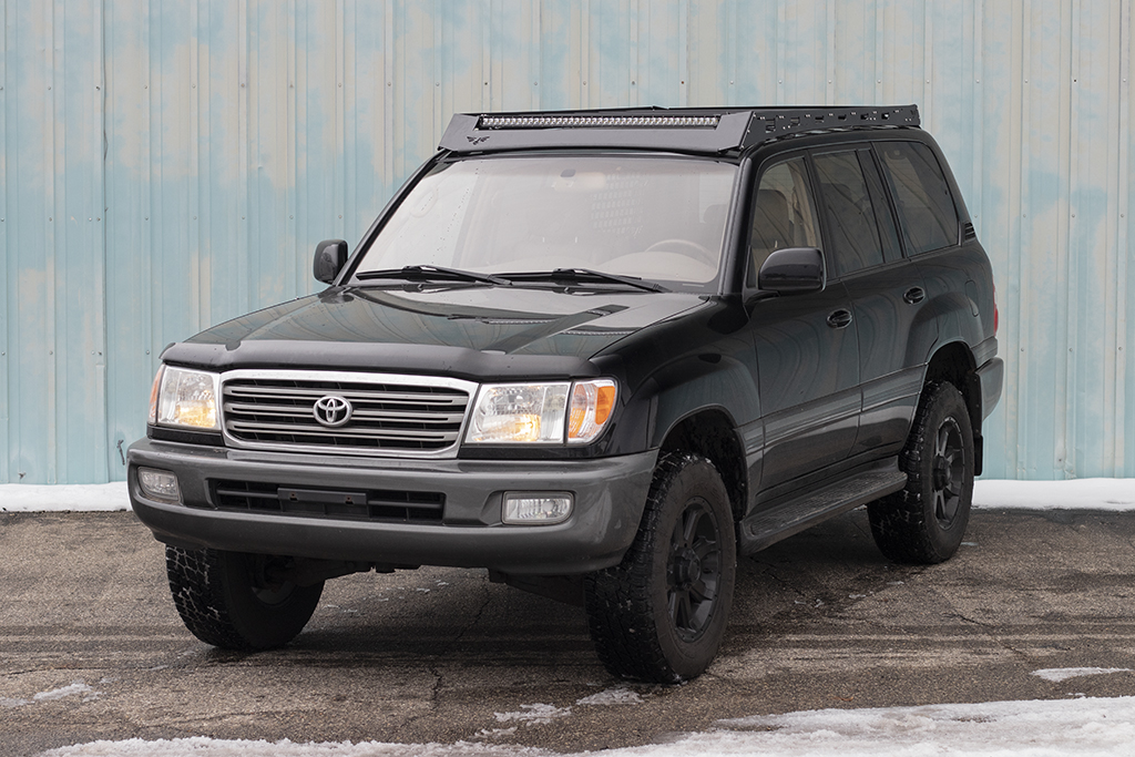

Anyone know of a company that makes custom roof racks for the 21+ Tahoes?
Looking for something like this:

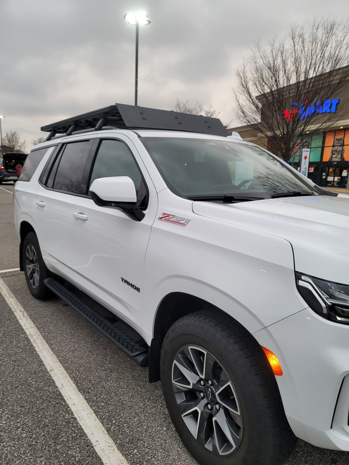

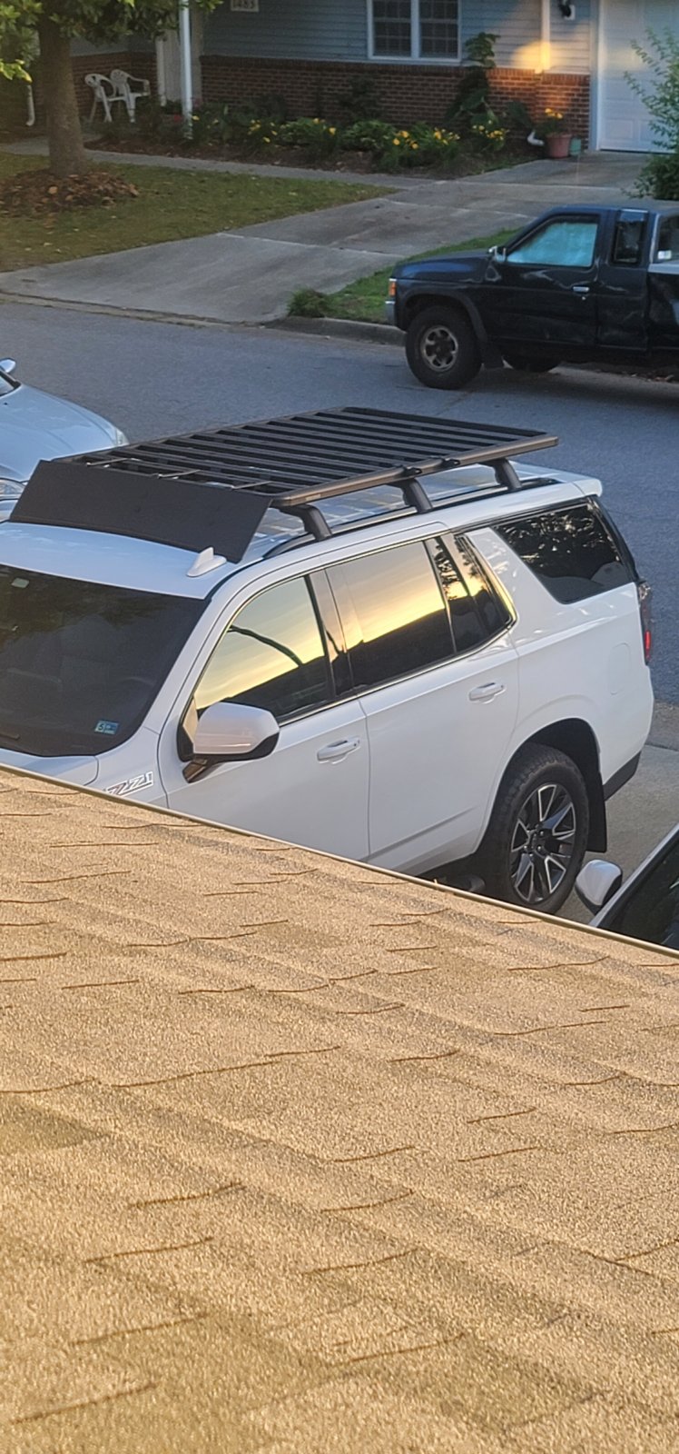

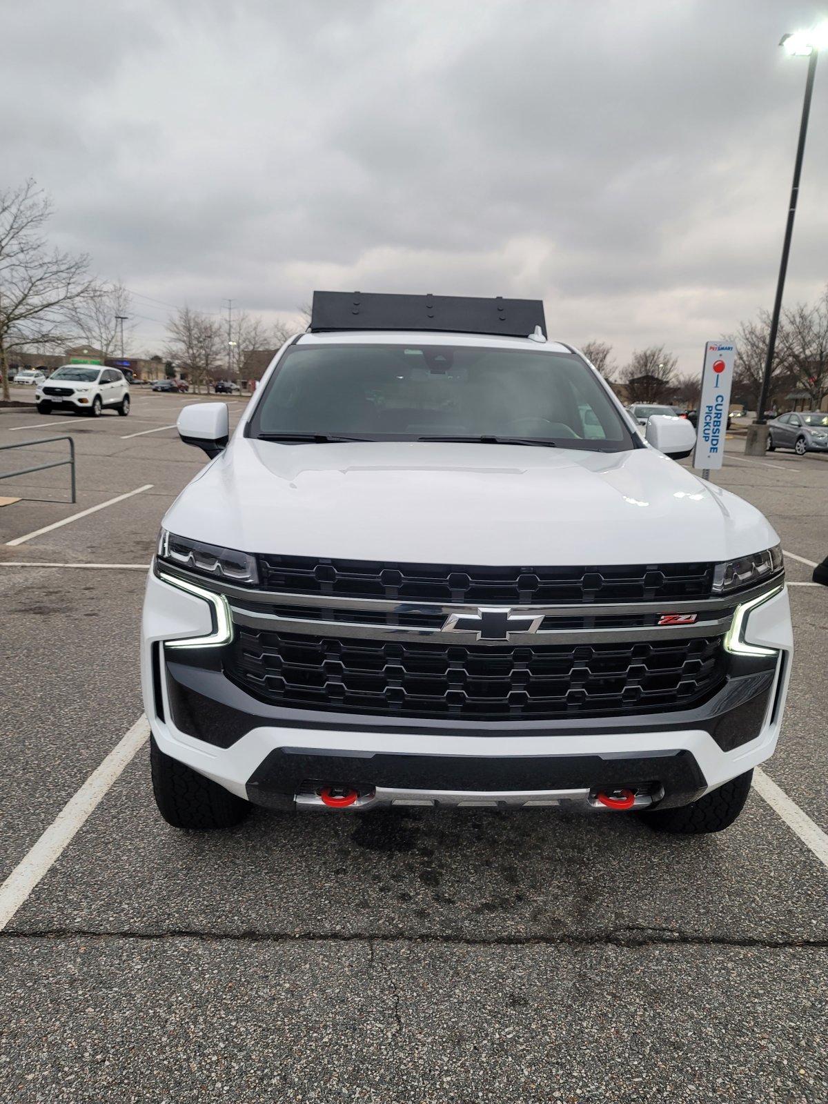

I used the Yakima LockNLoad Platform Rack for Crossbars - Aluminum - 84" Long x 49" Wide.​
Then Fabricated a wind faring out of 1/4" Aluminum. Spray the wind faring with 2k Raptor Bed liner.

@Keller55 That turned out great! Any whistling or significantly increased wind noise at hwy speed? I have a Thule Motion XT XXL mounted on the factory rails and can barely hear it. I believe it’s not as much a function of how aerodynamic the Thule is, rather how amazingly sound insulated they have designed our vehicles to be.

TrueAt1stLight , when I didn't have the wind fairing and just the Platform, it was defintely loud. But once I installed the wind fairing, quiet as if nothing was there. Gas Mileage also increased when I installed the wind fairing.​
