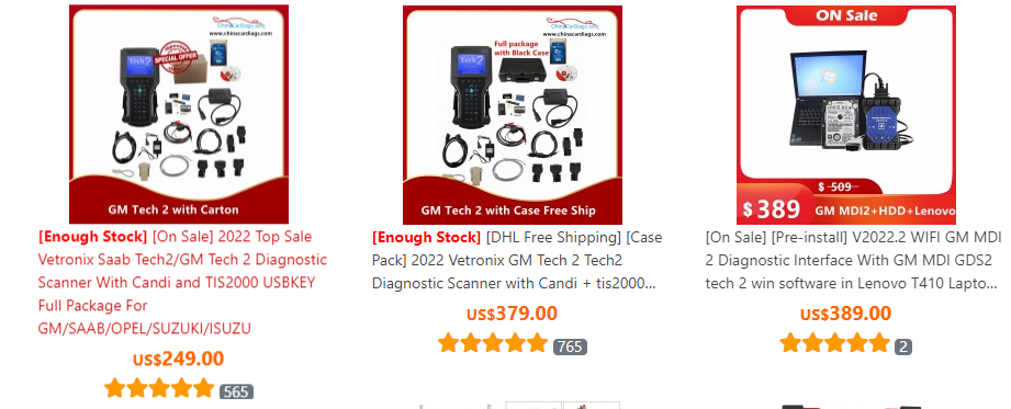

Get a clone Tech 2. China Car Diag.com. You can purchase the used part and return it if it's not in good nick. Meanwhile you'll get to keep the diagnostic equipment regardless, vs purchasing the $400 new replacement. The Tech2 will allow you to turn the blind zone on and off manually as well as verify the code it's giving you to verify that's the issue.
