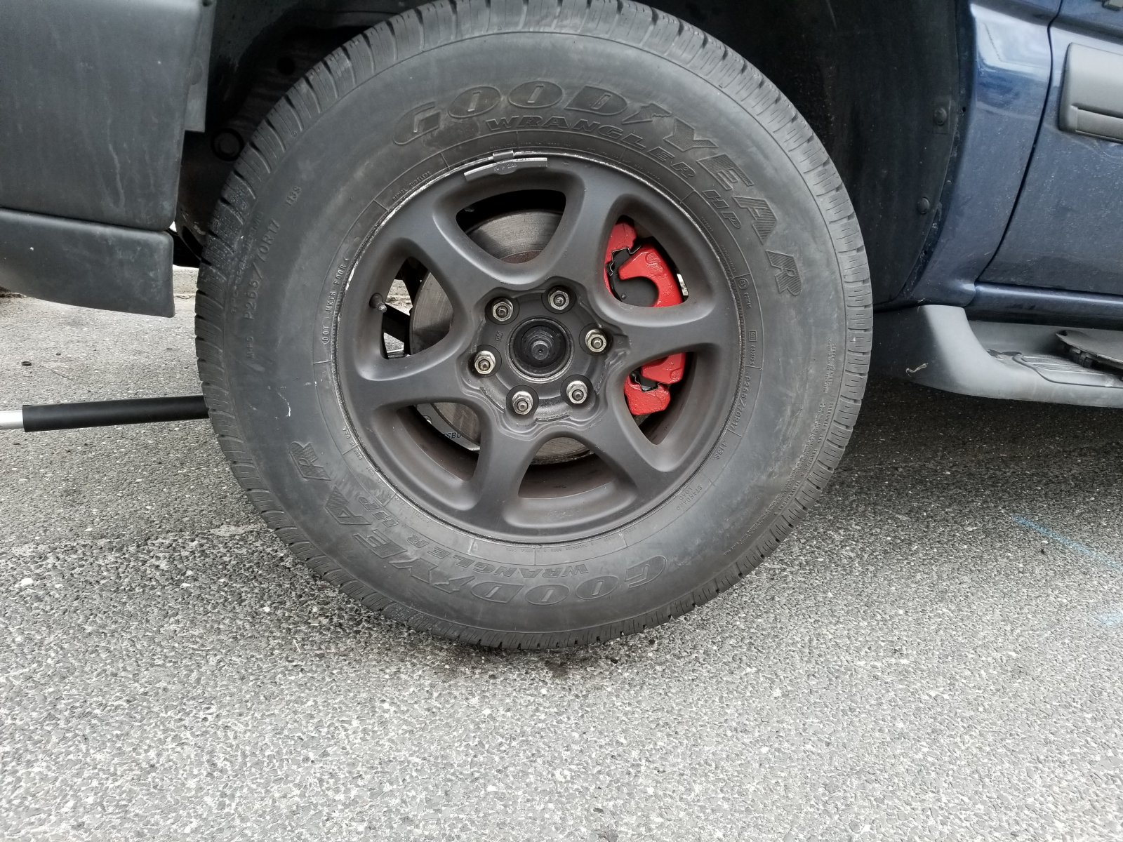

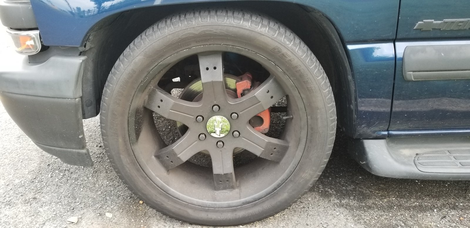

I believe someone here said the wheels have to be minimum 18" to clear the 07 and newer brake upgrade. Someone who knows will chime in.

Look at the clearance with the 07 brake setup. This is the 17's.
This was with my 22's.
