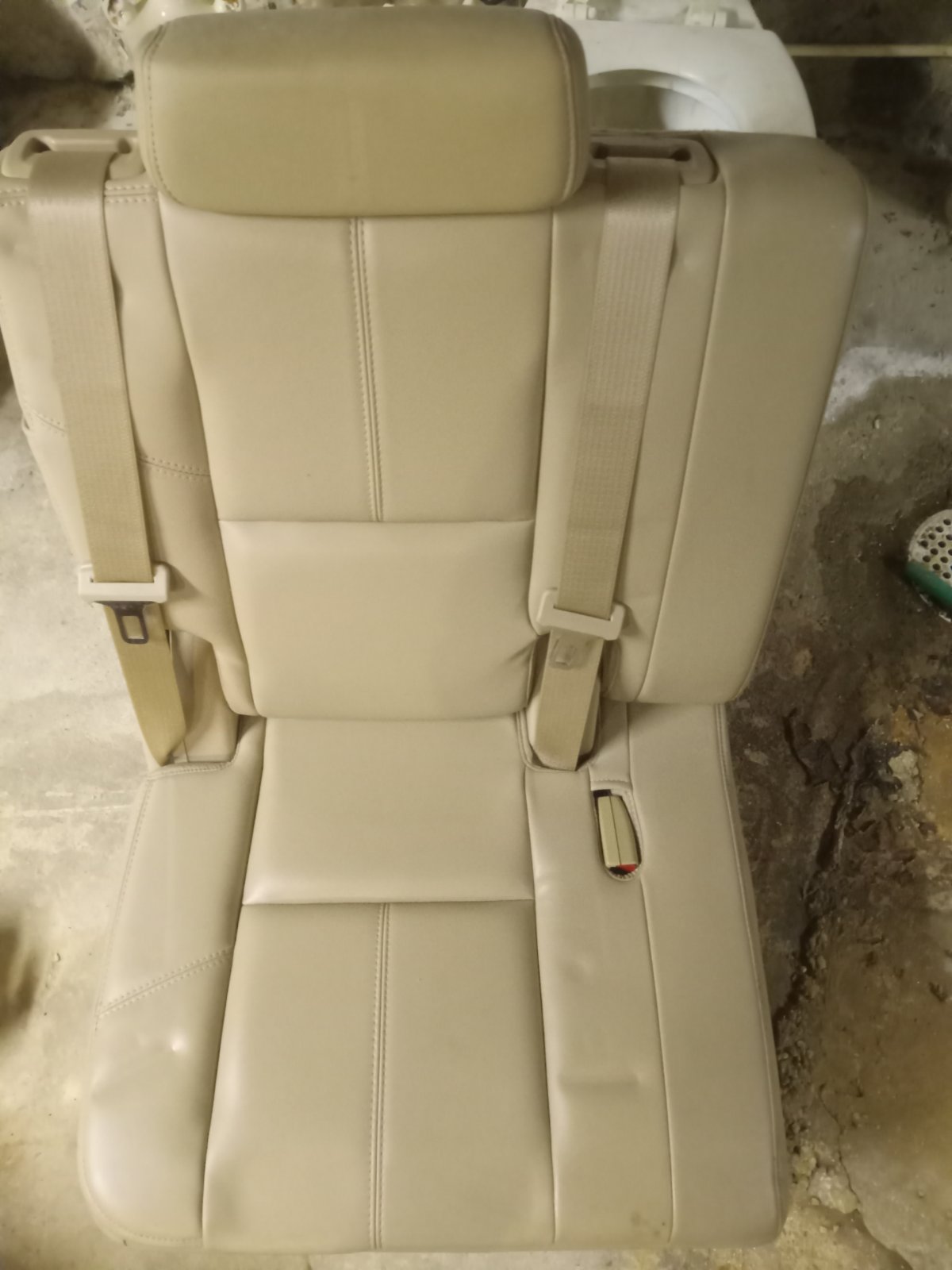

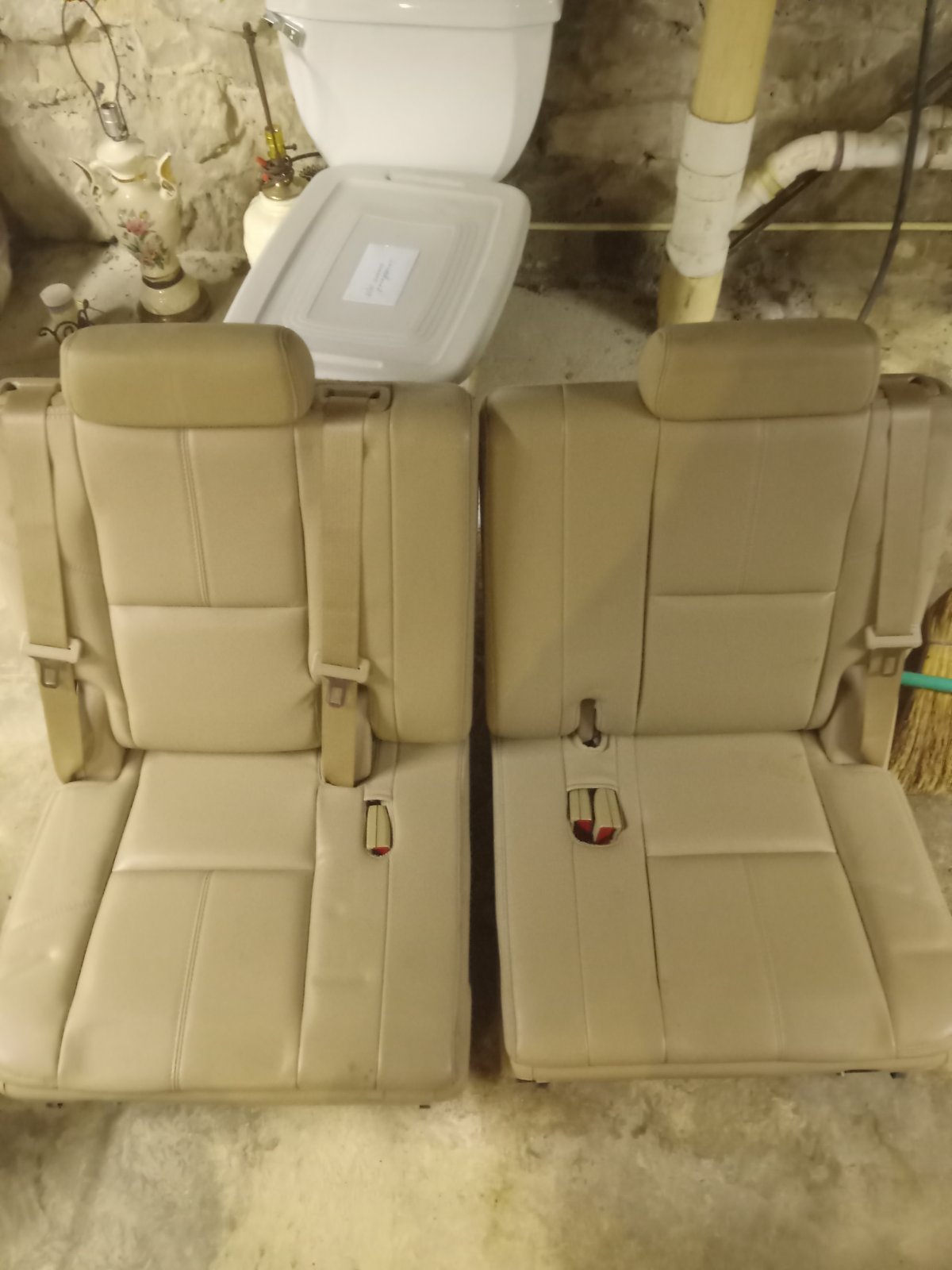

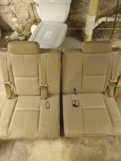

I have a set of Chevy Tahoe 3rd Row Seats tan in color for sale for 220 dollars that is cheap and they are in excellent condition but I live in Williamsport md area my phone number is 2404695263 if you like to text and I could send you pictures

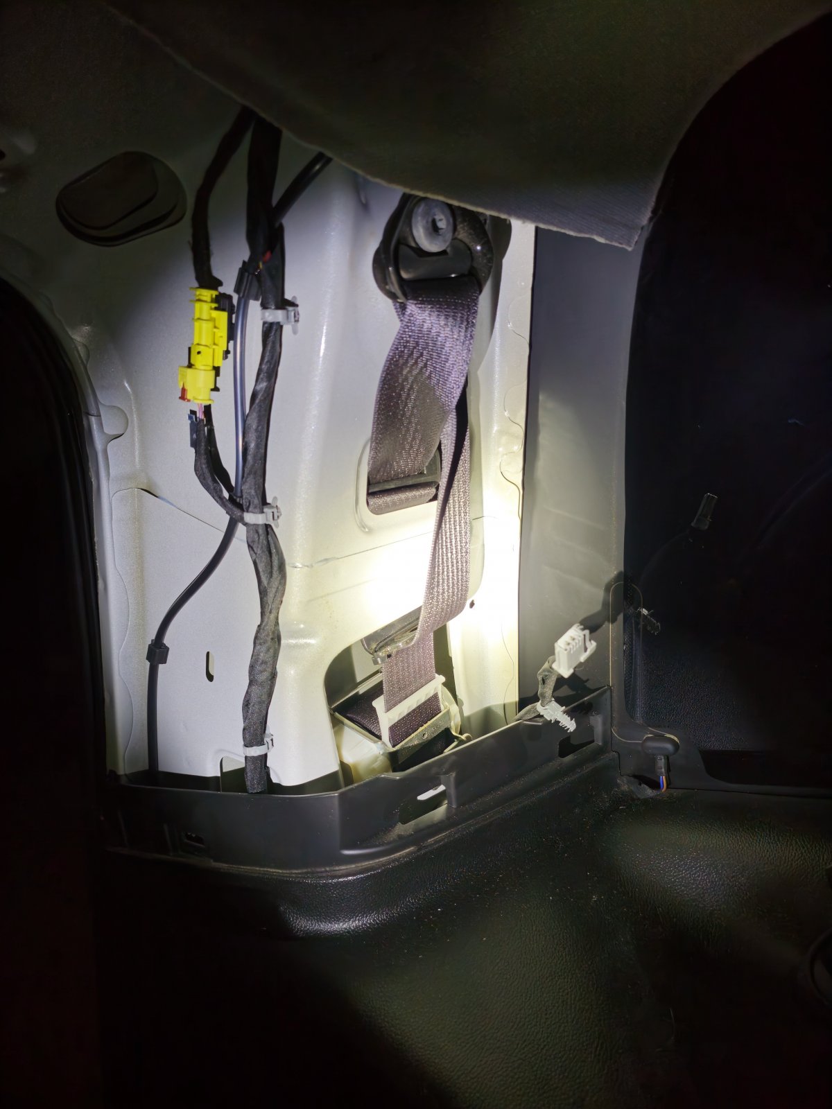

Hey there! Do you happen to have a photo of the seatbelts behind the trim panels? Trying to figure out how these are supposed to be installed. I’ve taken the trim panels off but can’t make sense of it. If i could see what it’s supposed to look like that would be super helpful. Thank you!!

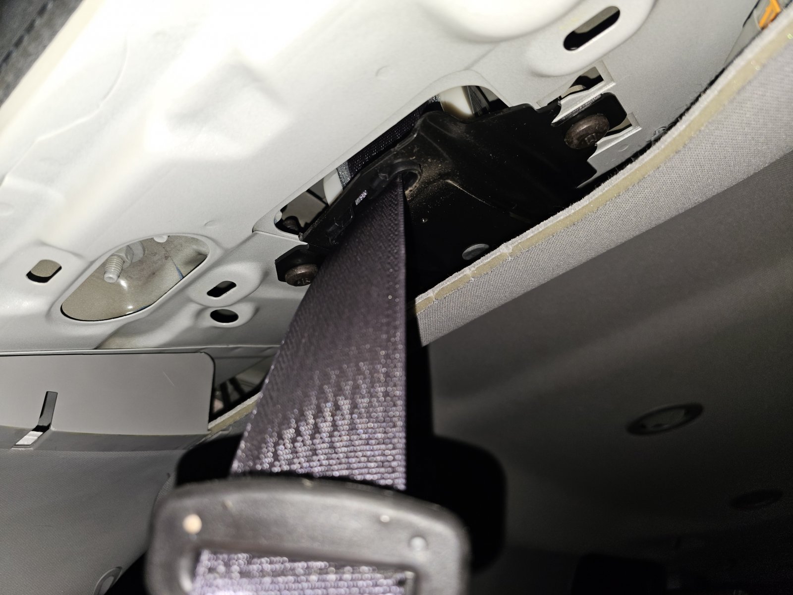

Sorry for the long wait but I went outside and got a few pictures since I couldn't find a decent angle from what I already had.
Here's the 3rd row middle seatbelt tucked up above the trim and headliner, should be pretty self explanatory.

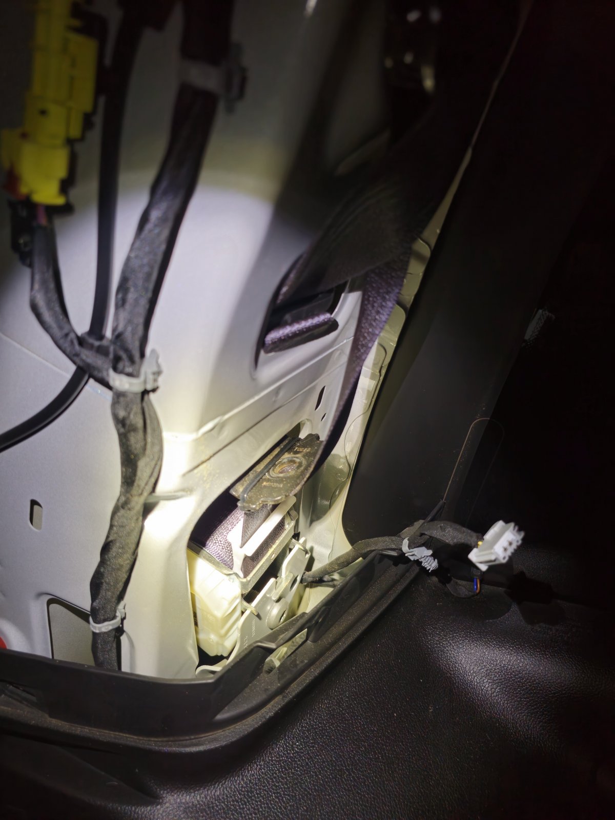

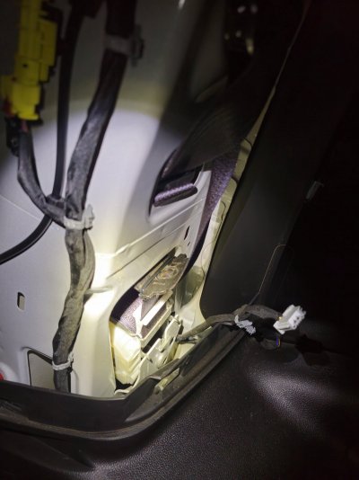

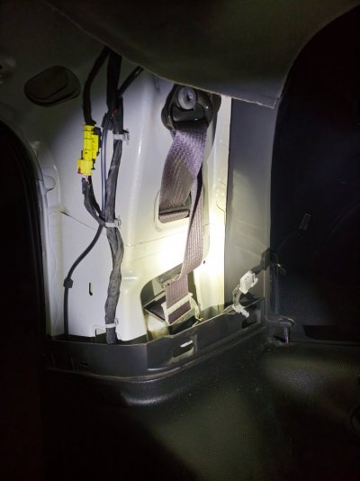

Here's the driver side rear, passenger side mirrors it.
The belt routing starts at the bottom and travels up next to the metal pillar and then is anchored above. From there it would go through the trim panel and from there bolted to the floor beside the 3rd row seat. If the picture looks confusing that is because I unbolted the belts from the floor and routed them back through the metal pillar and zip tied them to keep them quiet inside the trim panels without actually removing them.
Hopefully this helps, if not maybe I can get a better picture in the daytime and draw out the path.
