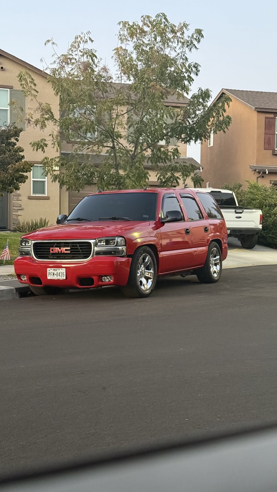

Hello! I own a 2004 Yukon slt 5.3, been wanting to install some Longtube headers, but I don’t know what brand to go with. I’ve seen a lot of people that have to hammer the headers and make modifications, which I am prepared to do, but are there any headers that are direct fit? Also, are there any modification I need to do so there is no check engine light. I have hp tuners but I know the bare minimum. Thanks!
