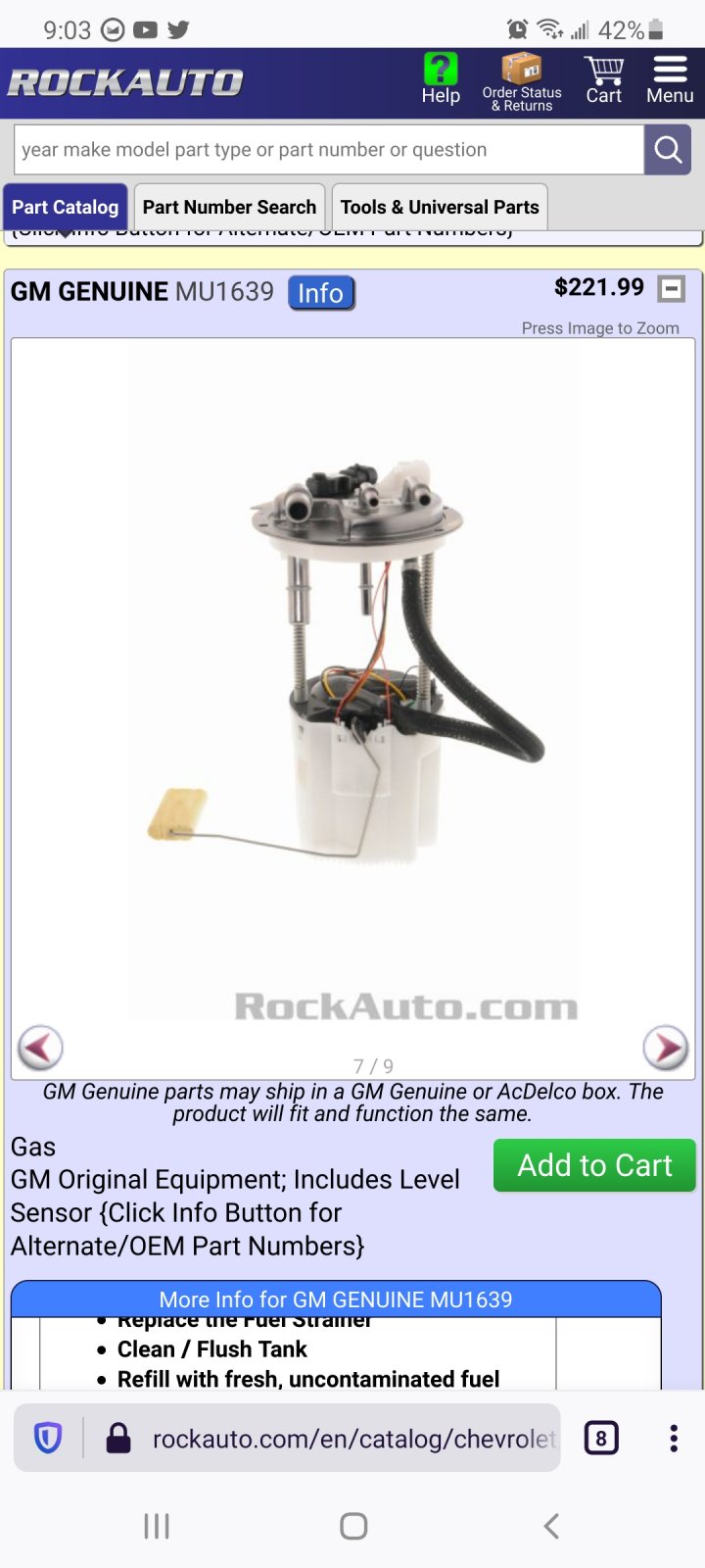

Did a little research and searching but still have a question. I think the fuel pressure is bleeding off causing the long start after sitting sometimes. Is the device that prevents this in the fuel pump module for my 04 Tahoe? I assume if it is I need a new fuel pump module.
If so, thinking I should stick with Ac Delco fuel pump module. Thoughts?

Does sound like that but could also be bleeding off at an injector as well. You can depressurize the rail and pull the rail with injectors and then turn key to KOEO position and can check to see if the rail pressurizes again and watch the injector tips for any fuel leakage. Should have no leaks. If the injector o-rings at the rail also do not leak then it is like the pump or the fuel pressure regulator leaking off. For flex fuel rig: https://www.rockauto.com/en/moreinfo.php?pk=438163&cc=1424247&jsn=924
Did you already do a fuel pressure test and then shut off key and watch to see if the pressure holds for at least a few minutes and does not bled off quickly?

If you get as far as doing the fuel pump module, the FF pump is AC Delco MU2294 for your year. And if you do plan to replace it, let us know since there are a couple of related items you'll want to have on hand. Fuel tank strap bolts, tank straps if they're badly rusted, etc.

@Fless Ok sure will! Thanks for the suggestion and the part number for the fuel pump module. From my searching it really sounds like it's the FPR. I just ordered the ACDelco one on Rock Auto for the FF engine. Plan to do it as soon as it comes in. Looks like a really quick install. This weekend I am going to go ahead and do the fuel filter. Got an ACdelco FF fuel filter coming in at Orielly's tomorrow morning, store pick up.
