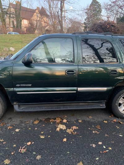

Lock switch only works for front doors?
Reeder31788
Feb 12, 2020
14
NY
Hi— have had my 03 Yukon sly for a year now, and need to stop leaving my doors open. The lock switch (and key fob) only work on the front doors, the rear and hatch need no be locked manually. Any advice before I get bent over by my mechanic?
Thanks
