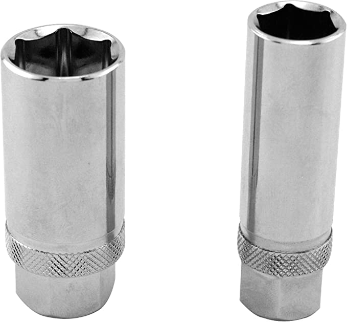

when using a real plug socket, its got a foam insert that holds the plug, as well as keeps you from breaking it. for 35 years, it dont matter what engine im working on. new plug goes in the socket, then i turn it in as far as it will go by hand, then snug it up good with a ratchet.
52,956
Exactly but the best plug sockets have a magnet now instead of the foam. I have both but like the magnetic better. Just put the plug in the socket and use that to hold onto to spin in the plug as far as possible. If it’s too short for some places I add my 1” extension.
Scottydoggs
Dec 16, 2017
2,886
4,527
NJ
magnetic? have not seen one of them yet.
52,956
Mines just like a regular plug socket, with the hex head so you can use a socket on top of it.
10,571
15,369
Can you show a photo of the "1 inch extension"? I'm not sure what you are referring to.
