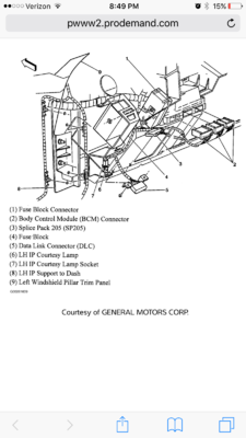

Disconnect the splice pack sp205 (#3)and check the terminals for any corrosion and make sure it has a good tight connection.
