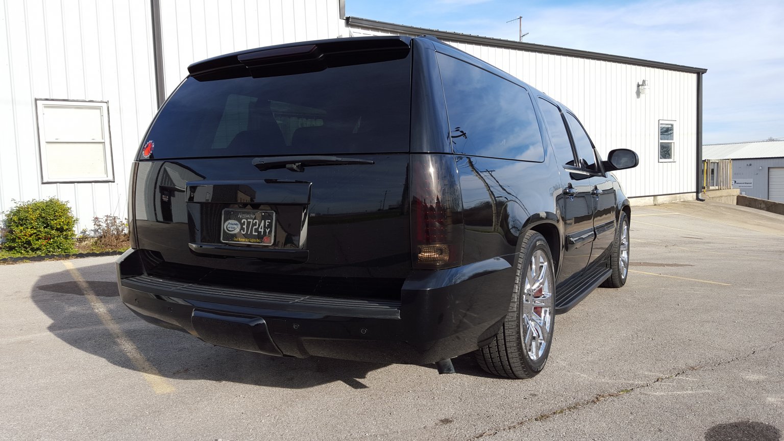

Niteshades here too... light even coats, clear coat, wet sand and polish. 20150705_162655.jpg
