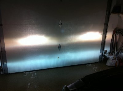

Yeah Ryan when the light is in a smaller housing it tends to look brighter, thats why the fogs look brighter than the low beams. I noticed the same when comparing my hid reverse lights and hid low beams.
Also it is common for the foglights to look a bit higher in kelvin rating because of how small they are, so it would have been a better match to run 6000k low beams, then 5000k fogs.
Also sometimes because of the 25w ballast you got, the fog lights will look higher in the kelvin rating (more blue) because of the smaller amount of wattage.
Kind of how 8000k 35w and 8000k 55w hids look different, with the 55 watt being less blue because of the higher wattage.

Yeah, I kinda figured that. Looking at my lights, the low beams themselves aren't that much more powerful, to be completely honest. I did notice that they're only 35w, though. Maybe that's why.
I had a local shop install them and I was inspecting the work to find that they didn't really secure anything (ballasts) down with double sided tape (even when I provided them with it).
How critical is it that everything is secured down? It kinda looks like they just installed it and bunched all the wires right behind the headlight, between the headlight and the heat shield. I am seriously considering going back through and double sided taping everything down.

Guys, fwiw,
The shop that installed my lights used the 25w ballasts for the headlights and the 35w ballasts for the fogs... they ended up switching them back to their correct place, but the foglights are clearly still much bluer (remember both are supposed to be 5000k).
Here's a picture!
