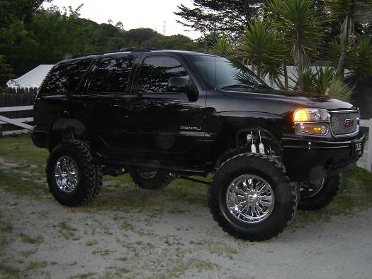

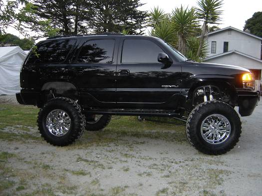

I know this is an older thread but do you know what the lift is on this truck? No way is it just a 6" procomp. This is the exact setup im looking for.
This truck was built by my co worker, it is a 12" full throttle lift with 39" Irocks on 20" wheels. It was built back in 05 and he sold it to someone 2 years later who unfortunatly rolled it and his brother died.

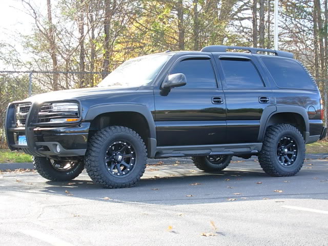

6 inch lift by Pro Comp with 35 inch tires
http://www.roughcountry.com/Chevy_99-05_6EXin.htm - 6 inch lift with 35s

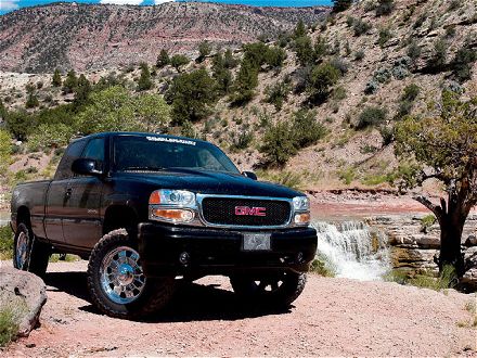

15 inch Full Throttle Suspension
6" Rough Country lift....35" Mickey Thompson's MTZ....20x12 TIS Wheels....

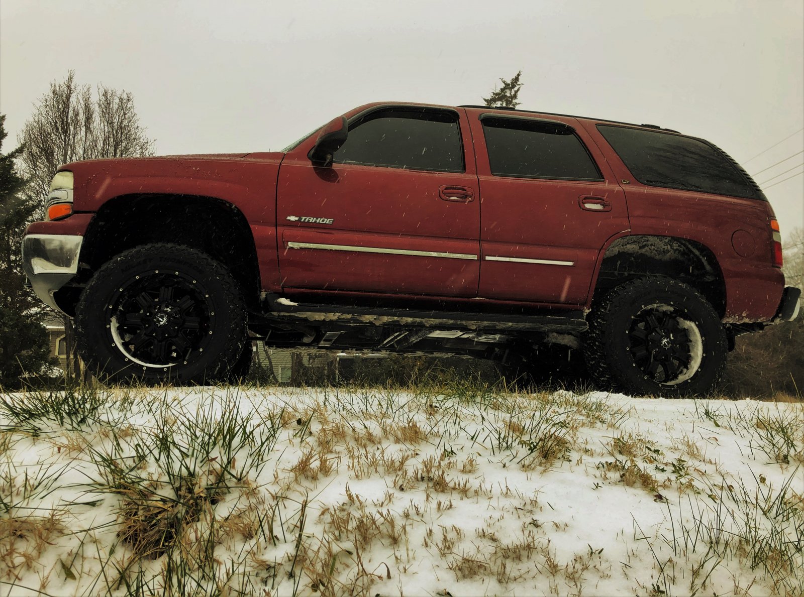

to fit 33s your gonna need keys and spacers. Ford F150 keys will give you 2-2.5"s. Spacers range anywhere from 1 to 3"s. I would go with a 1.5" spacer.
Ford keys
1.5" Spacer

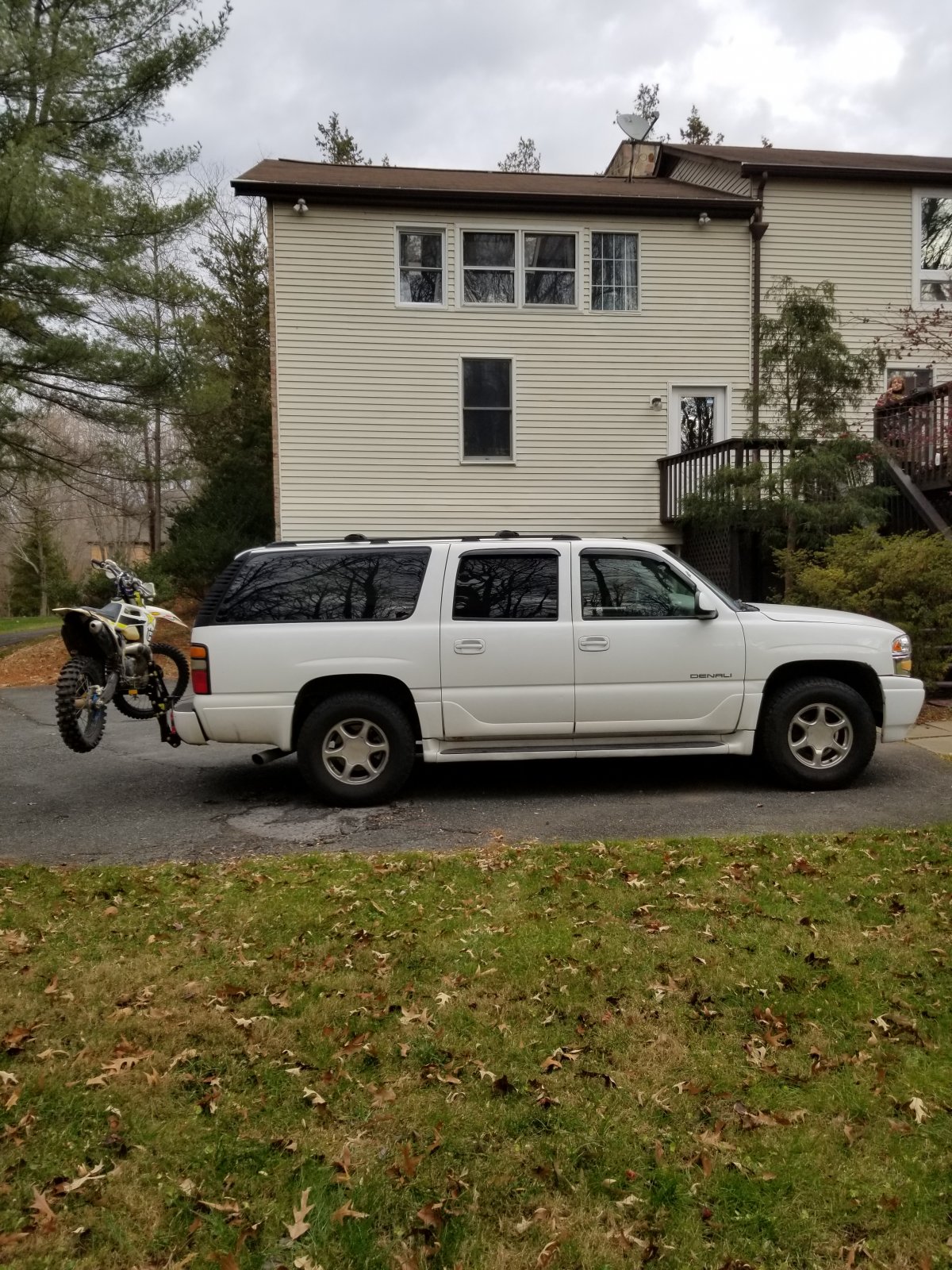

"Ford" keys? Are you saying "stock" F150 torsion keys will give me the 2-2.5" lift? I have a 2001 Yukon XL and looking to lift it so I can run 285/70R/17"'s. The offset of your wheels looks great. What wheels and what offset are you running?
06XLDenali
Sep 29, 2021
23
21
I have a 06 Yukon XL Denali on 285/70/17 (stock wheels) cranked the stock torsion bolts 6 full turns each side. Z71 rear coils off rockauto.com for like $75 and I went with KYB monomax all around to delete the failed auto ride shocks. Rides great and doesn't squat too bad when towing.
