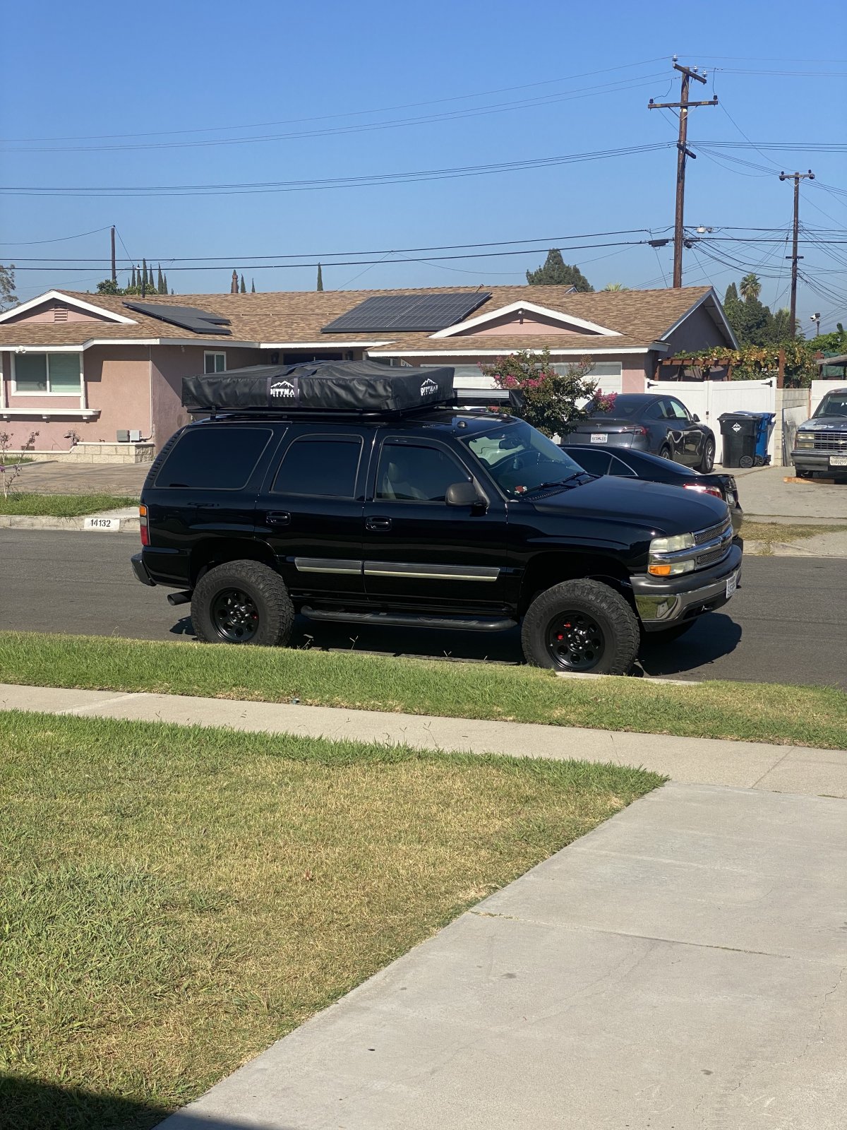

TurokMakto
Sep 4, 2021
04 hoe
Rwd
3in front keys / 2in spacer rear / both from supreme off road
17s on 35x12.5
Replaced upper control arms to fix ball joint angle. Used freedom off-road also 3in spindle from them. Upgraded spring to a heavy duty spring from SDsprings.
Panhard bar from supreme suspension
Panhard bar drop bracket and rear sway end links from fabtech. Have 5100 in the rear and 5160 in the front.

Walchit
Aug 29, 2021
447
911
I like that tent! What control arms did you use? I was having a hard time finding any aftermarket ones
TurokMakto
Sep 4, 2021
Thanks! I found the control arms on freedom off-road.
