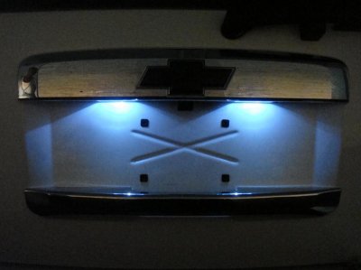

YUP YUP i had to do the same thing thought i had been GOT but looks amazing if i do say so myself.
