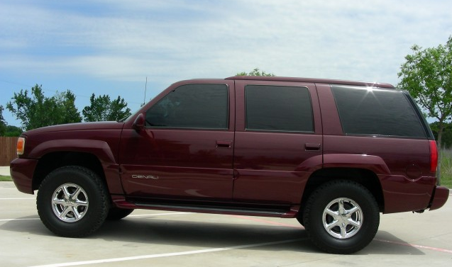

Anyone know where I can get this stuff for less?
http://cgi.ebay.com/ebaymotors/ws/e...ssPageName=VIP:watchlink:top:en#ht_1863wt_939
I've found keys for less than $100 and I don't think the block kit is worth $200.
Links would be appreciated :)
btw before y'all tell me I'll want to go higher I don't have 5 grand to spend and this is the look I'm going for:

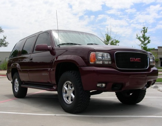

Do me a favor and try cranking up your stock keys before you spend money on after market keys. The OBS trucks typically have enough indexing on the keys to crank to the droop stops which is too far. I got 1.5" out of mine and could get double that if I really hated my front end.
So crank the front up and see if it gives the look you are after.
Adding a block to the back will not level the truck. My guess is that the front of your truck is at least 1" lower than the rear.
If you do need blocks summit sells them for pretty cheap I think.

I'll give it a shot, should be easier than pulling the oem ones out. I'm just considering blocks to avoid cali-lean.. It looks retarded

Keep in mind that when you are truely level at each corner it still looks raked. I feel that 1" taller in the front makes it look perfectly level.
