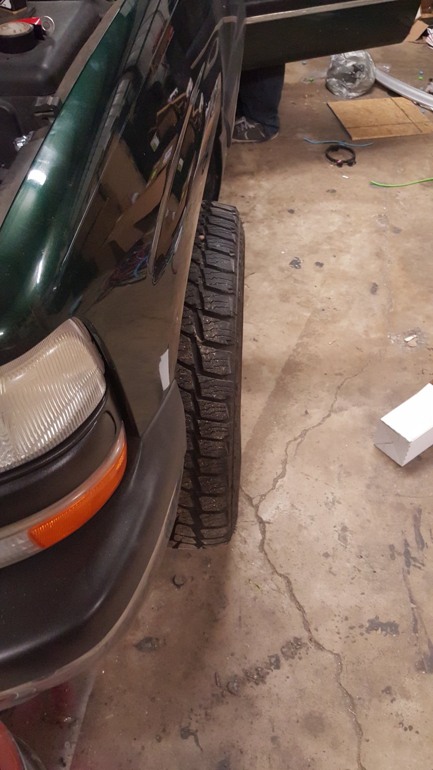

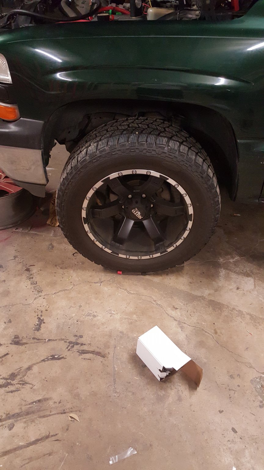

Well it sits level as far as I can tell but I am wanting to eliminate the rub. The side rubbing has the key maxed out already. I've trimmed most of the plastic but it still hits when maxed out a tad on the corner of the bumper and a little plastic. I'm guessing my options are to get the 3 inch lift knuckles I believe they are called from RC I see people using, or a body lift (not wanting to do)? Tires are 305/50/20. Thanks for the help.

Yeah that looks like its offset induced. You're either going to need to do more serious trimming, lift spindles (possibly both) or lose the wheels.

Is it rubbing the metal bumper corner? If so can take a grinder and blend the transition to the plastic lower section. Any rub on the back corner near firewall?

its rubbing on the corner of the metal bumper, it doesn't rub on the back but it is within a quarter inch of hitting. I might just do some spindles to fix all the rub problems. What is a good brand of spindles to go with?
