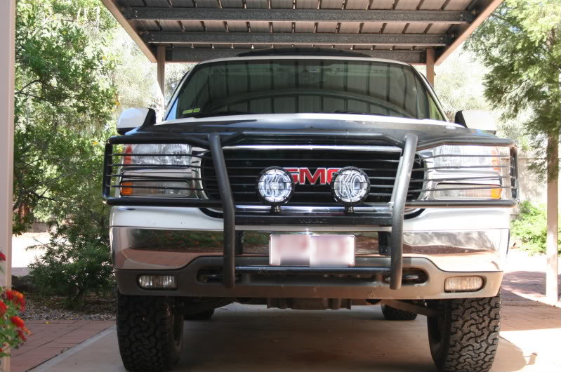

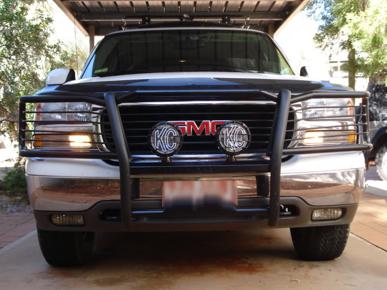

heres a shot of the Yukon with the superlift keys (with stock bolts for the extra .5 inch of lift) bilsteins and the bfg ta 285/75/16's It will give you an idea of the size of lift acheived with basic stuff.
BEFORE SHOT:
AFTER SHOT:
BEFORE SHOT:
AFTER SHOT:
Nice rig, ryan. :D

Thats a huge difference Ryan! So im better off getting F150 keys if im going to do this rather than cranking the stock to max? Where can i get a set of F150 keys? All i want to do it make the front as high as the back so what do you guys think stock or F150 keys?
