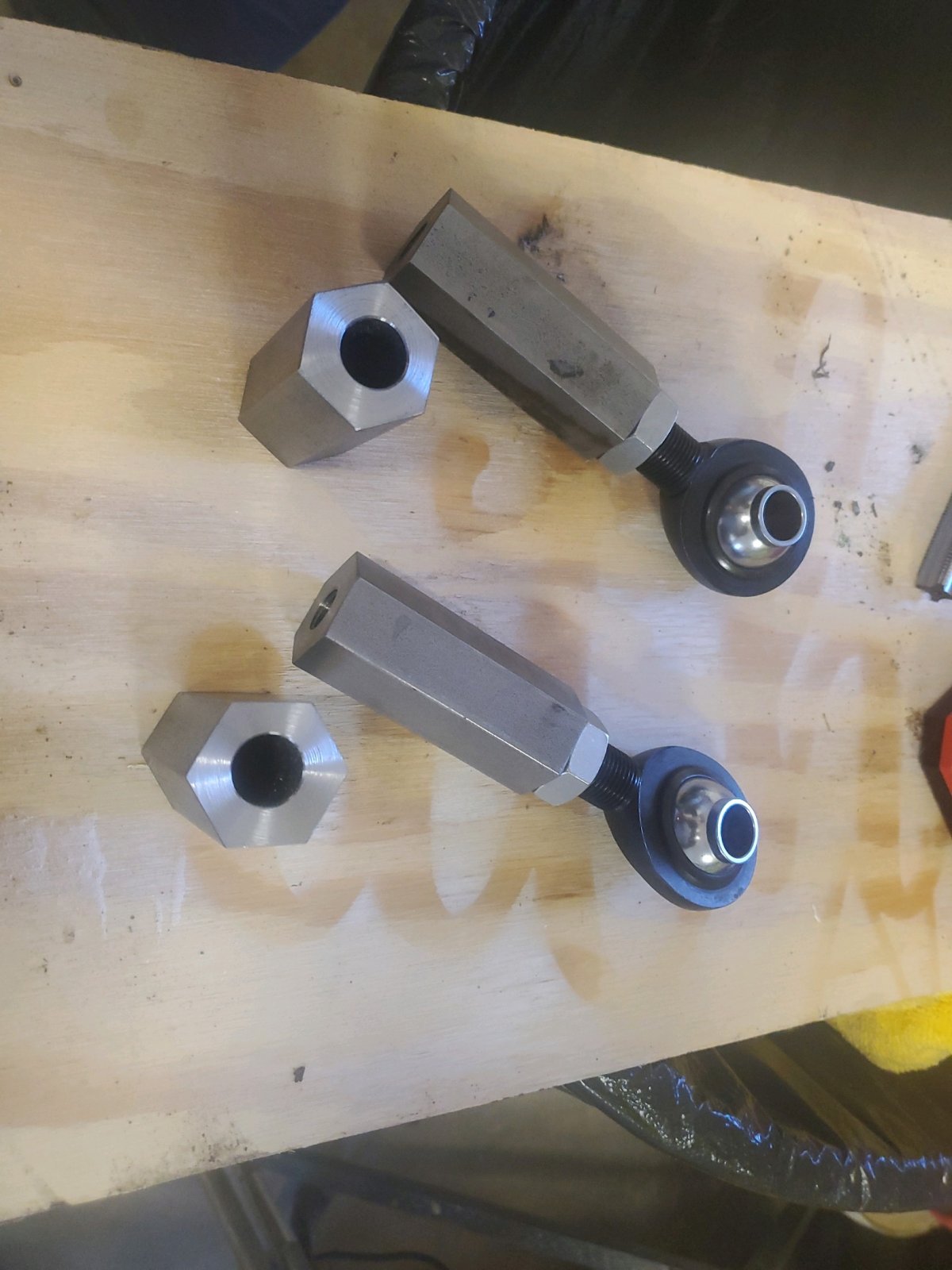

Looking to correct tie rod angles is pitman/idler arm drop a option please help
imi4tth3w
Jan 14, 2010
386
60
Texas
not an option. you'll need a proper lift with aftermarket steering knuckle and lower control arm relocation brackets. most of these lifts are at least 4" of lift.
other solution is to de-crank your torsion bars and reduce the amount of lift you have in the front.
Mrobinson
Mrobinson
Sep 19, 2021
28
Problem corrected the opposite of what the lowered fix is,eliminated my bump steer

Spacers under the tie rod ends?
Not in my garage. Steering linkage is already a weak point in the GM design.
