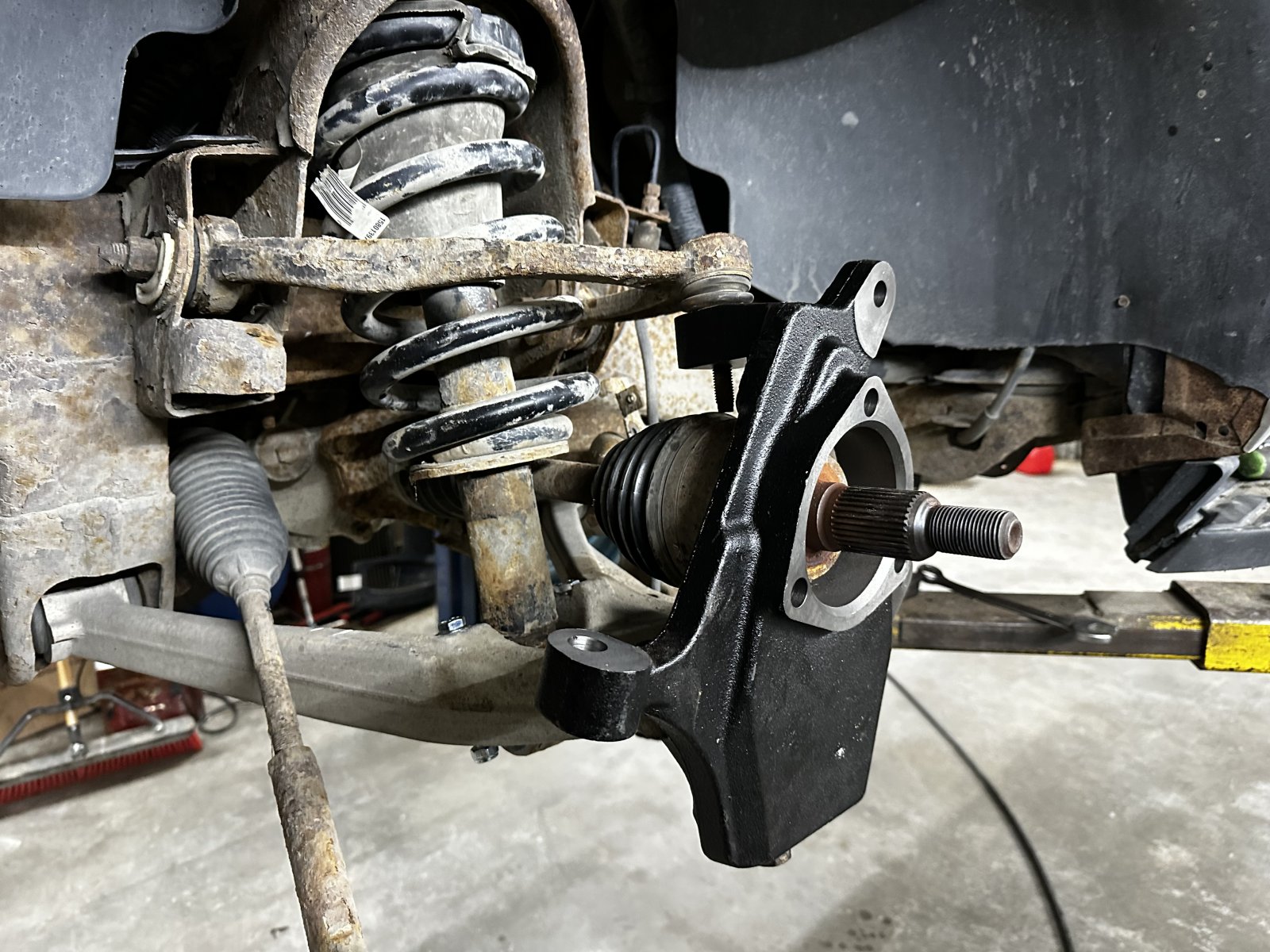

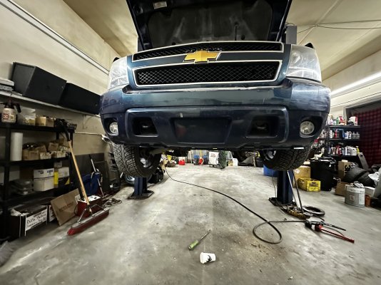

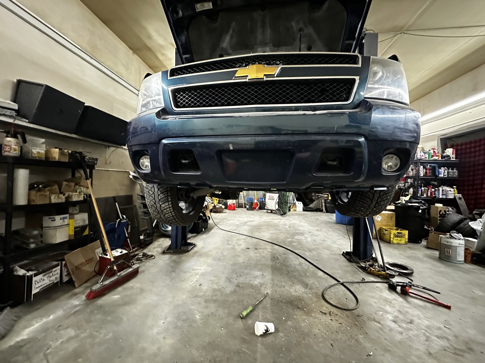

Getting the wheel gaps right!
2” Knuckles and strut flip. The RC shim trick is 2WD only, as I found out.

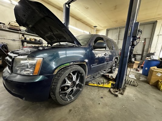

Can any one suggest a part number for a bolt on rear shock for the 4” rear coil? Or know the compressed/extended lengths? Not to eager to run the drop brackets

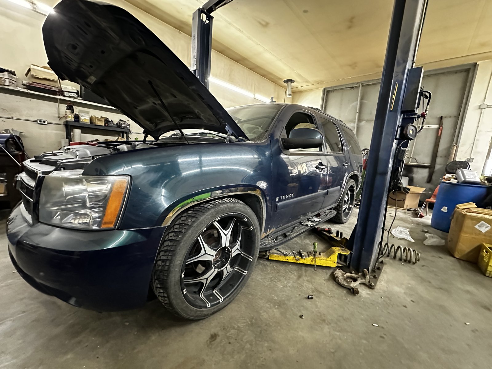

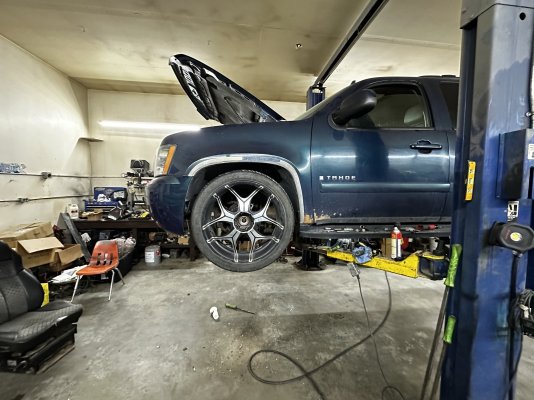

Whats the trick to limit rear travel while on a 2 post, limit straps??

What is the Rough Country shim "trick"???
Your rear suspension should be limited by the rear shocks and not allow the springs to come out.

Thats a good idea, limit straps.
I have PPV rear springs springs with 1" spacer. My z71 shocks could still allow my rear spring to pop out. PPV shocks would be a little short. If I can't find the right length shock, limit straps might be the solution.. Stock shocks may work, but the PPV springs don't extend very much..
Belltech 2410FF shocks have:
Extended length: 20.5 in
Compressed length: 13 in
I run those with the shock relocation brackets on 5" drop springs and the springs keep taught in the buckets at full droop.
From searching around, Guys can use a strut spacer backwards to gain another .750 -1” drop on a strut flip. CV axle and the strut get really snuggly.
Yeah, with the drop brackets I can remove the springs at full droop, maybe a non issue potentially never going airbore while moving lol.

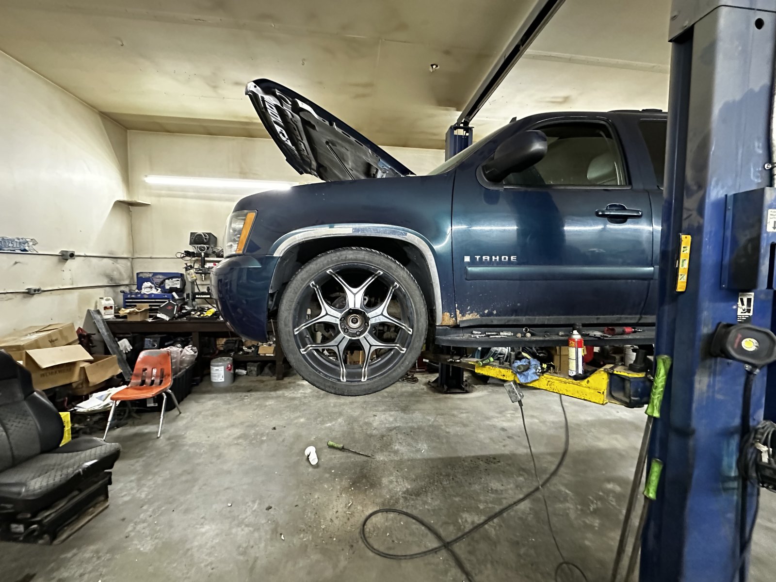

Had to nip the fender and fold cab pinch weld, tie back the park brake cable to the cab mount and a W/W fluid tank delete. Gotta get crafty with that one, looks like theres room in the upfit battery tray?
Got about 3/4” clearance at the tightest, onto the other side now.
285/40-24’s
Also, i’m at like 95% with the tie rods and still toe out. Haven’t found anyone on the forums talking about having to trim the outers, like we have too with Lifts..
I didn't realize this was a trick.
The drop kit Rough Country sells comes with a 1/4" spacer to go with the grade 9 hardware which they claim equals a 2" drop. The way the geometry is on these rigs a 1/4" spacer equates to 1/2" drop, or lift depending on where you put the spacer.

First test drive went good, the eyeball alignment is good enough till i can get it on a machine lol zero rubbing
Yep, bought the kit for the extra drop and bolts. incase the knuckles and strut flip wasn’t enough.. but it’s plenty. So I went down to the ol’industrial supply and splurged on 12.9 hardware. So far so good
