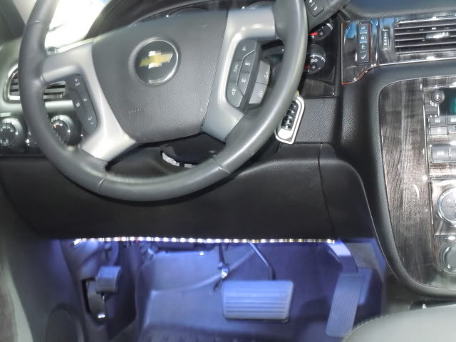

Not the best pic but you get the idea.

Loooks great dude! Can't wait until I get all of my LEDs hooked up ughhh taking to longg:sleepy10:

I think u should of hid them better so u couldn't see the actual light but looks good

I took the picture from the back seat and aimed the camera down a little bit to much but the lights are well hidden.
