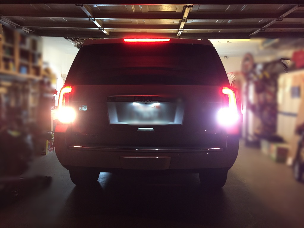

I ended up buying a different brand on ebay for around ~$28 for the pair. They're rated at 30w @ 800lm They are very bright! Very happy with them and also ordered the license plate leds from them. Both are great.
Backup lights
License plate

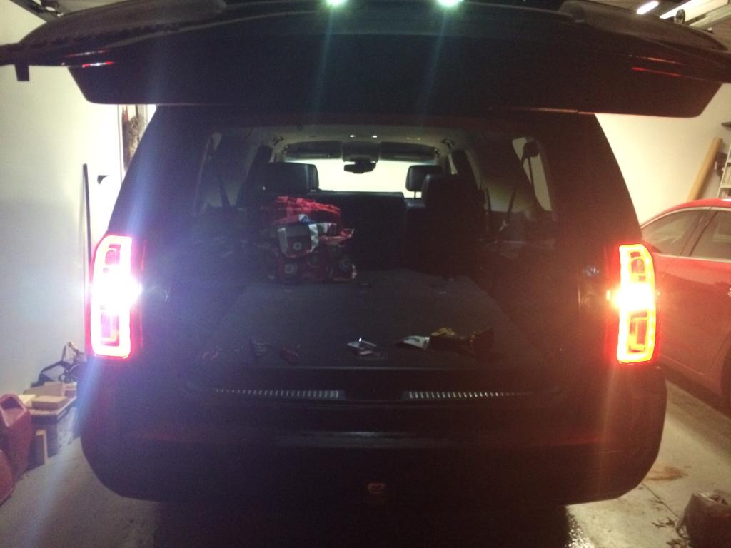

No pics in this thread (though I think there are some elsewhere...), so I thought I'd post a few with the results...
I ended up ordering the "Philips 12841B2 White Exterior Vision LED Bulb (Pack of 2)" from Amazon. The came in over the weekend and I popped them in tonight. Installation was fairly easy as mentioned elsewhere - remove the trim piece that covers the Torx screws that secure the light, remove the screws and gently pull the taillight assembly out. I had to use a pair of pliers just a bit of force to get the reverse light connector to rotate and extract from the housing - but then the bulb was a quick swap and put it all back together.
The pics don't really do justice, but here is one with the LED in the left side, and OE in the right...

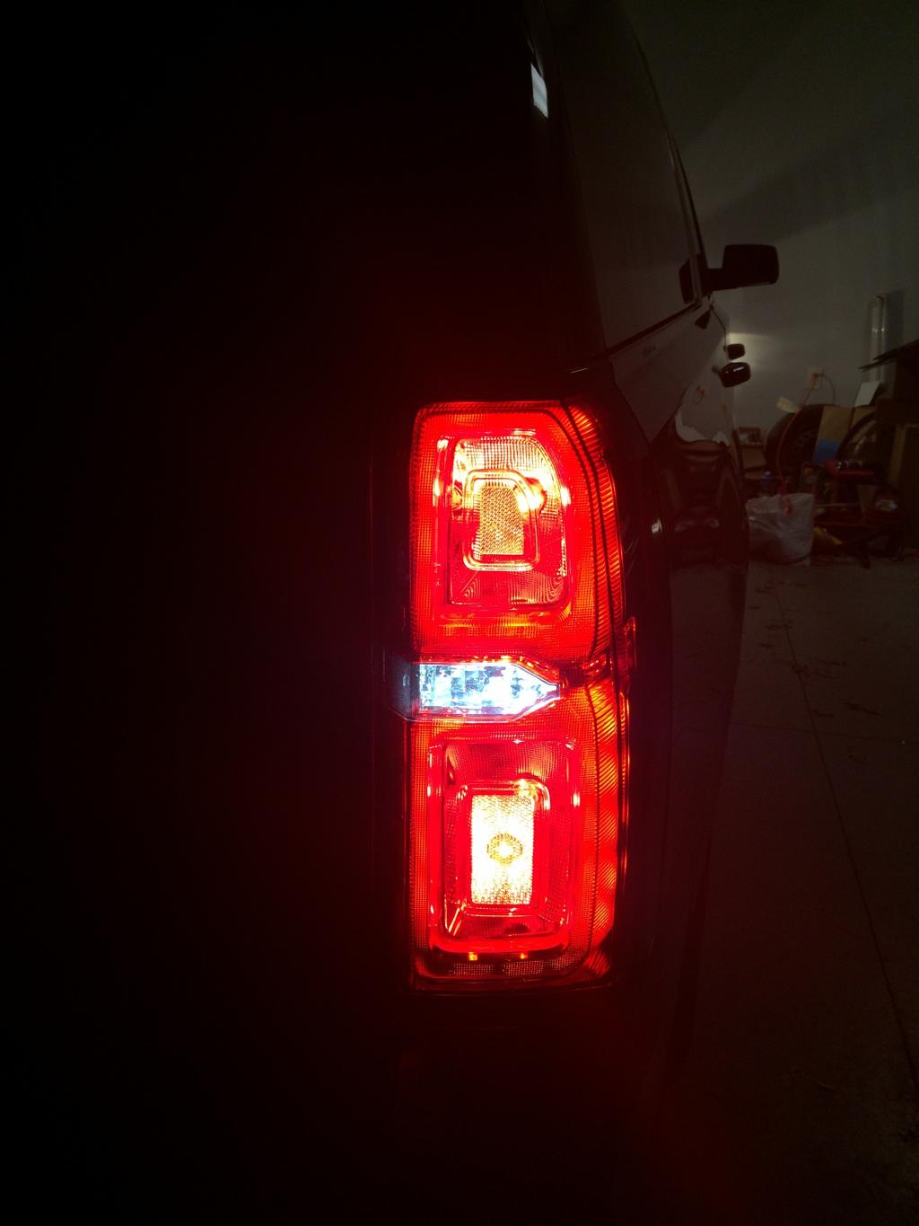

Then a close-up of the tail light with the new bulb - definitely looks better with the whiter light - and definitely brighter.

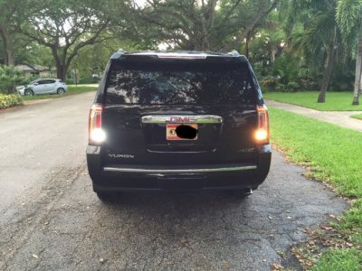

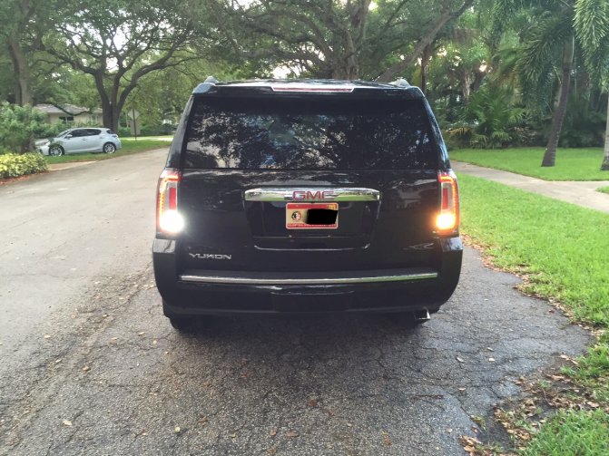

I went with Vled, cost a tad more but no regrets. Here is a comparison of stock vs vled.
[/URL]
dhabes
Nov 11, 2015
Put the VLED on my '15 Yukon and love them. Also have the VLED fogs and license plate light.
