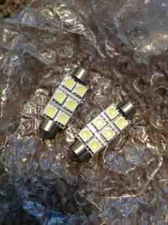

Led puddle lights...I bought the correct fitting ones that another thread on here led me to. They arrived in mail today. I've seen where some people have installed them backwards. But I see no way to tell which is forwards or backwards?

install them with the bulbs facing down, just like you show them in your post, that is the side that points down for the light.

Put in my license plate LEDs tonight and....nothing. Polarity maybe?
If your tail lights and headlights are on but the LED's don't light up, you need to spin the bulbs 180 and reinstall! Polarity for sure!

Flipped em! Now they're good. I just installed em in my doors too. I'll take pics of whole truck. I ordered all my LEDs off eBay from china. Gonna be awhile for shipping. But so far so good on the ones I've received, and they look great too.
