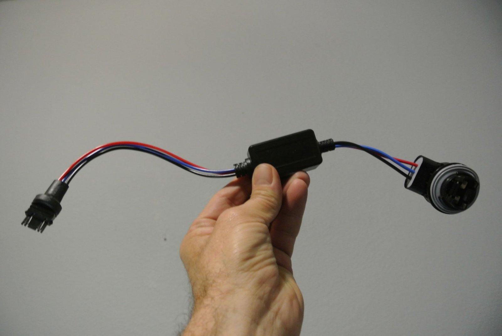

I have led tail lights they came with resistors, the front marker lights I put in led's and got hyperflash I ordered a set these plug-n-play resistors from china, one had a short in the bulb socket and the bulb would flicker so they sent a replacement out it just came in the other day so i haven't had a chance to try them yet, I did run them on a benchtop power supply for a good while since the lights on the yukon are always on and then flash for the blinker, these got to be around 150-165 deg's (on the outside of the plastic) the plastic didn't melt there is a little bit of epoxy on the inside with the resistor, so if I let them just dangle they shouldn't melt anything. I will report back after it stops raining here and I get a chance to plug them in and try them.
30,583
48,088
So AFTER some screwing around I discovered if both plug-n-play resistors are installed everything works just fine, however the sockets do not fit, I ordered some different ones so well see what happens.
