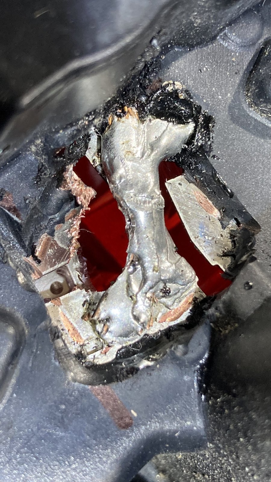

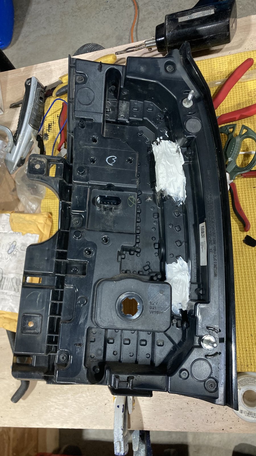

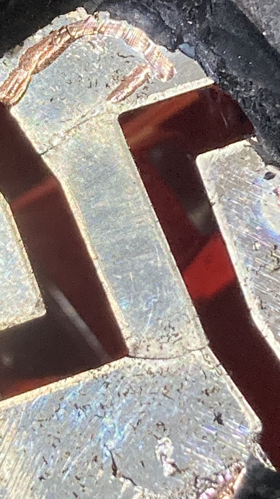

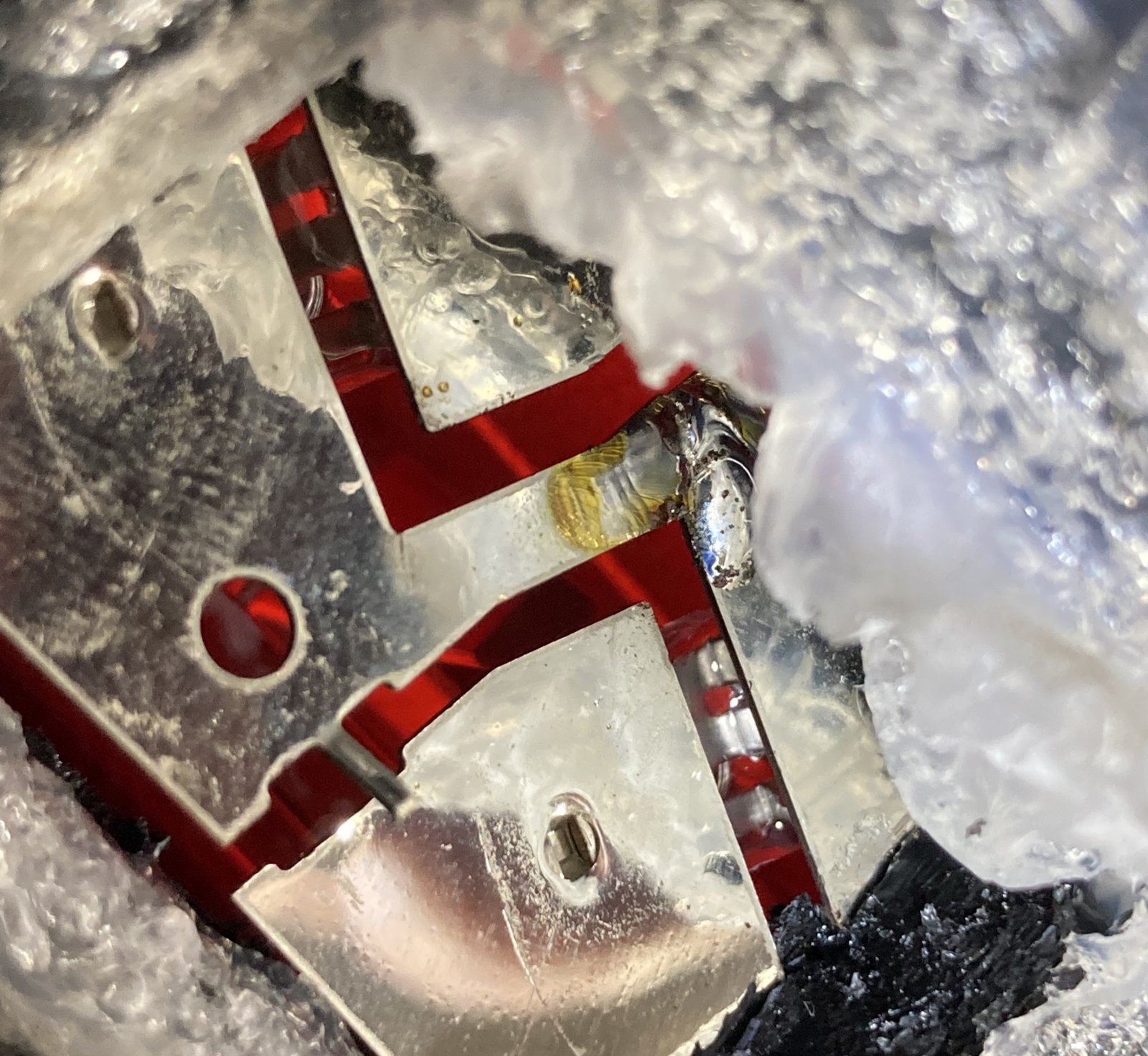

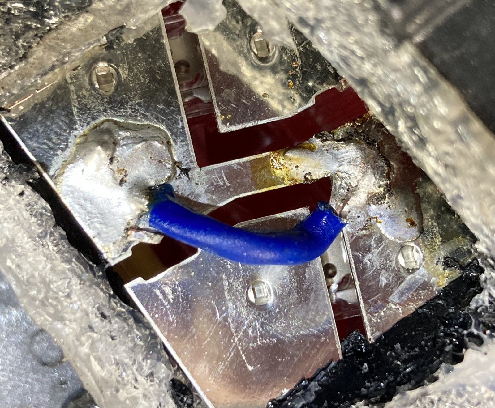

Just did this tonight. I pulled the drivers side unit and it appears to have already have had a repair that failed. Seems like you have to either jump it with a wire or use a much more rigid jumper than just soldering the cracks. I suppose globbing the hell out if it with solder would work.
I used a dremel tool with a grinding burr. This was 100x easier than a “hot knife”.

I should note that I covered the exposed area with black electrical tape before globbing it with Dynaflex sealant (auto parts store had just closed and I didn’t want to dig out the RTV).
