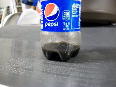

I just recently traveled from MS up to Indy area and back. 1521 miles. 22.1 mpg. Tuned w/ AFM off. Catch can working. Very satisfied with Tahoe performance. Caught this snot:
