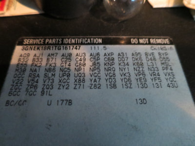

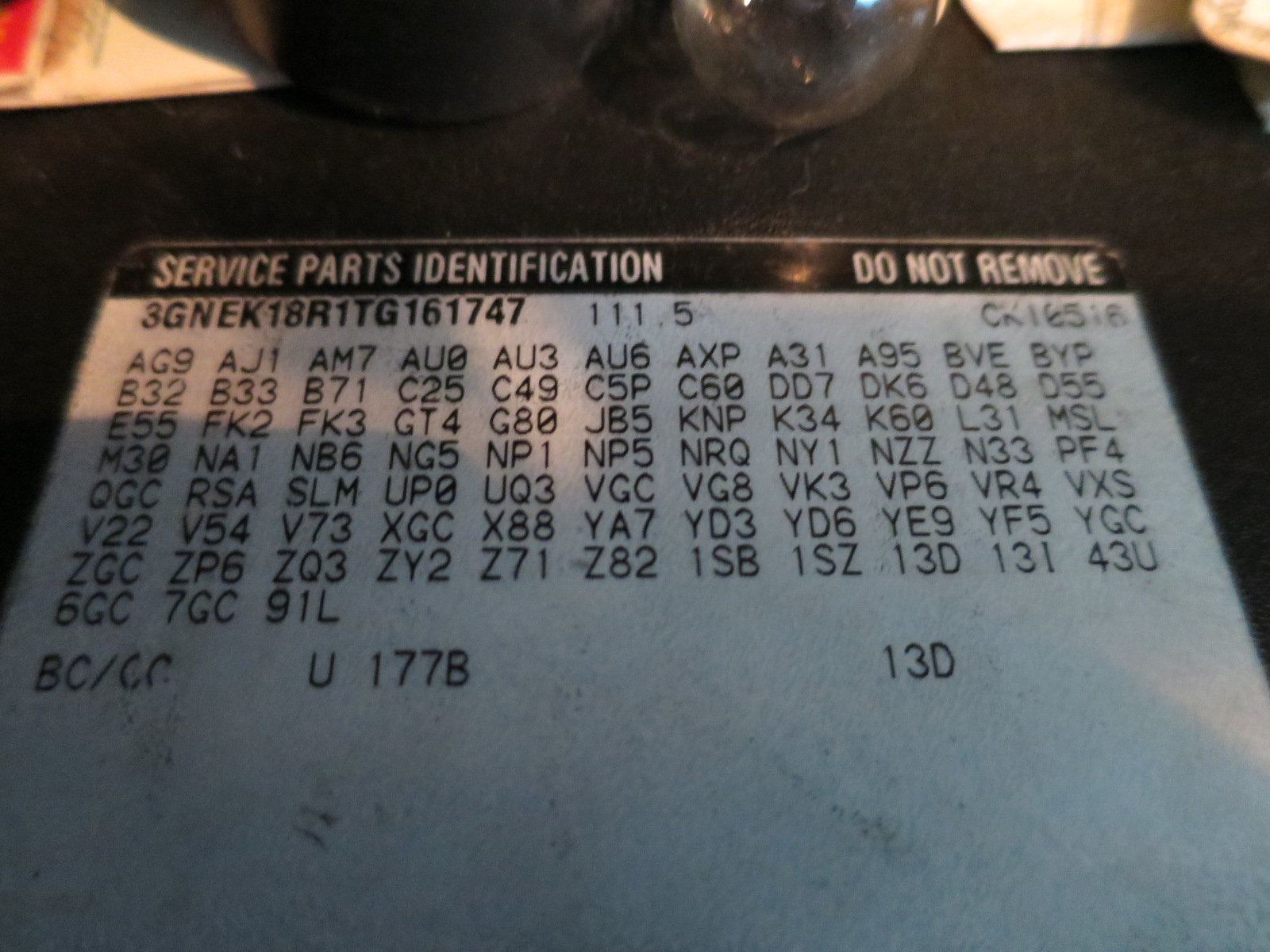

I have a GM RPO Master List that shows these 13D codes. I assume that the (96) suffix indicates the year (yours).
Your first code, AG9:
Also, some interior trim codes:
Seem right, or at least close?

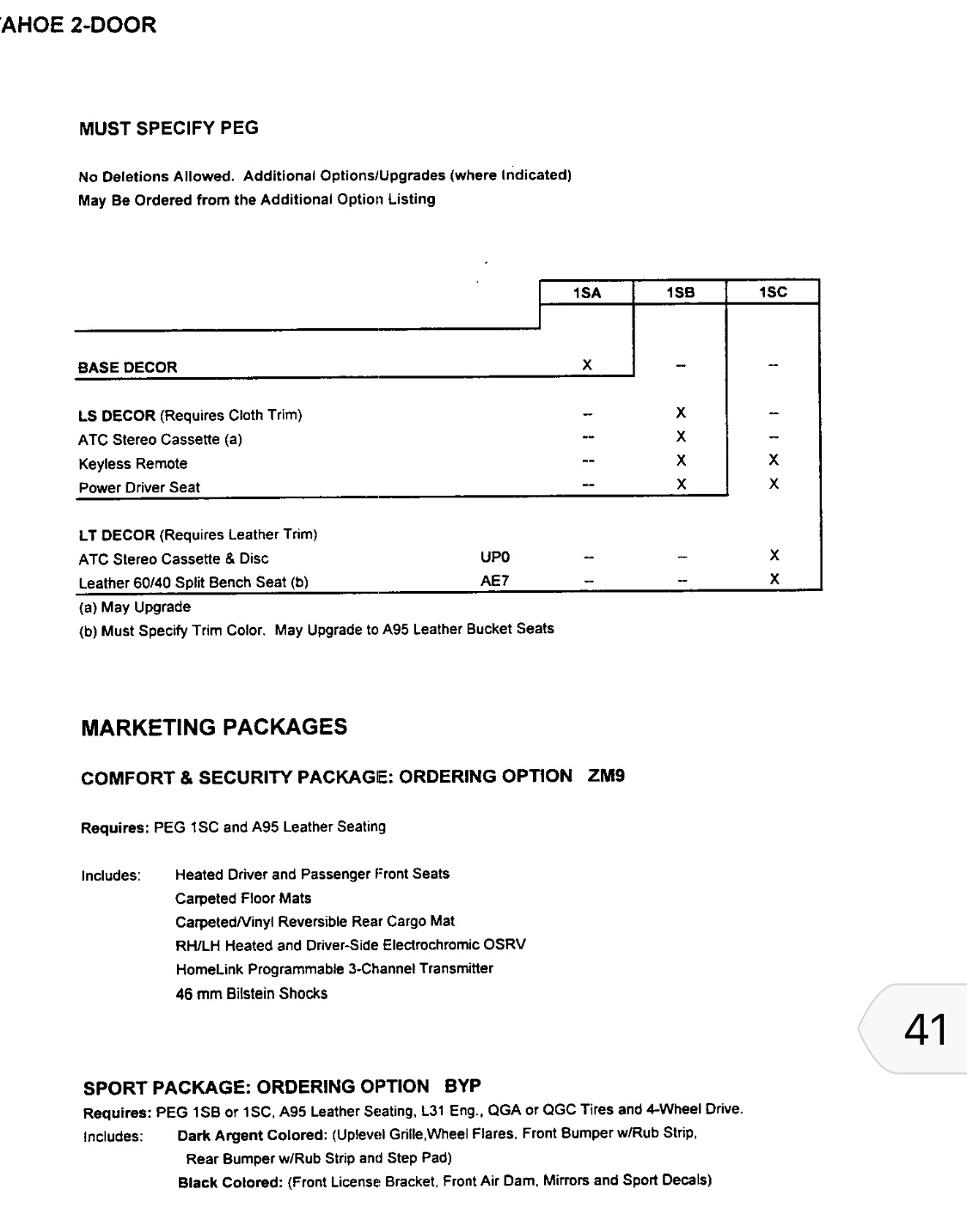

The 1SB is for LS trim, which is cloth, and the 13D is the gray cloth.
The LT would be leather (1SC) and have 132 for the leather code.
Sport package BYP just required LS or LT trim.

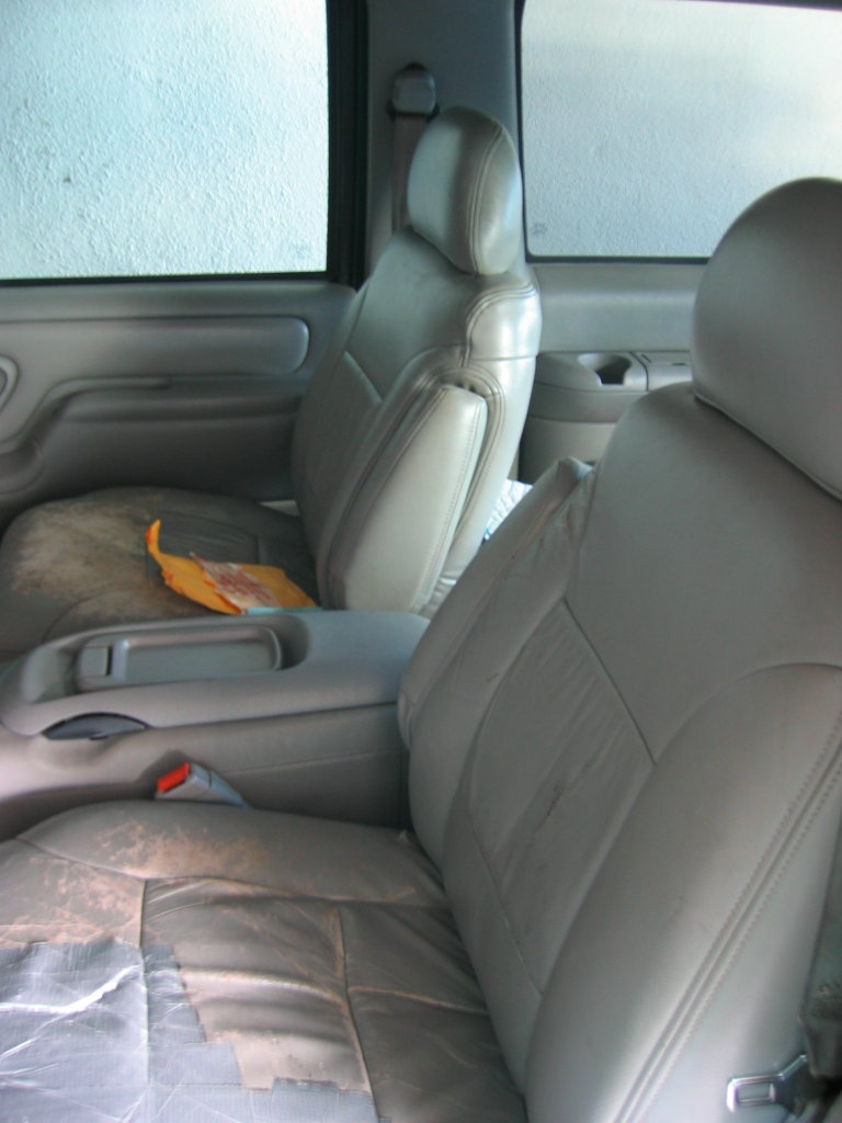

Here's why I asked. My dog has trashed my front seats

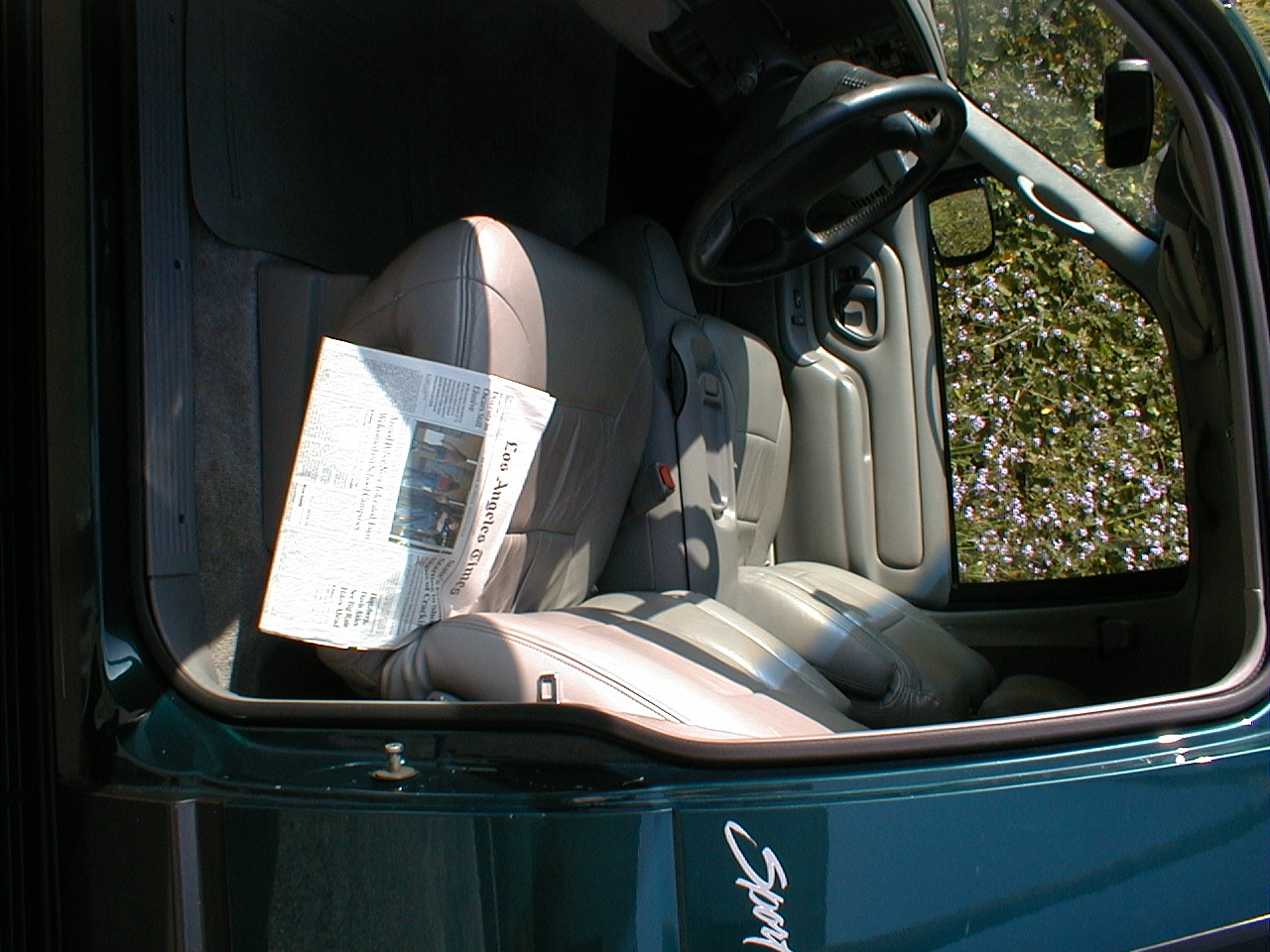

And these are the factory leather seats is my Tahoe.
Yours probably has the Velcro on the leather cover but not on the foam, which is why they are flat in your photo. There was nothing to “tuck” it into and make it stay put so as to minimize wear.
Replacements may not fit that well if they cannot attach at the Velcro seams. It may be worthwhile to pull yours up and see if you have the Velcro attached to the foam seams.
There is a thin layer of foam attached to the leather, so you’d be looking under that layer for either factory cloth or a foam cushion.

It does seem to be tucked in, or it used to be. My drivers side foam is trashed. But perhaps you're right. I could checked before I put the duck tape on. Will find out fairly soon. My focus is on the mechanical etc right now. Was thinking of buying the covers and foam now as the price seems to have dropped since I last looked. For $350 I can get both lowers and drivers foam. Upholstery shop quoted $550 for drivers seat only.
