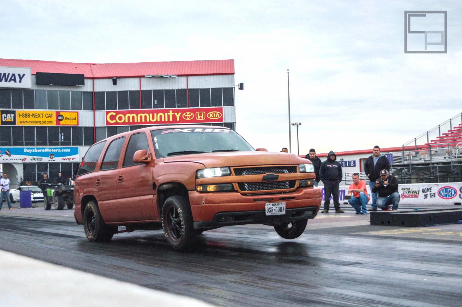

set up consist of a 5.3 l33 sbe motor nothing fancy khp stage 2 cam, circle d converter,76mm turbo on 22psi
we clock in a 10.00 60' 1.46 9s were there but iats didn't help us at all intercooler that it has on now aint cutting it
at all from 15 degrees timing 205'f iats cut timing to 11* so there goes down the power but we order a bigger core, to get her ready for Friday track night

Looks damn mean! Have any vids of a run?

He posted some a while back. It's already hot as Hades in Texas so IATs will be up. ..hell we already hit triple digits.. I'm curious about the rear end setup.. maybe an airdam will get it over that 10.0 hump..

Ok, I remember now. Totally badass. That's what I need.
