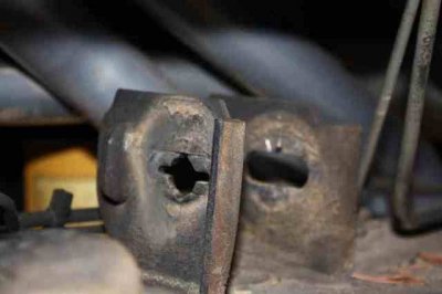

There are oval holes where your upper control bolts go through the frame. GM doesn't cut them out completely when they assemble the vehicles and these is how they're aligned from factory. You'll need to remove the upper control arm bolts and pull them out of the way and use the tool below to remove the "knock out" section. The package for the tool has a picture that shows you how to use the tool.

Hole on the left is before the knock out is removed. Hole on the right is after.
