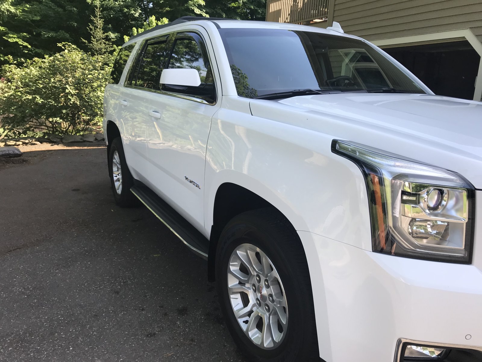

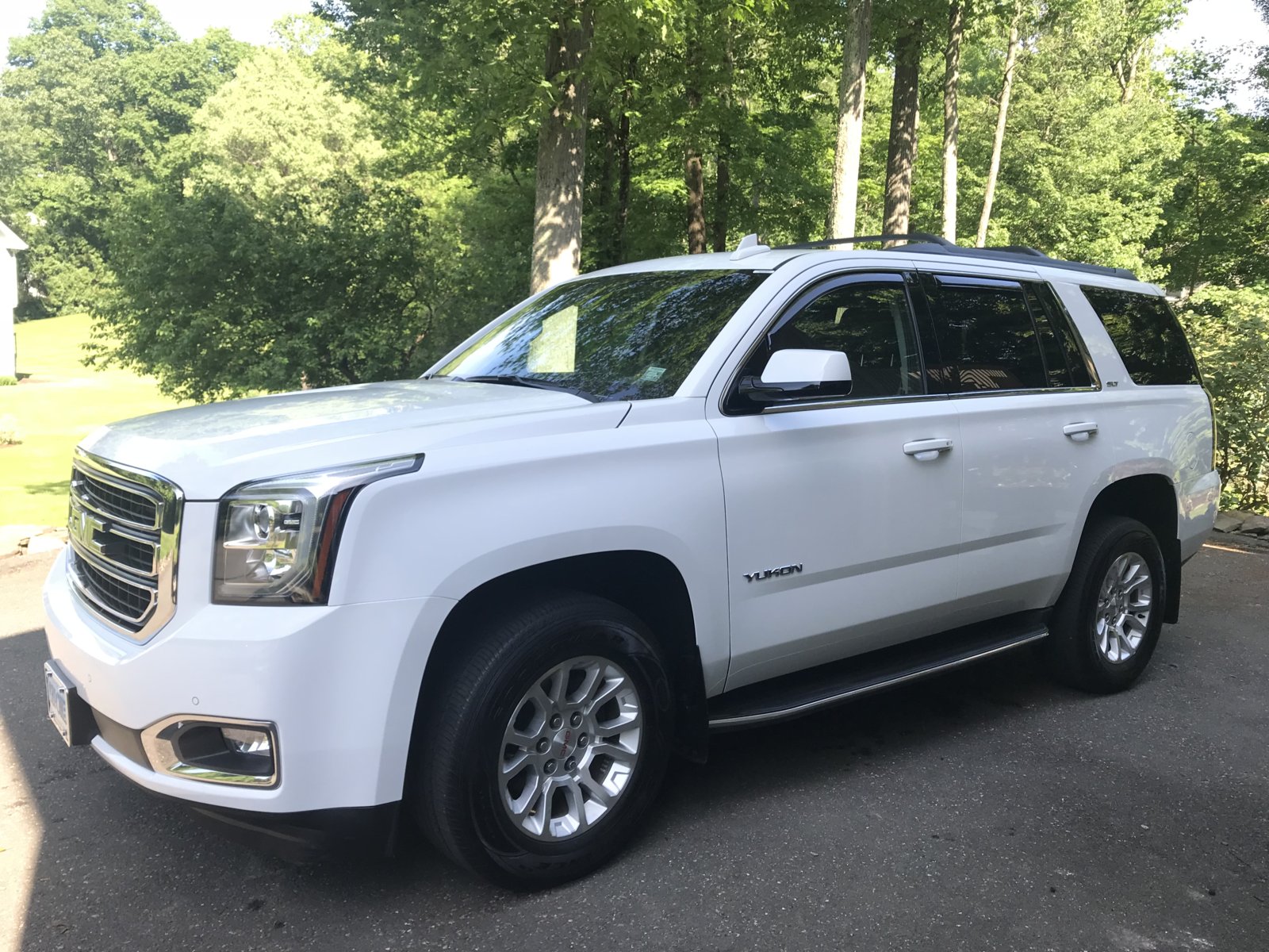

Ok, so I am dad's only daughter that took after both him and mom in the DIY'er stuff. For my birthday this year, he bought me a new random orbital and I got to try it out today for the first time. So much nicer than the cheap 20 year old monster I had! Bought a 5" BP and went to town...
This is Mequire's Gold wash, followed by a Griot's clay mitt treatment (first time using instead of a clay bar - 2 thumbs up! A previous driver had scraped up the rear a bit so i used Griot's Correcting cream on parts but mainly used their Polishing Cream. And finalized everything with Griot's Poly Wax.
Wheels and tires were cleaned with Chemical Guys stuff and the tires have a Griot's tire treatment on them.

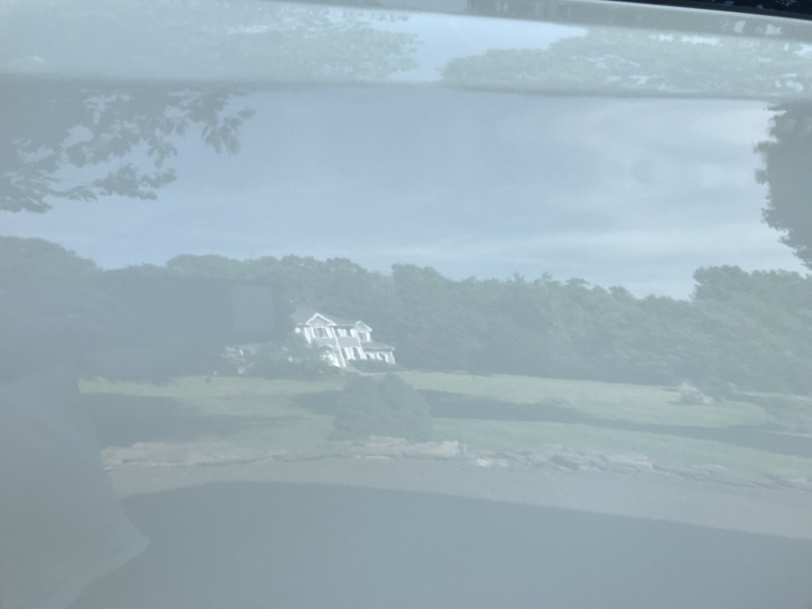

That is my neighbor's house reflected.... :)
Next I get to try out my new machine on hubby's black '05 Audi A6 and two of the kids vehicles, but mine came first!

Excellent work! This right here is why I became a professional detailer. I was sick of the stupid car wash doing crap jobs on my vehicles so I learned to do it myself! It’s amazing what a random orbital machine can do! It’s my go to machine for so many things when I’m working on a clients vehicle. And my porter cable is the best random orbital by far! Haha.

Good job learning how to detail and it shows in the hard work you did on your Yukon. Sounds like you used some really good products as well. Your husband is lucky to have you detail his ride.

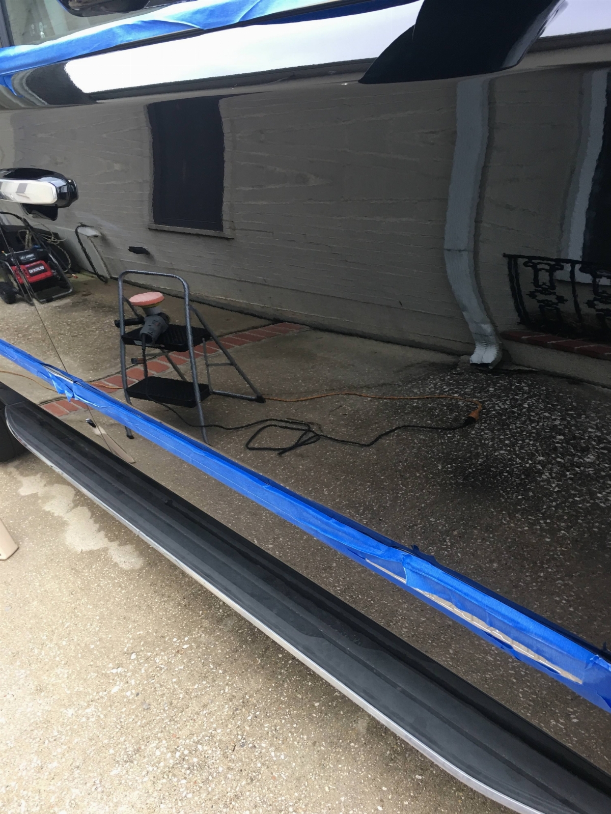

I've had a porter cable I've been using since college (06). But when I bought my first esky, it was cheaper for me to pay a friend 150 bucks once a year to do paint correction etc, now his prices have gone way up and would cost me over 1k to get my new esky done, I decided to do it myself again. Still using the same old stuff (meguair's 105 and 205 topped off with some Jetseal from Chemical guys) b/c it worked then and I trust it to work still today.
here it is after the first stage of cutting.

Wow, like glass.

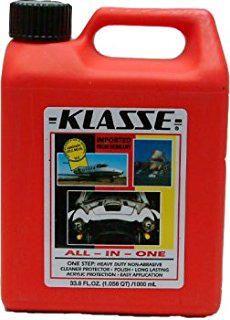

For windows I like to take a water bottle with a few drops of klasse aio, shake it up, spray them down and buff them out with a microfiber. Keeps them clean for a long time!

Looks good!!
Curious...what speed do you run the PC when applying the 105 given it's such a new truck? I'm surprised you started with the 105 on a newer esky...was it really that bad? I'm planning to do my vehicles but thought I'd start with 205, Jetseal, then CG ButterWax or NXT2.0.

I bought it used, and it's obviously been through an automatic car wash before. So I went with 105 on setting 5. Even with that I couldn't get 100% of the swirls on the hatch and rear quarter panel out. But it looks a lot better. I need to re-do it soon as I took two road trips this month, and used an auto car wash when I reached my destinations due to bugs on the front bumper.

Sounds like you'll need something stronger than a PC to get them all out, or just a ton more slow passes with a more aggressive pad. On the pc either clean the pad after each pass or have several on hand so that you're using clean pads. The dual action won't cut very well on a dirty pad.
