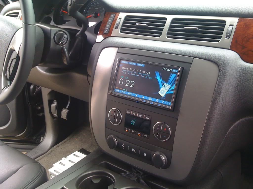

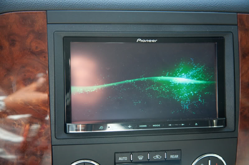

I think I have the American Intl. dash kit, but whichever it is it is the two piece design that looks alot better than the normal one piece bulky one.
Lastly get yourself a parking brake bypass of ebay for video in motion, or just make one yourself. Thats it.:Handshake:
---------- Post added at 12:39 PM ---------- Previous post was at 12:34 PM ----------
BTW my dash kit looks just like this one Dmerk has
Instead of this one that XJay has
[/QUOTE]
I asked the original poster of the pic where he got it from and he never told me so I hunted it down, ran $20 on some dash kit website.

So you don't know what model dash kit is the first photo? Is the first photo of you HU? I looks clean and I would like to get that kit.

answering on 2 thread at the same time :). I think I will just keep it on here for now. I went through your thread and am in the process of getting the OS-4, and also the pwi (steering control). Still at a loss as to which dash kit to get. I tried looking up the American International kit and don't see the one in the picture. Could you post up some pics of your setup if you get a chance? I want to have a nice flush look to my install, make it OEM as much as possible. Thanks.

The first picture is what I am looking for in a kit. Not sure which it is though. Tried looking up the American Intl one, but the picture doesn't look like that.
SmallXL
May 20, 2010
104
the bottom pic looks terrible with it sticking out like that. Do yourself a favor, if the RCA's or harness is hitting the back - just cut it out. IMO don't mount the deck any but flush.
