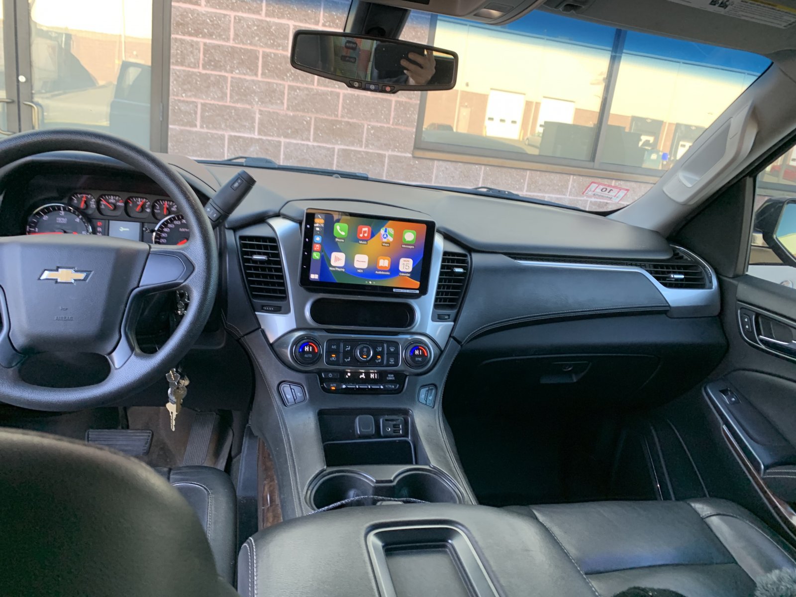

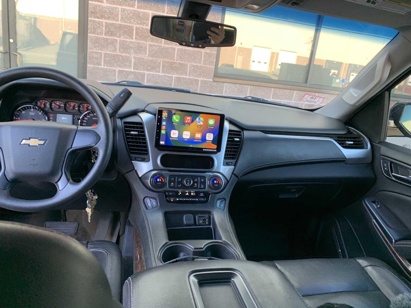

Hey all,
I just up-fitted a few things in the new PPV and wanted to share.
I changed out the stereo which I thought was going to be a nightmare and it was a lot easier than I thought the videos online made it out to be.
I used the a single wire harness and an antenna adapter.
The harness is super easy if your changing the basic i03 stereo. The harness covers all but the USB’s in the center console that originally were wired to the pup center console when I first got it. According to all the videos, the usb are not an option anywhere.
The kit I used is below.
Harness - PAC RP5 -GM51 Best Buy sku# 7151124 $170. The back up camera works great as it’s all connected to the harness. No extra cutting. DO. OT USE THE ONE THAT IS LISTED IN Best Buy fit guide. It will not work. Only the one above with the i03 radio.
Stereo - Pioneer DMH-WT3800NX Sku# 65320257
Dash kit - Metra 99-3015G for $30. Sku # 9616706. It has a stupid oval cutout for a coin to replace some controls, but you can do without and get a scotch model for $100. Model GM5214SB. I just didn’t have the time to wait as I already bought and ordered this one.
Antenna Adapter - 40-EU55 Best Buy sku# 9436853
The usb connections on the center console are not functional and neither is the heated seats. I am currently trying to get the heated seats resolved.
Thanks and don’t hesitate to like the new look!
