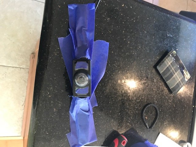

1. installed the camera on the license plate. Pretty straight forward. Only thing i did was sprayed the camera with plastidip in order to water seal it. Some amazon reviews mentioned that this camera is not water proof.

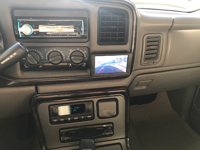

4. On 01-02 Yukons there is no blank pocket that the 03+ have and many owners fit a 3.5inch monitor in to this space.

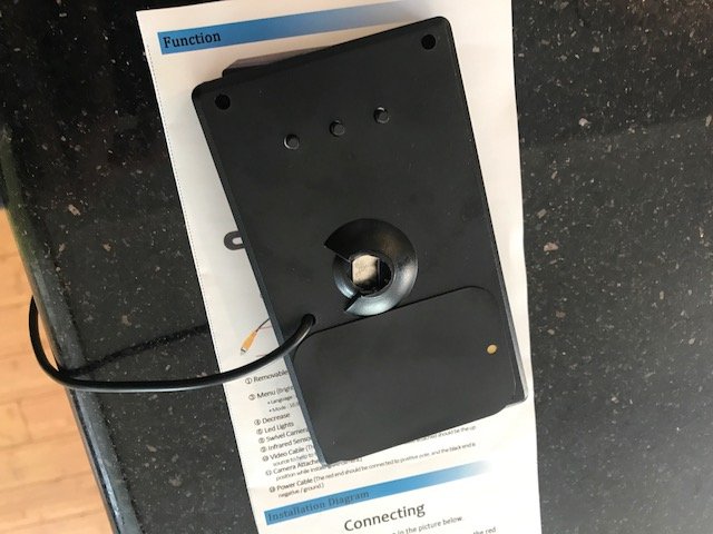

5. I didn't want to spring for the new dash and also wanted the larger 4.3inch monitor. I also wanted the ability to remove the monitor if need be and to have access to the buttons on the back of the monitor case.

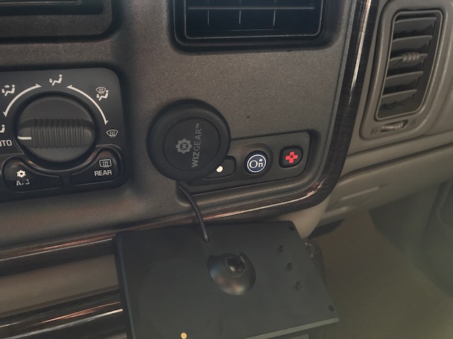

5. I have these magnetic phone holder magnets in all my cars and love them for ease of use. My idea was to just attach the same metal strip on the back of the monitor with a low profile magnet attached to the dash.

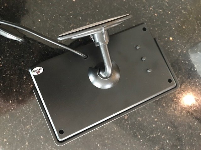

6. I broke off the monitor stand and glued the metal strip on to the back of the monitor.
Result is sort of killing two birds with one stone. Great spot for the monitor and it covers up the onstar buttons which do not work anyway due to the aftermarket deck. Looks great too :)
