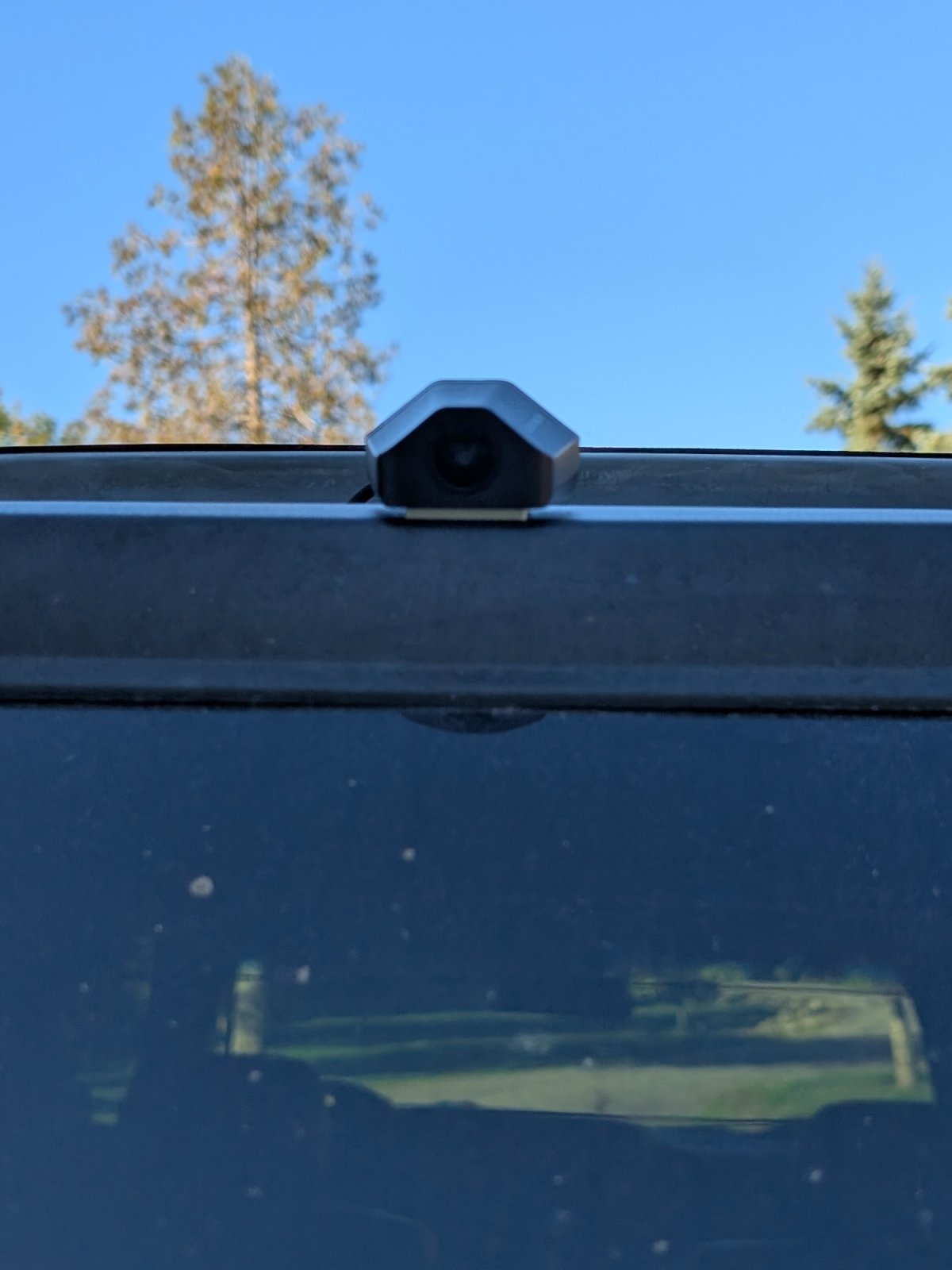

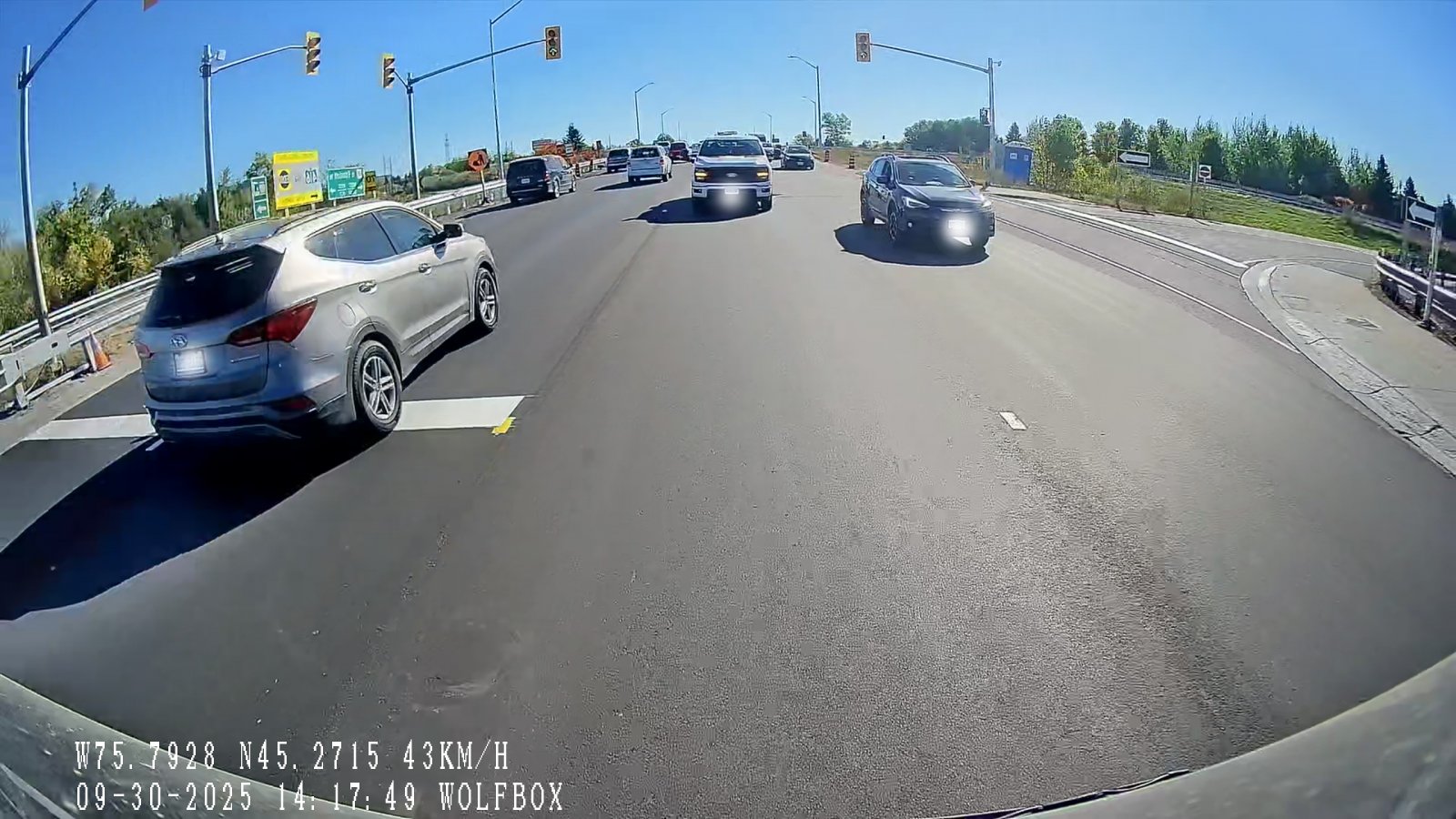

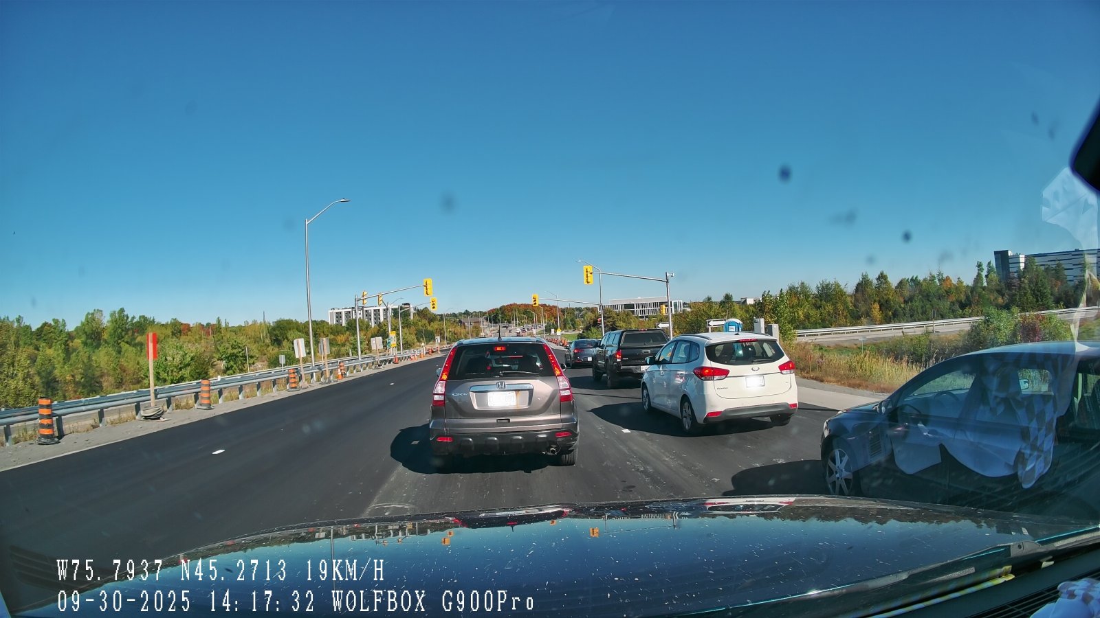

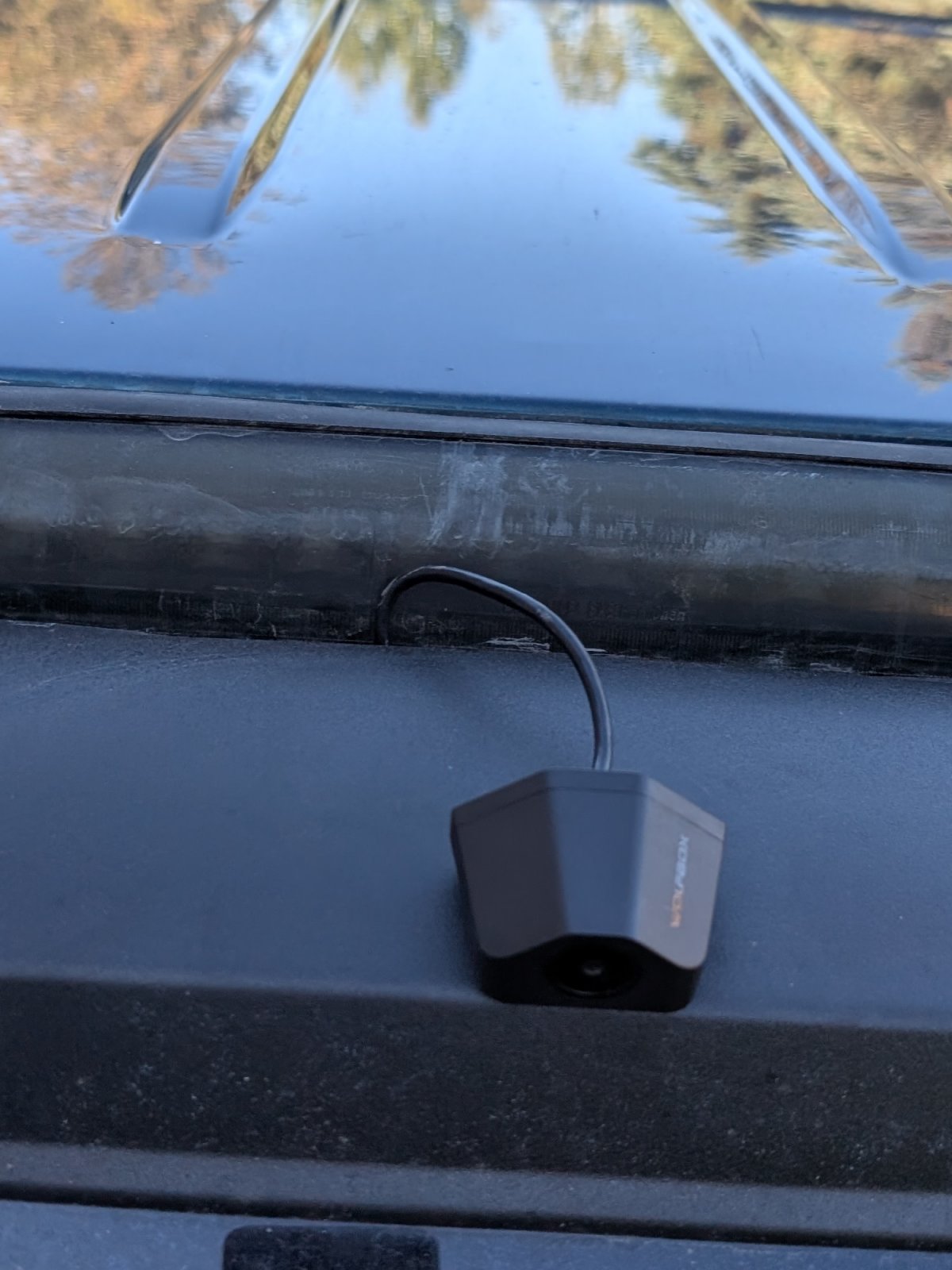

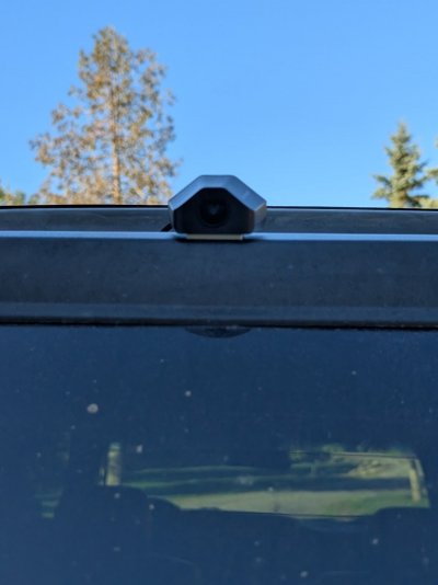

I mounted it there for now.
I can't see the ball... But can see the trailer well enough to hit it every time.
May look to relocate when the Wright Engineering version that is built into the window button on the rear.
I will put up some pics. Very smooth installation.

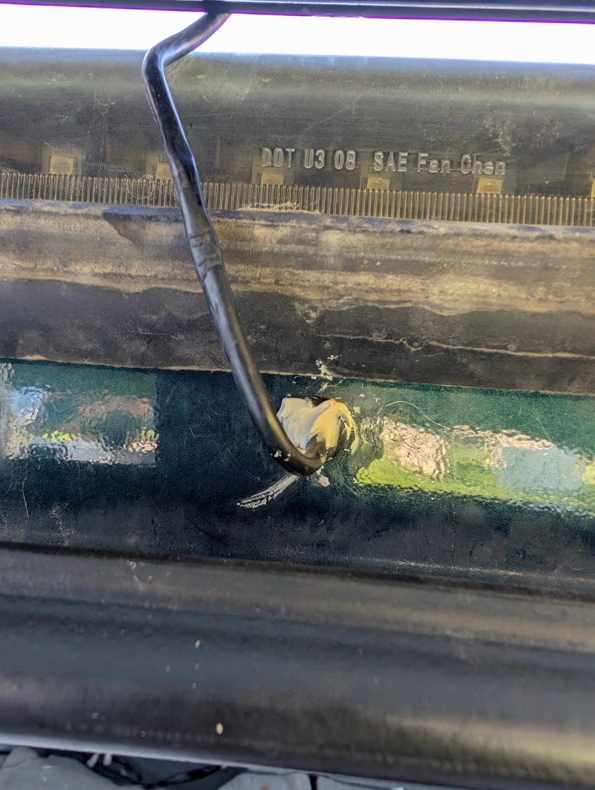

Used the Seo plug in the MBEC for power and routed it all above the head liner with a fishstick.
Drilled a small hole to get the wire out and used a grommet and some caulking to seal the pass thru (sadly only had almond silicone).
