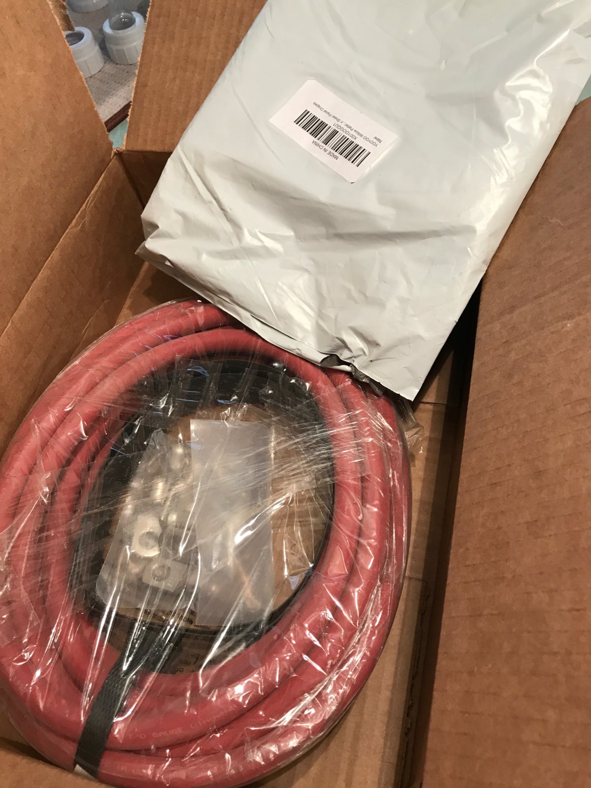

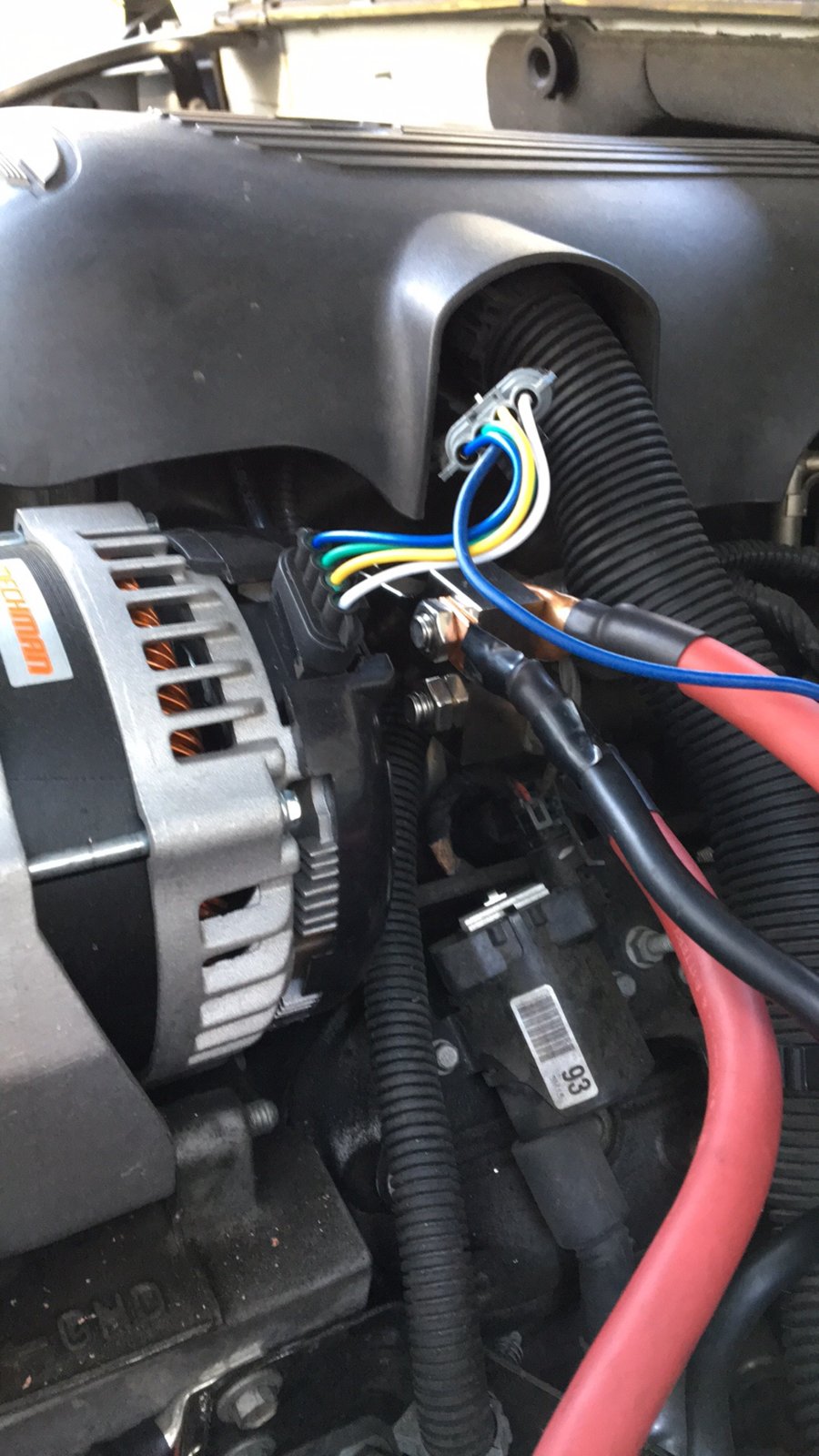

I started my build the correct way and started worrying about my electrical. I started with my mechman elite 250, big 3, then went full stupid and bought a limitless lithium battery. I wanted to custom mount the battery hidden out of sight. I noticed this little pocket did some measuring and made it fit.

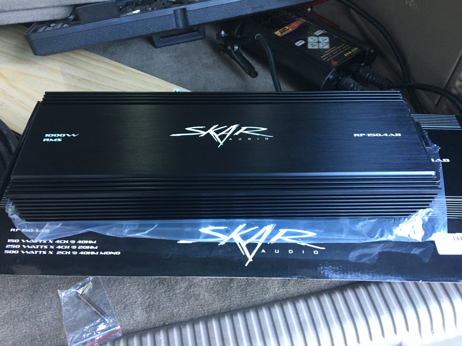

As you can see I made sure all my power and grounds were the same length and flowed together. I have 2 powers and 2 grounds for my bass amp. And 1 power and ground for my mids amp. I used all 1/0 for both amps. For the bass amp I had to use dual inputs and the mids amp I used 1/0 to 4awg reducers to keep the power flowing good.

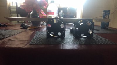

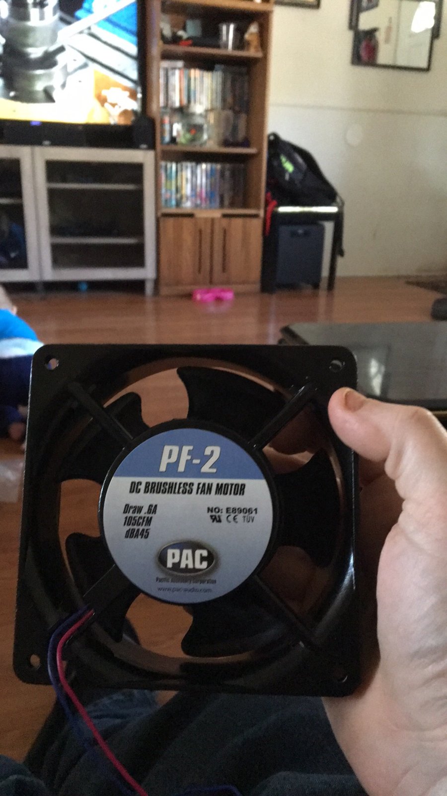

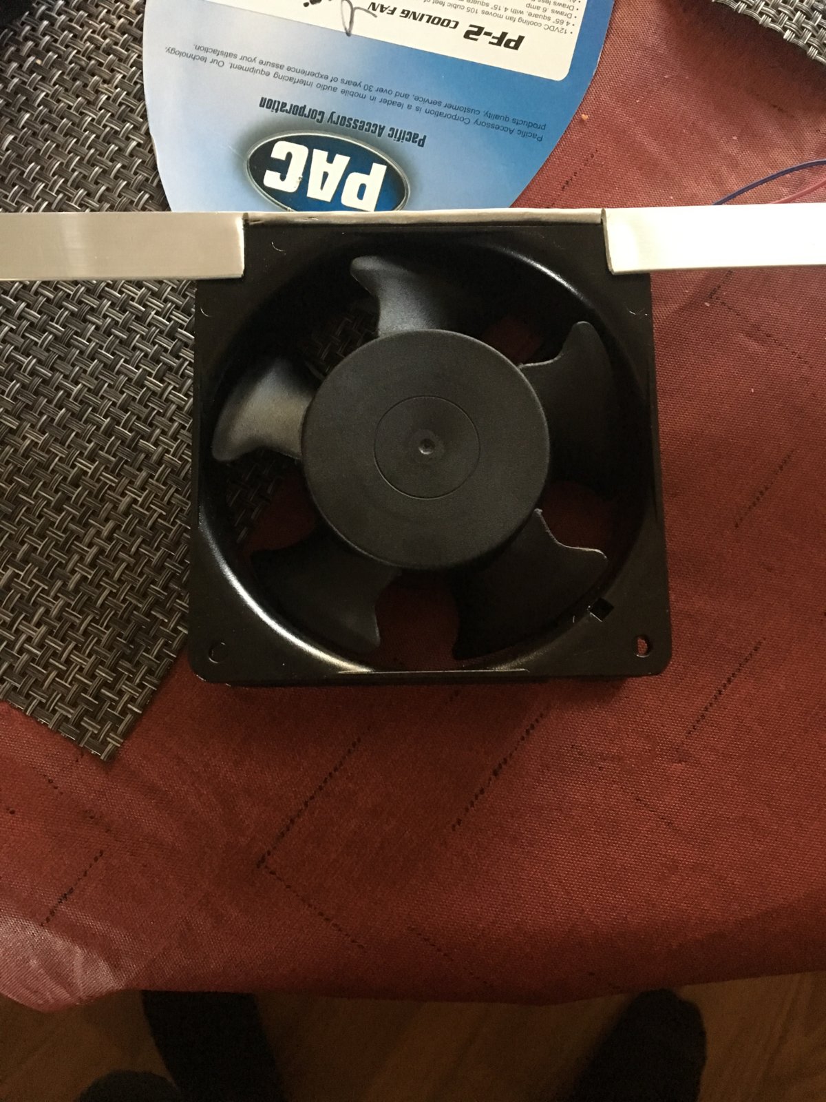

I was having some cooking issues so I thought on a previous amp so I mounted some small pac fans on the seat and it flows pretty good.

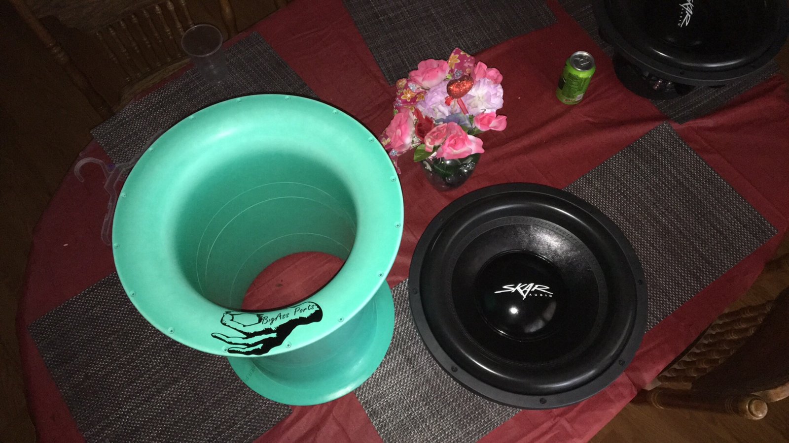

Next came my subwoofer box. I paid bassahaulic from Facebook to build me a design. I did this as I can fabricate and install. But I have never been into figuring out boxes. Once I got my design I picked up my wood. It’s all 3/4” birch all doubled up. I spent a crap ton on it but I wanted it right. As you can see by the pics I made sure to match up the wood grain so it wraps around the whole box. I used a 10” aeroport from bigassports. The hole for the port was the same size as the subs lol.

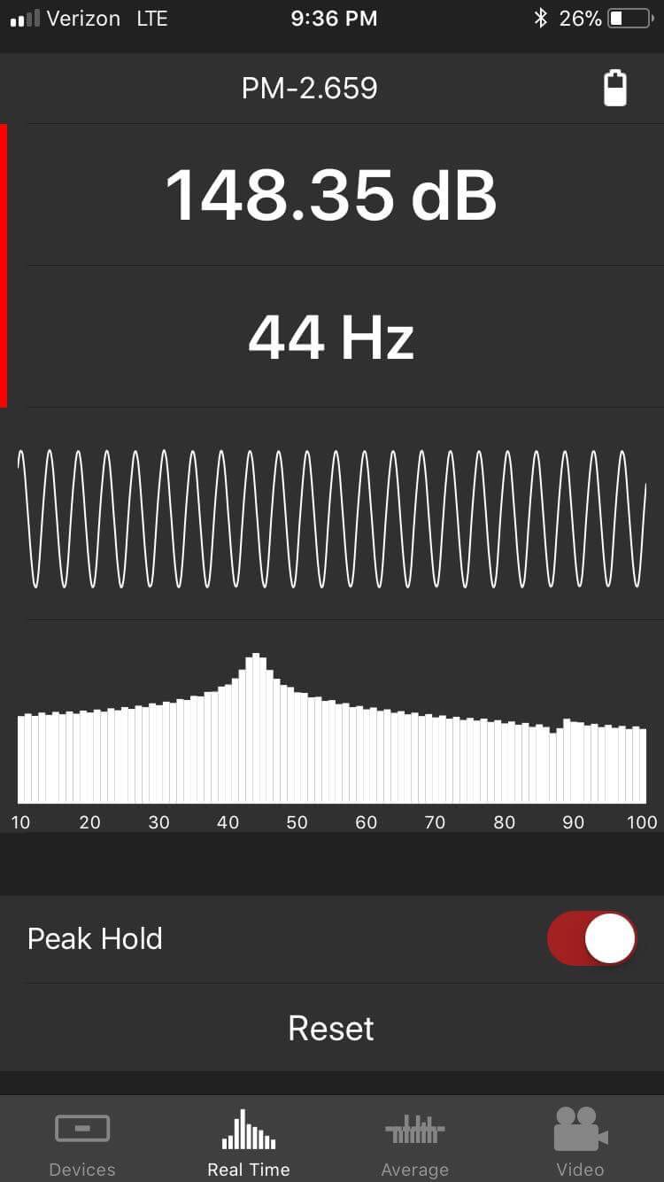

As y’all can see I spent a lot of time putting together a decent system. I was very **** about how things looked and fit. I wanted everything to be hidden as if I just have the sub box in the back and that’s it. On a lower powered amp I hit a 148.35 sealed on the dash and higher with the drivers door open. My goal is to get a 150 out of this setup. I’m going to try and do some competing. And to be honest with everyone this is my first system in years. Probably since I was in high school and I’m 32 now lol. If you have any questions or suggestions please reply.
