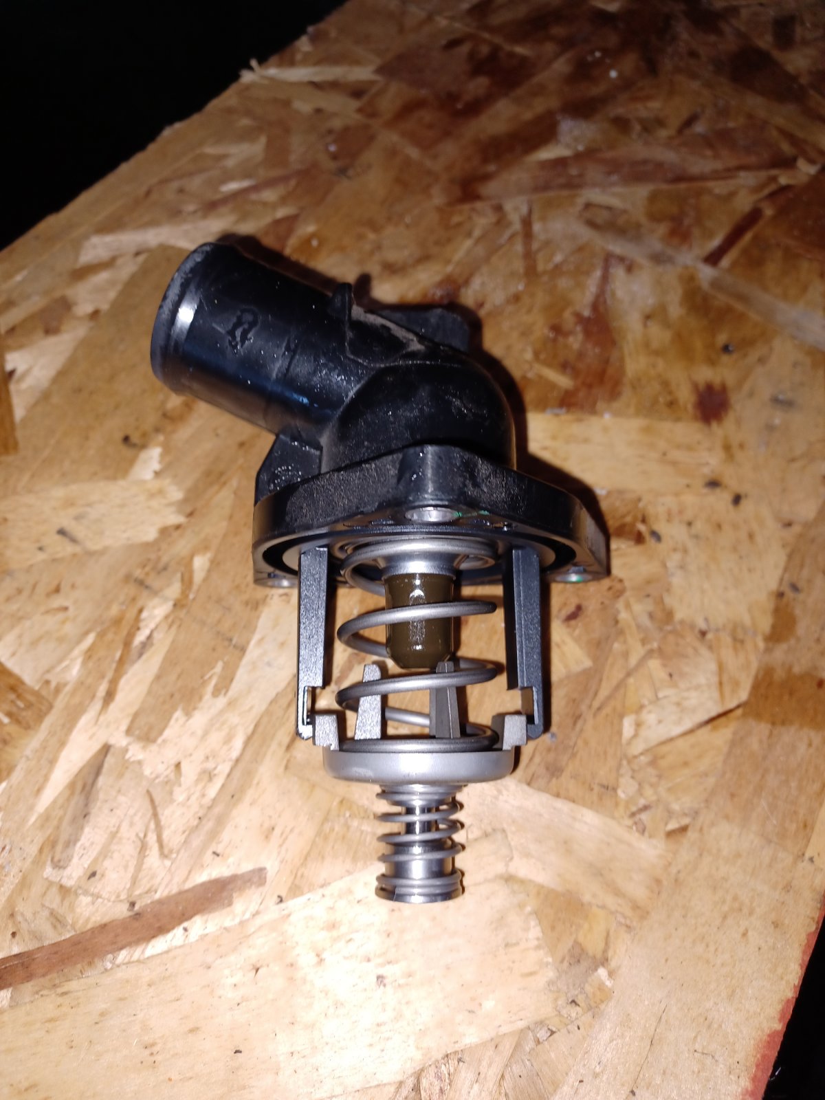

My 2017 started hanging around 175 for about 2 months. After a previous post I read, I replaced the thermostat and Viola! I had 210F again. The new thermostat appears to be a 2 stage opening. I found that on the original one, the smaller spring portion wasn't closing all the way. Super easy job. You'll need 2 gallons to replace what comes out. Way nicer to replace than the previous generation.
Torque on install is 12ft-lbs or 144 in/lbs depending on what size torque wrench you use. Might want to Google it just to double check, they are small bolts. Has a really nice o-ring gasket, just clean up the mounting surface if there is residue from the original.

Agree on Thermostat replacement. Seems on the chevys the temp sensor and thermostat always go right behind eachother. Thermostat fixed a silverado with same issue after a temp sensor replacement

Changing the thermostat work for me. I was having the exact same issue as you. Just make sure your replacement thermostat isn't one of those ones that are designed to open at a lower temperature.
Here is a video I made of me replacing my thermostat:

Fantastic video, Sir! Ill be doing this today after work. Thank you!
