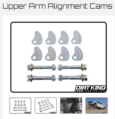

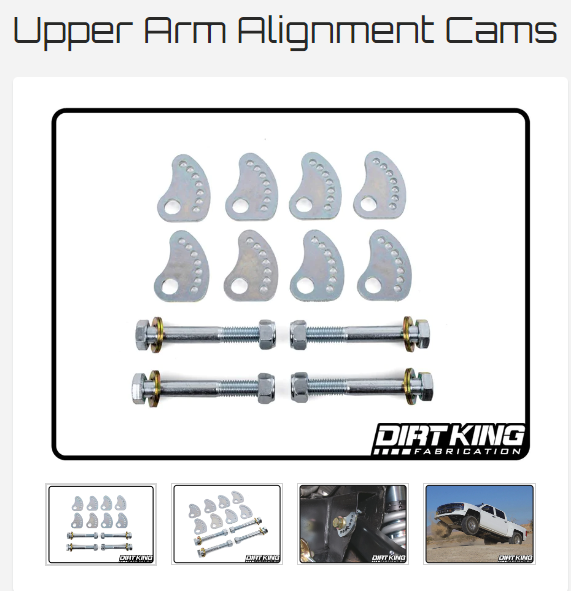

I had the same issue. This product from Dirt King helped me out alot.

What do they do compared to the factory ones?
I think I am running out of space in the frame slot and it needs to be ground longer as @iamdub mentioned somewhere in here. I am hoping to get a set of drop spindles so I can flip the struts back on top of the LCA's and hopefully get some better factory adjustments before I go grinding away pieces of frame.

How much lift do you have?

They lock the position in place. So even when torqued to 140 ft lbs, they can still move over a heavy bump or jumping train tracks and such. With these, it will take many more times of force to get them to move, by breaking the pin.
Harder to set the alignment but once set, it stays.

Oh I understand that part of it. I thought the poster was referring they would help with providing a larger range of adjustment.
