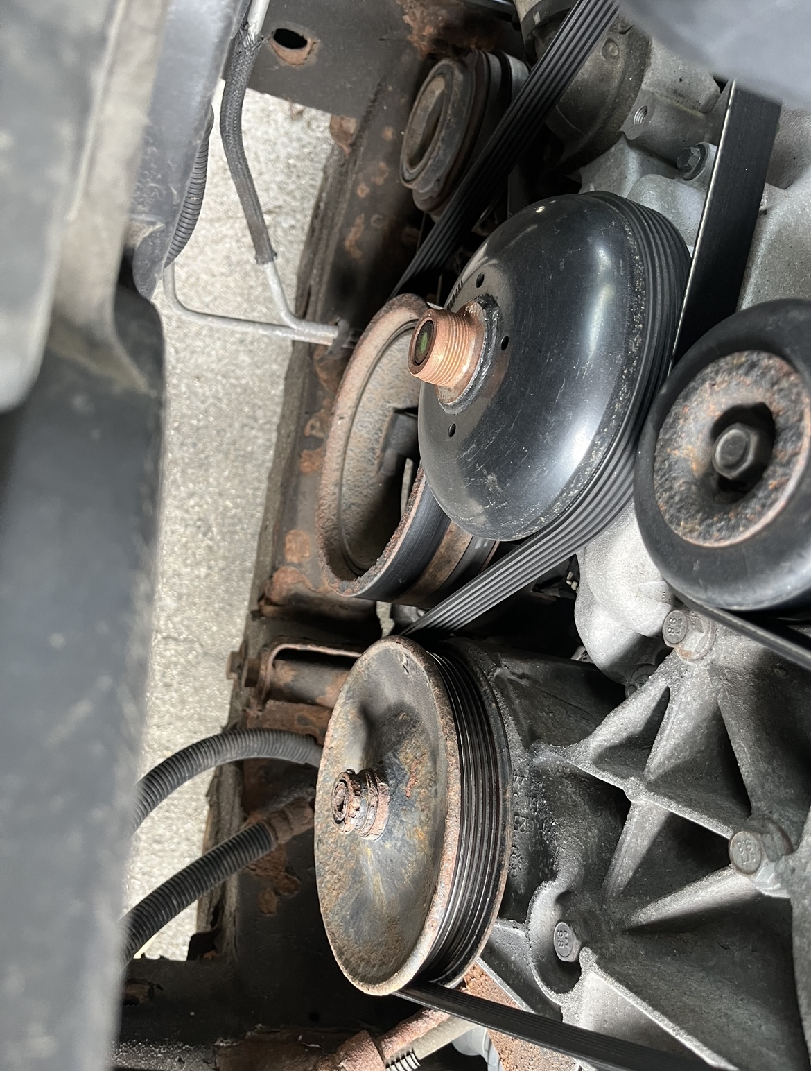

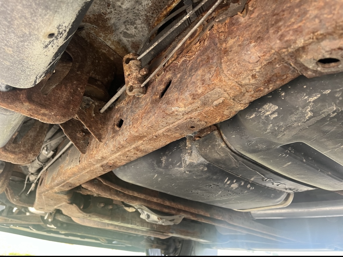

Is this frame too late to save ?
Five3brian
Jun 15, 2024
First time poster, I have a 2009 yukon SLT 5.3
I really want to build this truck and put money into it, but the only thing stopping me is this damn rust. I live in Michigan and got this a few months ago.
It could be worse, but is this worth saving at all?

I'd start by poking around everywhere on the frame with a screw driver and see if you can find any soft spots. If there's no soft spots I'd clean it up with a wire wheel the best you can and either por 15 or even rustoleum rust converter as much as you can. Also pickup a bunch of fluid film and spray it inside all the holes in the frame and also anywhere you can't apply the rust converter.

Maybe worst part might be the body mount areas in the floor pan. Those areas are shaped so they trap water/salt and you can't actually see the damage until it's really a mess. See the same thing you're looking at here in Ohio. Clean/paint that frame as much as possible, then I start shooting used motor oil in all the holes and cracks inside the boxed parts. Park in gravel or put cardboard under it for a few days. You can stop any future damage.

If you can find a spec on what the thickness of the frame is, you can try hitting a spot with a flap disc and check the thickness with some dial calipers. That will tell you how much section loss has occurred.
I don't have to deal with road salt on vehicles here, but this is what I do when assessing corrosion on steel structures (mostly buildings.)

Will definitely try that, i appreciate it. So far i’ve took a spray bottle and squirted transmission fluid inside the door plugs and in the fenders a bit, so hopefully that’ll help slow body rust down too.

That frame isn't so bad. I have repaired and continued to drive way worse.
Cleanup all the areas you can get to with a scraper or wire brush, Pick the hottest, most humid day you can and soak it with Krud-Kutter and rinse it off after about 10 minutes. let that dry a day or so and them spray the entire underbody with Fluid-Film. that should do it.

Geez....that looks rough. I see nothing but a long list of repairs, replacements, cuss words, and disappointment with it. I'd just drive it like it is and save up some money. Then, schedule a vacation to a southern or western location to find a clean replacement that you can start with a clean slate from.

^this that stuff adds up probably trans lines too
Yeah that was my concern smh, i’ll probably just save for a ‘15 6.2 yukon/escalade or ‘14 srt cherokee

I'd try to save it. I really like saltsgone for a good cleaning. Then some Ospho or naval jelly, literally paint it everywhere, try to get in the cracks/holes, then saltsgone again (+ this is fantastic). Let dry for a full day or more. Then I'd POR15/Eastman frame paint it, the latter sells a long tube 6 way nozzle to get inside the frame rails. Let dry for several hours, then fluid film everything. It goes to say, take off as many heat shields and plastic dust shields before you do this.
