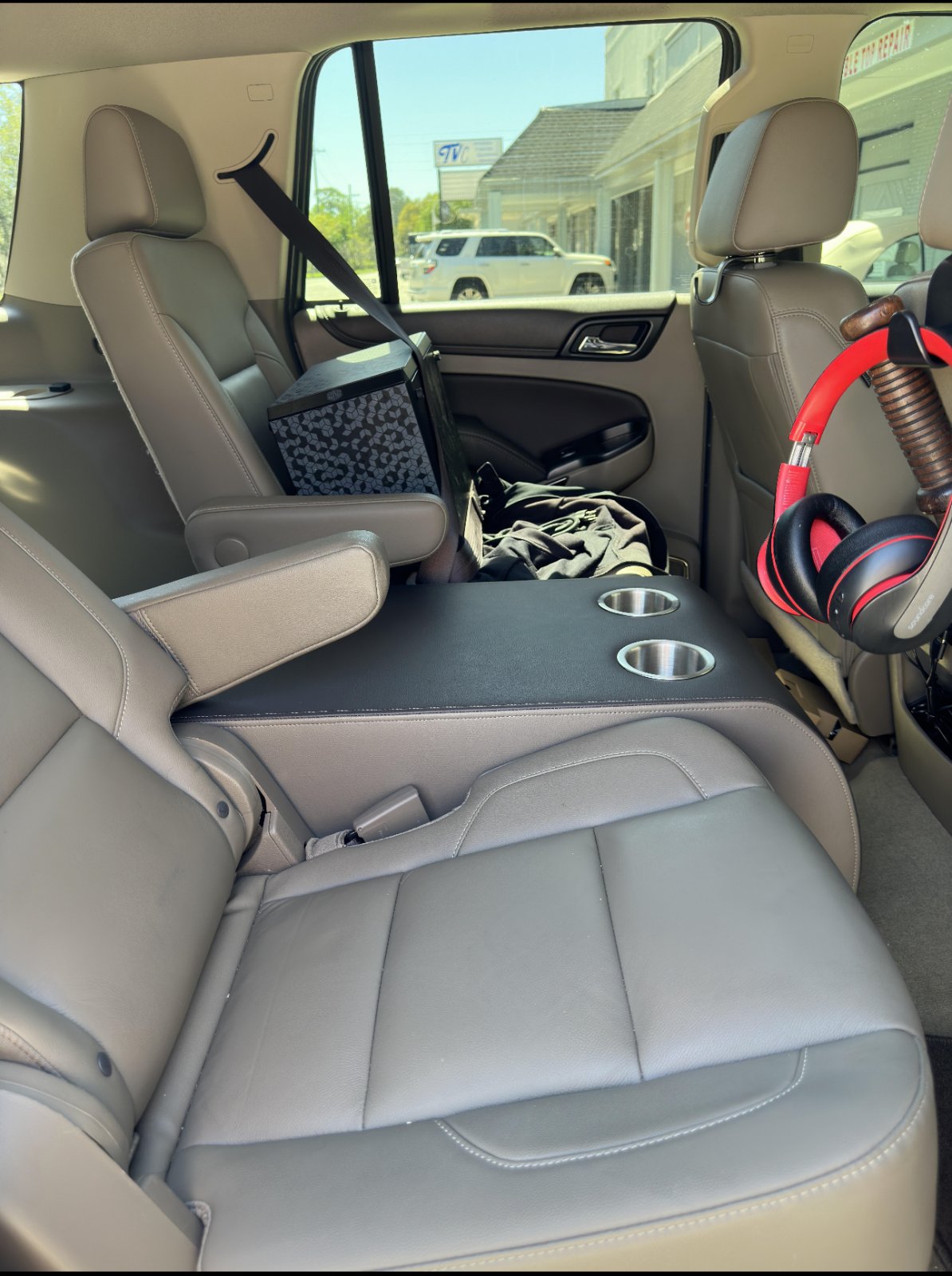

I made this for my Tahoe. Ended up not being happy with the sound so I am now working on building another one. The only issue you will have is that the armrests have to come off to fold the seat down and would be easier to leave them off, but that causes no inside armrests. You could build the box taller so it can be used as the armrest, which is what I am doing with my second design, but then it will be higher when than the seats when folded. Today or tomorrow I will be taking the armrests off and will fold the seat to give you a better idea of what I am talking about.

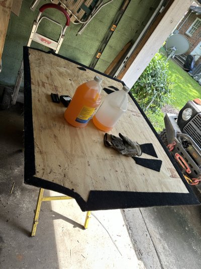

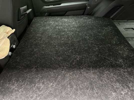

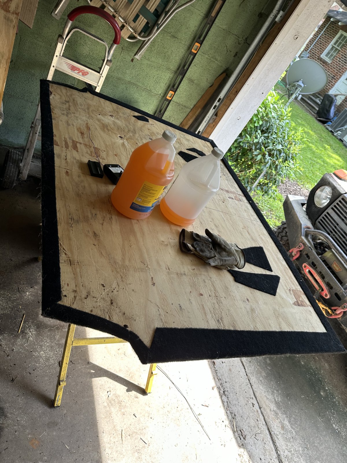

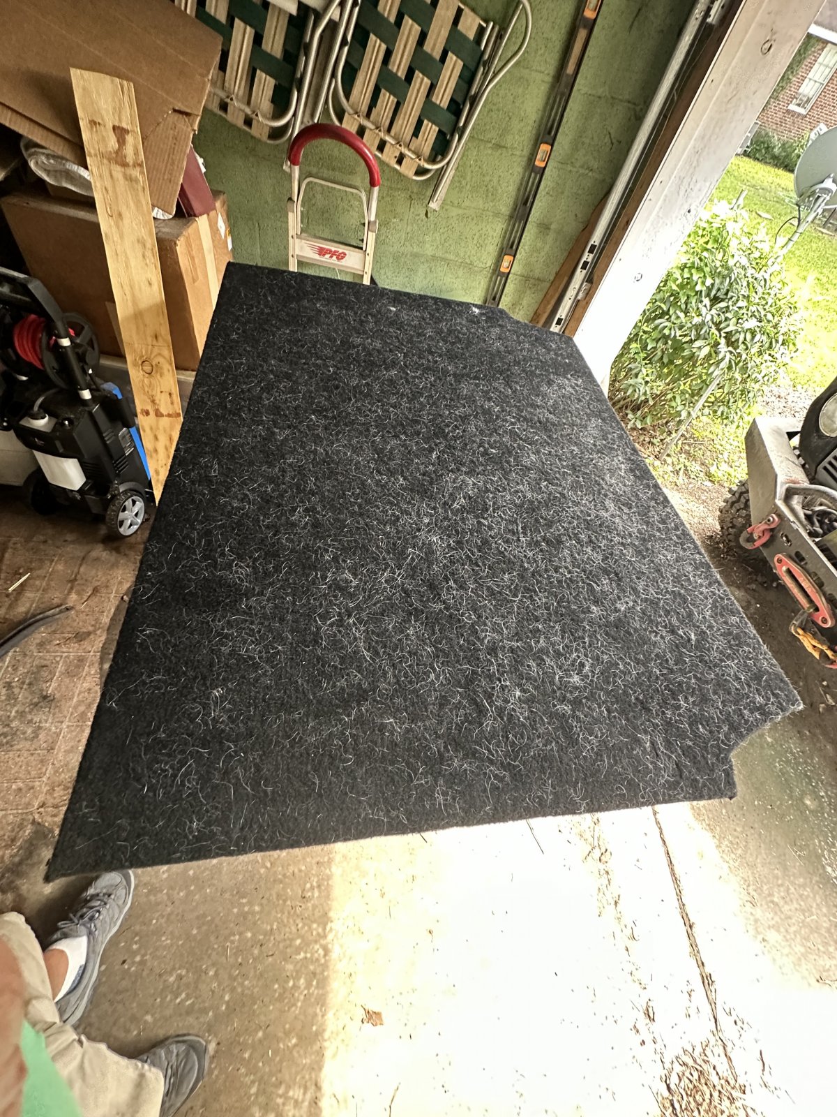

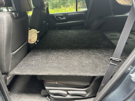

I made a pattern out of cardboard and then used a piece of 3/8" plywood, cheap black carpet from Amazon and 3m spray adhesive. Easy in and out. The dogs have full use of the back and if I go camping the sleeping bag fits. I do need to make a couple of legs for the front corners to make better.

This looks promising! I'd love to see a picture or two of it in your truck....
