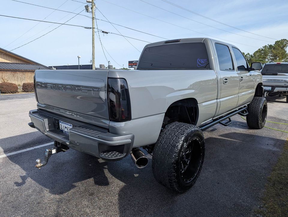

Trey Hardy
8” fabtech icon coilovers uniballs 24x14on35/15.50
Jun 12, 2020
3,488
9,428
Eastern North Carolina
Here’s a 06 with a Silverado rear bumper and I’ve seen one with the newer 2019 style bumpers too I believe they bolt right up
