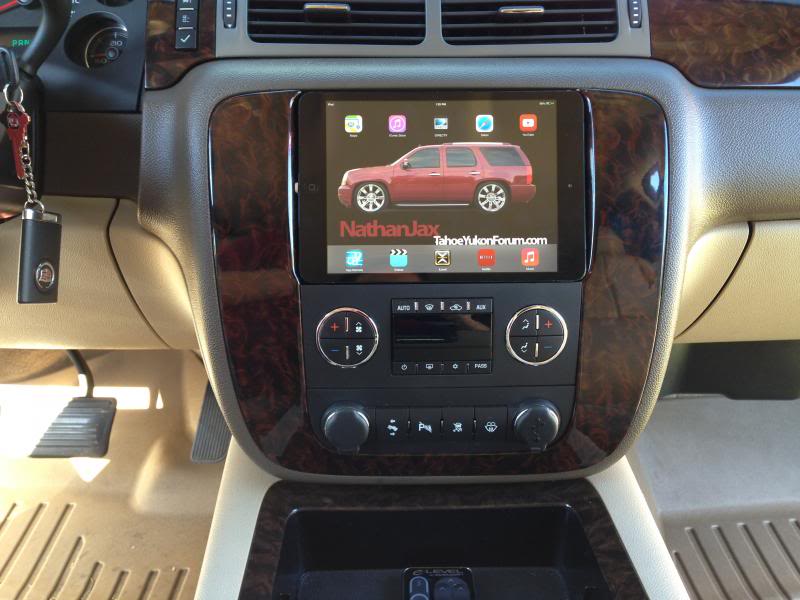

I did it with my old Yukon
13_zps29033a17-jpg.151737
https://www.tahoeyukonforum.com/threads/added-an-ipad-mini-to-my-dash.57790/

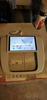

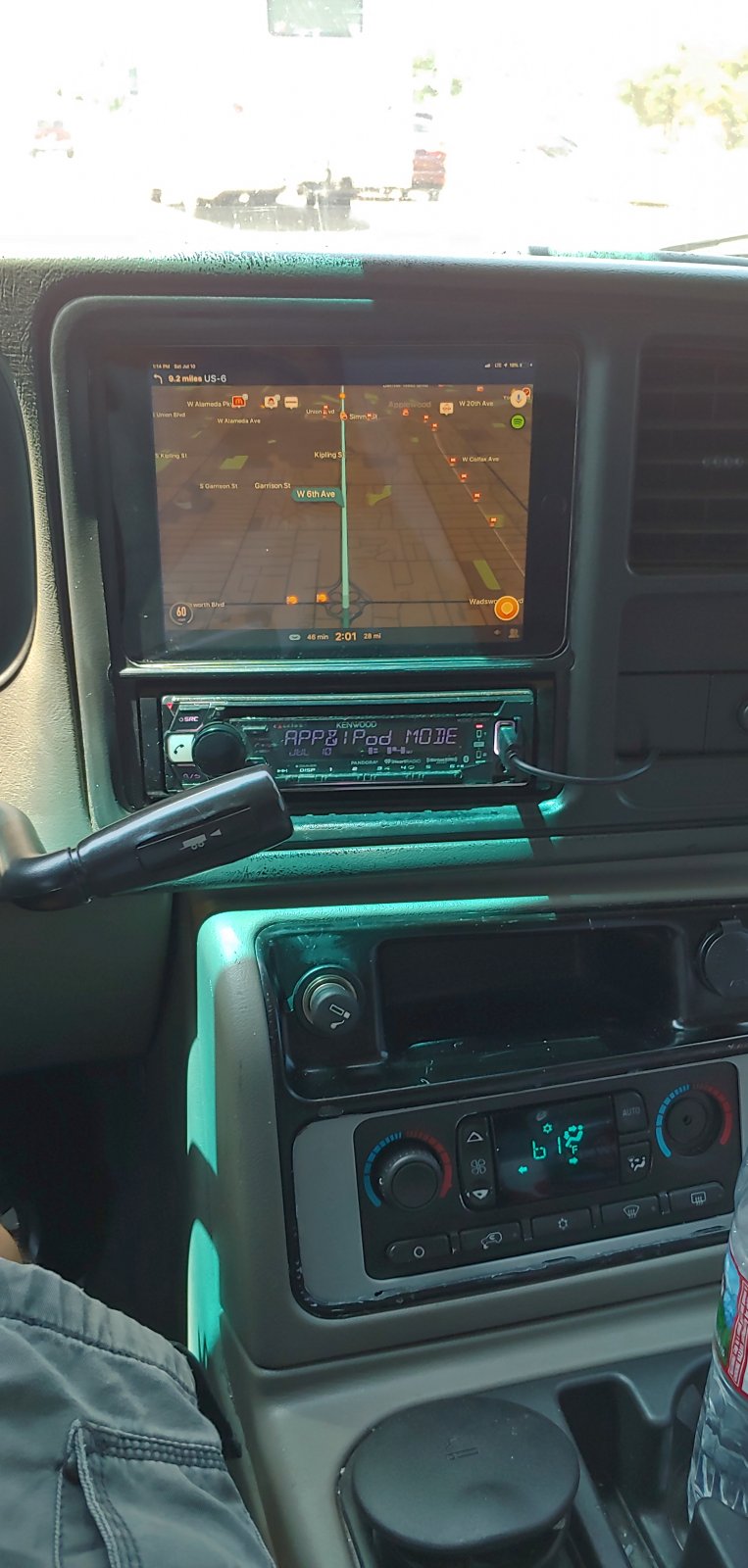

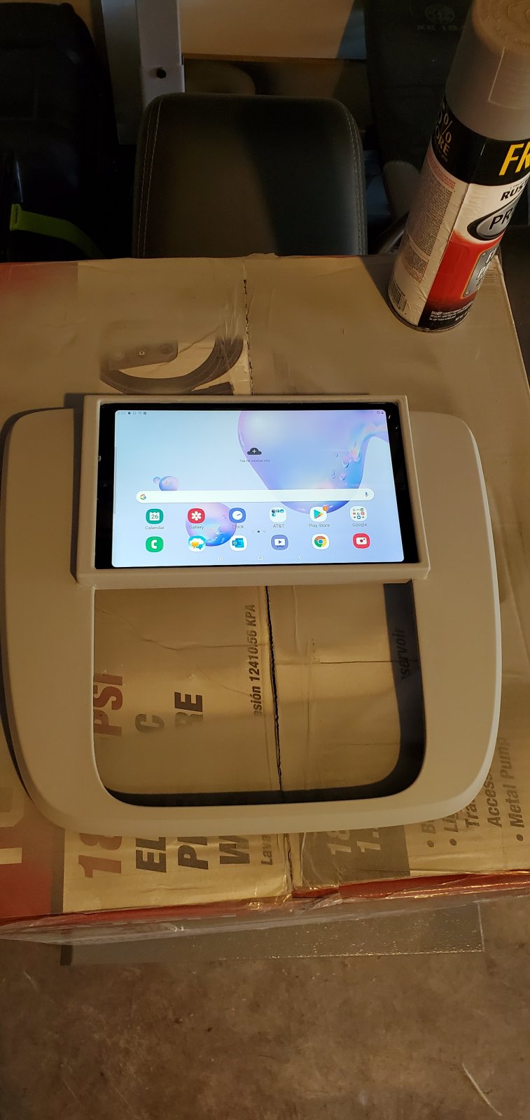

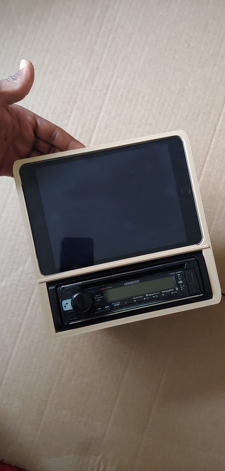

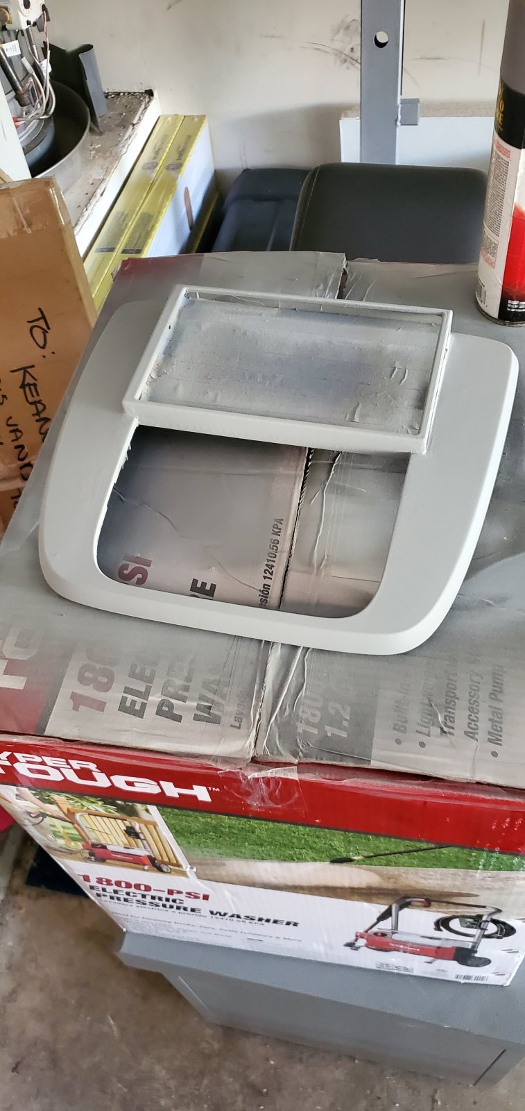

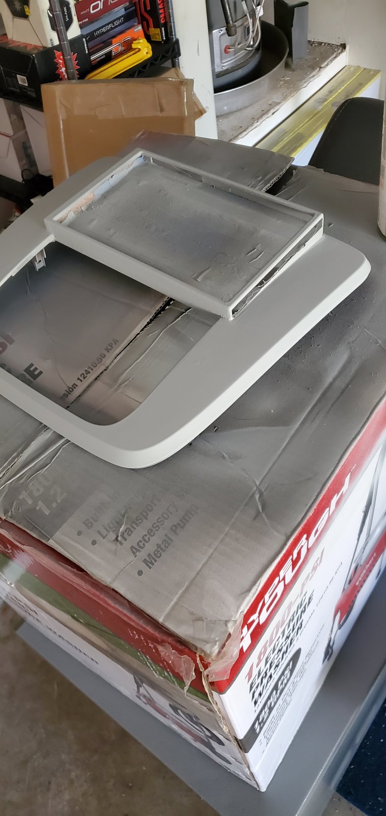

I'm redoing mine. I'm about $60 in materials and a little elbow grease. I think its coming along pretty good. Been working on it for 2 days. Im doing a 8.4" Samsung Tab A 2020. Still debating on wireless charging.
Found a guy on ebay that 3D printed a kit for like $15 and using a Metra 108-gm2b kit. Married them together! Not finished but coming along pretty nice.
I'm using a Sony radio media player behind it. They have the best radio app in my opinion.

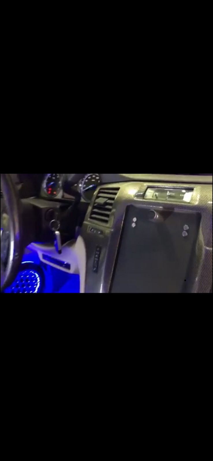

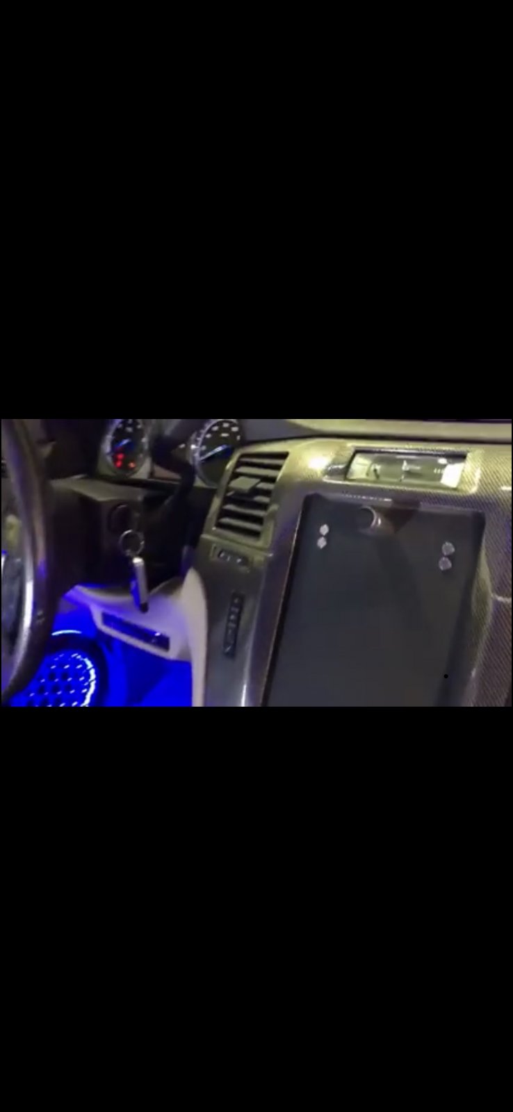

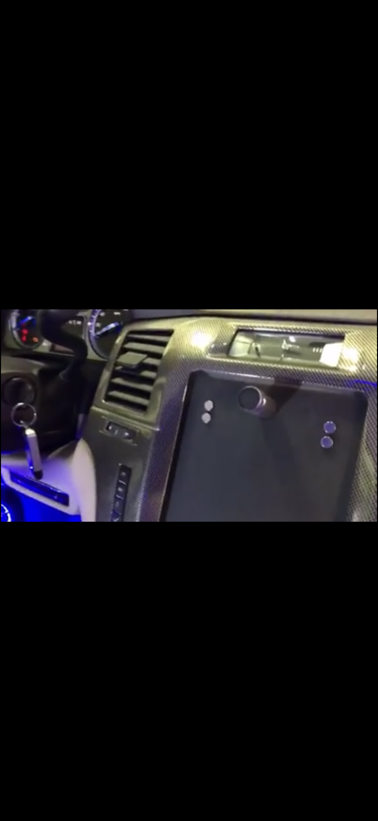

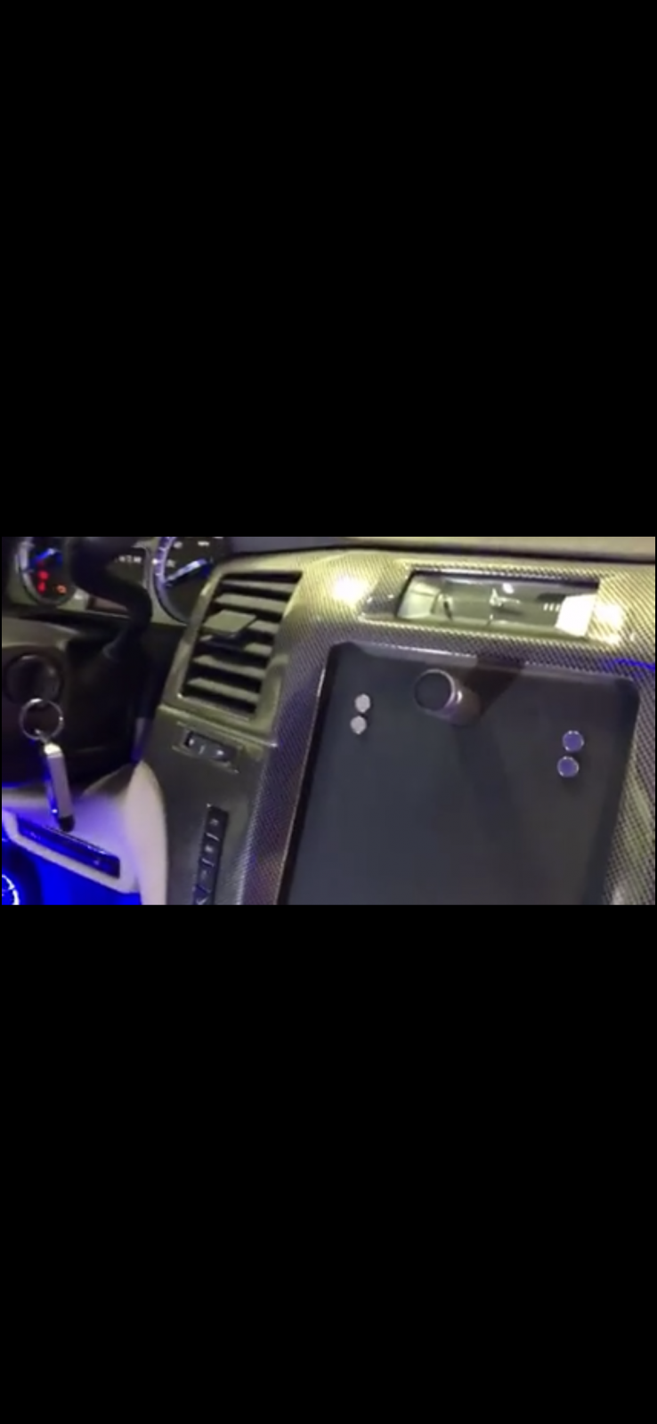

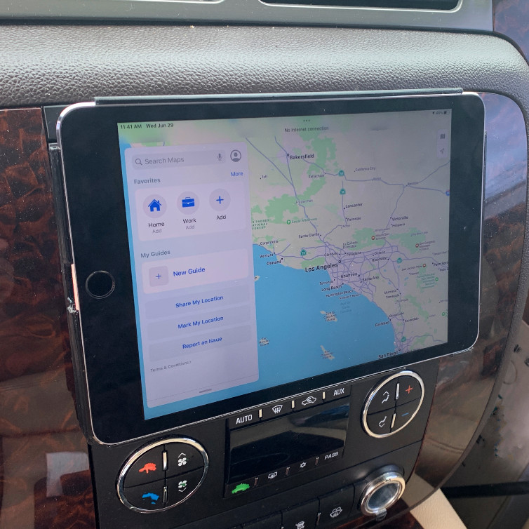

Neo magnets are your friend for most car audio fab related stuff. Holds tight and easily removable if you need to service anything. Here’s a video of a friend of mine who did one in an Escalade (2012) used a small motor to release iPad when needed.
My only tip would be to remember to have your lighting cable/ charging plugs in the back.
Have a video of it moving and locking into place but couldn’t upload it.
View attachment 261723 View attachment 261724 View attachment 261725 View attachment 261726
You could upload to yt then post the link here.

I love magnet mounts but plz be careful. You get in a wreck or slam the brakes and that iPads now a flying projectile.. I’ve seen some f’ed up things happen inside vehicles where radars, speaker pods, mounts were not mounted securely.

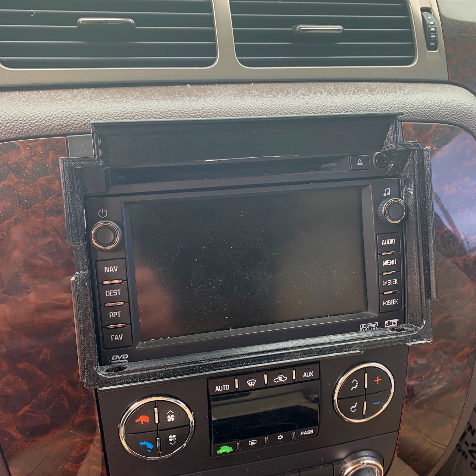

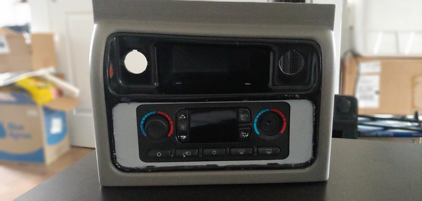

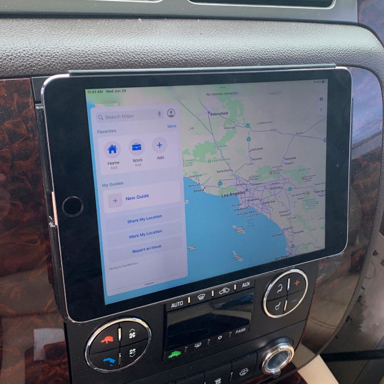

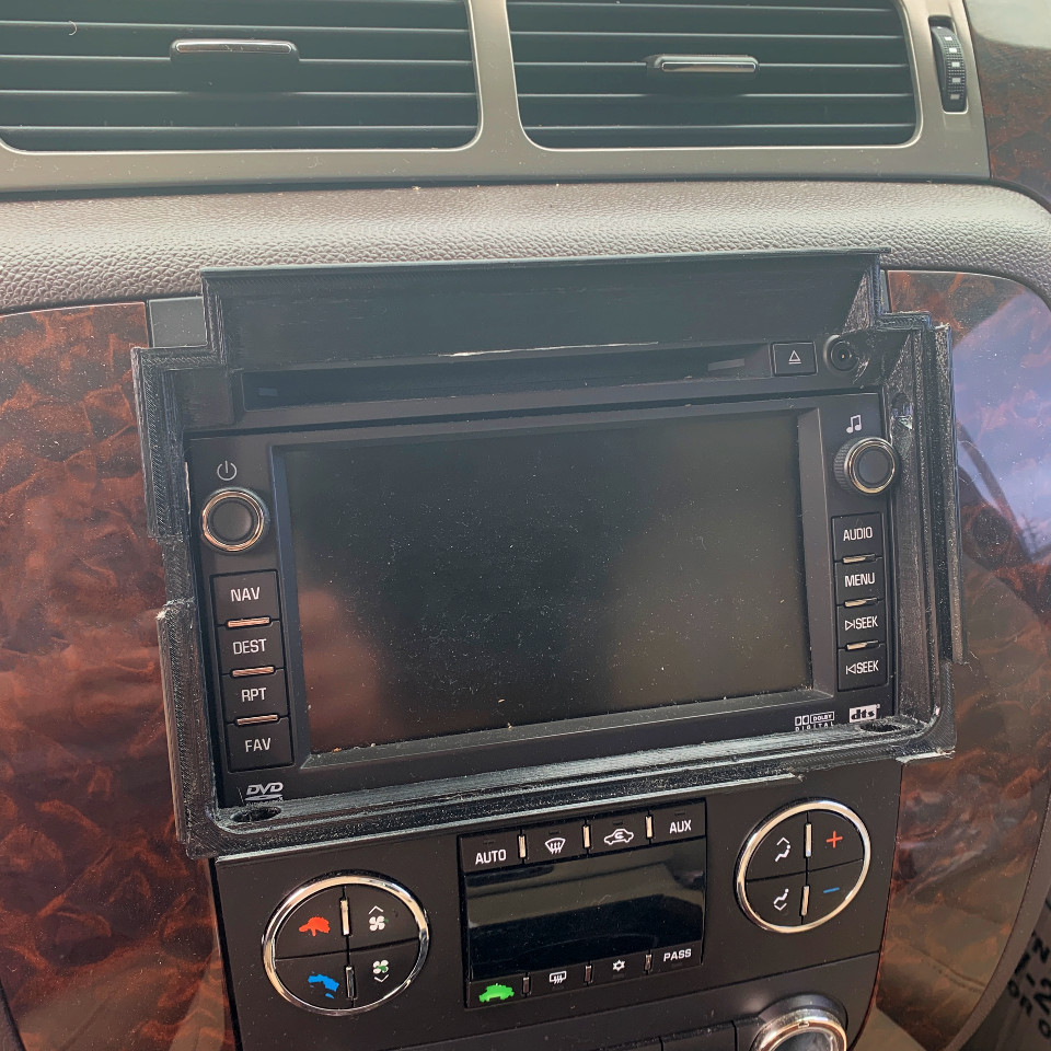

Hey guys, I found this thread via searching. I've come up with a solution for this problem and wanted to get your feedback. What do you think of an iPad dash kit mini mounting frame that fastens over the stock radio? The mounting frame sticks on the 07-14 Tahoe/Yukon dash with 3M heavy duty tape, and the iPad mini snaps in and out. You still have access to your radio behind it. The buttons and ports are accessible. I put some holes in the bottom, so you could use a u-shaped ipad charger and hide the charging cable behind the ipad. Ive attached some pictures of it. What do you think?
33,344
51,835
Hey guys, I found this thread via searching. I've come up with a solution for this problem and wanted to get your feedback. What do you think of an iPad mini mounting frame that fastens over the stock radio? The mounting frame sticks on the 07-14 Tahoe/Yukon dash with 3M heavy duty tape, and the iPad mini snaps in and out. You still have access to your radio behind it. The buttons and ports are accessible. I put some holes in the bottom, so you could use a u-shaped ipad charger and hide the charging cable behind the ipad. Ive attached some pictures of it. What do you think?
View attachment 374596View attachment 374597
For the minimal effort involved, I think it looks good. No sarcasm intended.
