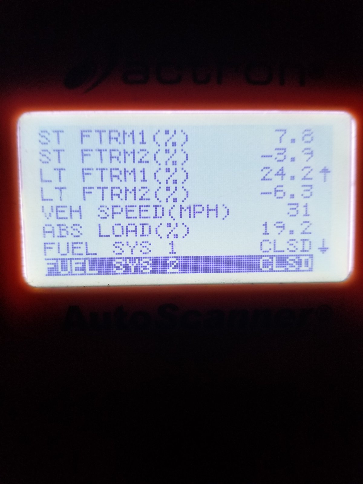

    I looked at my short fuel trims this morning when i get on it it bank 2 shows higher than bank one
