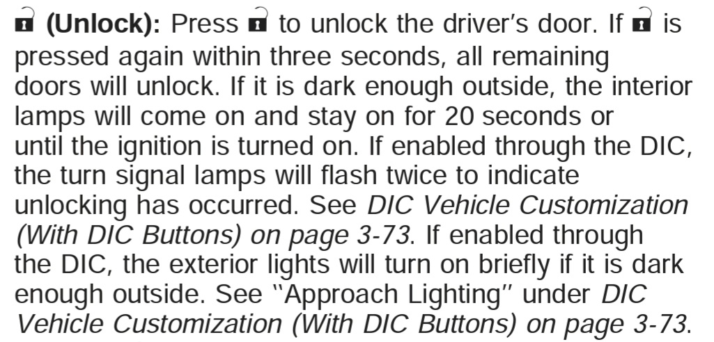

Manual says "if it is dark enough outside, the interior lamps will come on and stay on for 20 seconds or until the ignition is turned on."
Mine do not. I can turn the over ride switch all the way clockwise and they all come on, but this feature as explained above, doesn't work.
They don't come on when the RKE unlocks the doors or when you open the doors.
Any thoughts? Thanks in advance.

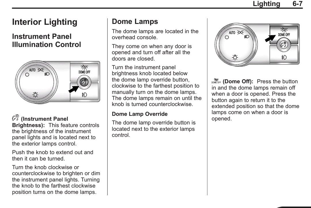

SWAG Not sure what your headlight switch looks like but is the Dome Off button in the position to keep them off? Exercise the override button (in and out) to see if the contacts are dirty.
I've tried the the dome over ride button in both the in and out position. No difference. Anywhere along the full turn, no difference. Just past the full turn where it clicks, lights all come on and stay on and won't go out. If the vehicle is off long enough they time out, but they all stay on while I'm driving so that doesn't work either.
