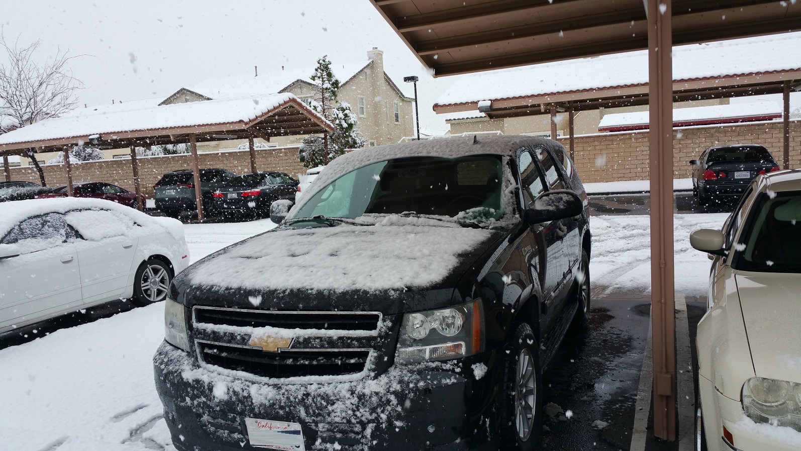

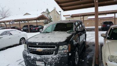

i suggest Michelin endurance
24 driver/22 passenger side... pretty quiet even when "dry"
no wind noise or lifting
I used 24/24 on mine. you can see how crisp it cuts threw the snow
