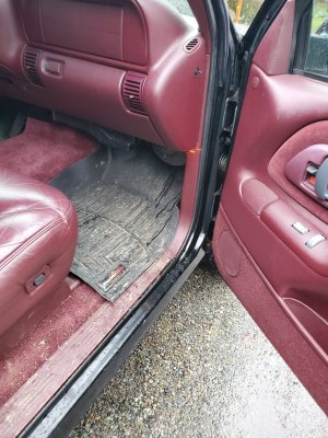

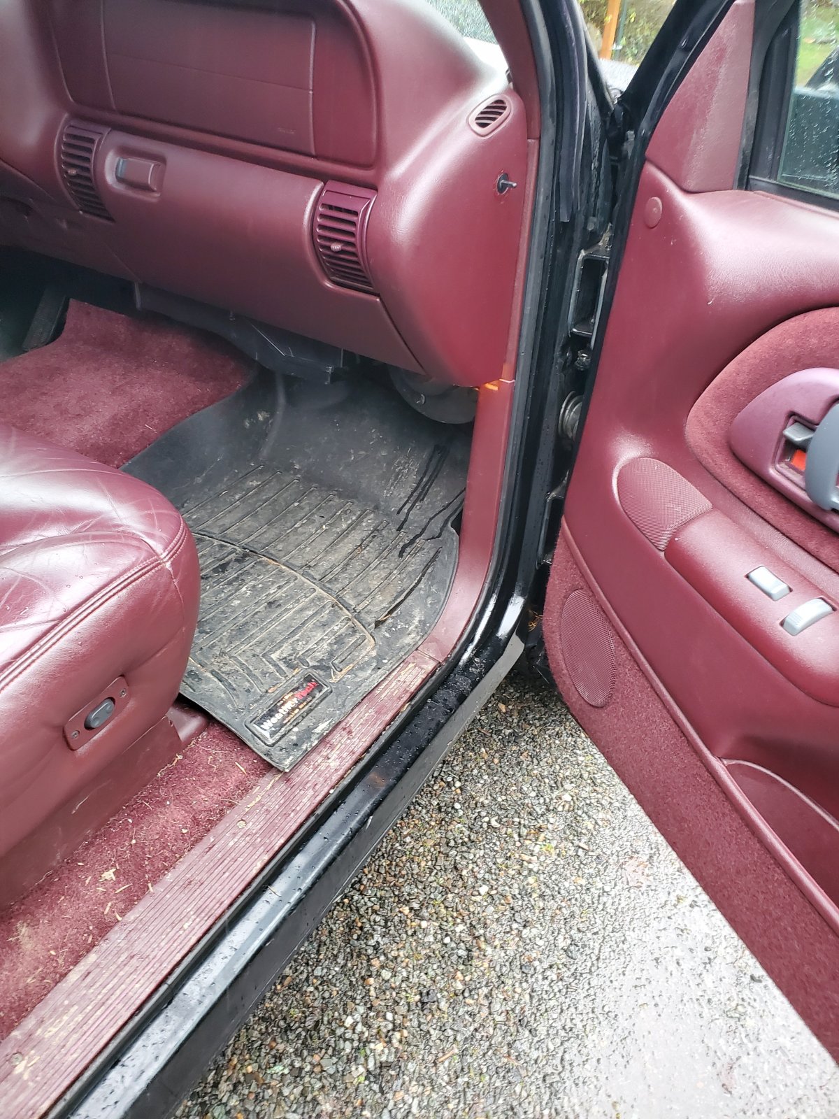

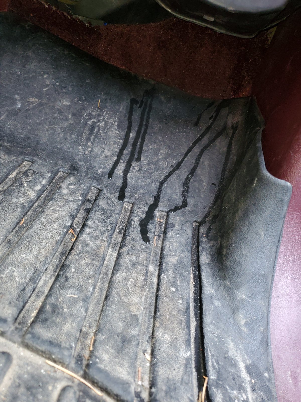

High pressure car wash revealed this

Looks like a good possibility and I would want to check if the w/s leaks as well. Till I saw the video I was guessing the w/s but that video opened my eyes to other possibilities. Good luck with the leak search.

I bought a 1997 silverado that leaked in that same manner. I found a missing screw under the plastic cowl panel. I think maybe a careless windshield install in the past was the originator of the problem. Easy fix once the source was found.

Mine is cracked in that area. I flex-sealed it.

watching this one. i replaced both front door seals for excess wind noise and drafty. i also have a similar small leak after heavy rains. was there before and after door seal replacement.

Take apart blower motor clean out debris there is a drain probably clogged small leaf bits dirt and whatever comes down from the cowl there’s a video on YouTube if I find it I’ll post it
Thats a really good idea, mine hasnt been sounding particularly healthy lately
