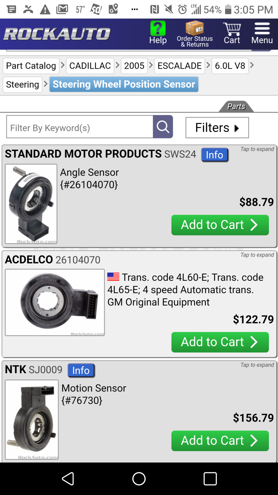

No slop is great. Means your box is in good shape. I think i have the same problem where it seems to be far too easy to turn the wheel. Could be a steering wheel position sensor or something like that like i mentioned. If i understand the issue correctly when that goes bad the power steering stays in low speed mode (high assist) all the time. Its like a $100+ part. Dont get an aftermarket one.

I looked it up a lot of people are referring to an EVO sensor. On the steering shaft. Sounds like you might be able to service it with wd40? Im going to have to look into that.
I think this is it.
I think this is it.
Wow awesome insight. thanks a million for pulling that up!
