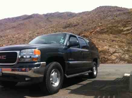

Guys. I'm visiting my sick uncle in El Paso, TX, from Dallas,TX. It was about peak of 80 degrees outside. I Was driving around for about an hour and I went to pick up my aunt from work. I waited a little over 30 mins waiting for her. I was idling for that time and had the AC on. I went to drive to the highway ( 5 miles) and I turned and press the accelerator about 85% (20mph) to the floor as there was an 18 wheeler close. It hesitated and the motor acted like it was going to turn off and it did. I pulled over and turned the key and it wouldn't start. It turned for a second or two and it died. It seemed like if it needed gas but I have 3/4 tank. I kept trying and trying. After 5 minutes it turned on. It was driving fine under normal driving conditions with no AC on. I they attempted to do a WOT and the motor and transmission engaged but it didn't really put me back on my seat like it always does. I went faster but not like it always has. Once I got to Autozone it turned on and off like if nothing happened. Just the WOT deal. I went to my uncles house and let it cool down. I took a spark plug out but no wears of oil or gas. This truck is always at normal temperature conditions at all times (205 degrees I think). I took a drive a little ago and it put you back in your seat and sounds healthy. Can anyone please share any experiences like this or let me know what I need to check for or possibilities. I really need your guys help. I'm leaving tomorrow and don't want to be stuck in the road.
