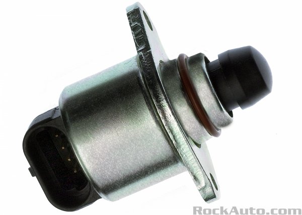

I believe the "elongated electronic throttle control" on the passenger side is the IAC. It should look like this. Also, I'm pretty sure 2002 was the first year for electronic throttle control. I know when I was buying my Whipple blower, BlackBear had me check to see if my 02 had electronic throttle because supposedly they came into the LQ4's midway through 02. It consists of a computer in a box mounted to the firewall near the brake booster and the pedal with wires attached that connect to the box. The box connects to the TB through a wiring harness.

Only issue I have with the elongated part, is there's no pigtail ran to it, dang sure doesn't look like an IAC. I stared at pictures of that all day wondering where that exact part was. Unless it's just a casing. Lol. Unless my throttle cable is ghosting me too, it's nowhere to be found. Only reason I assumed I was electronic.
