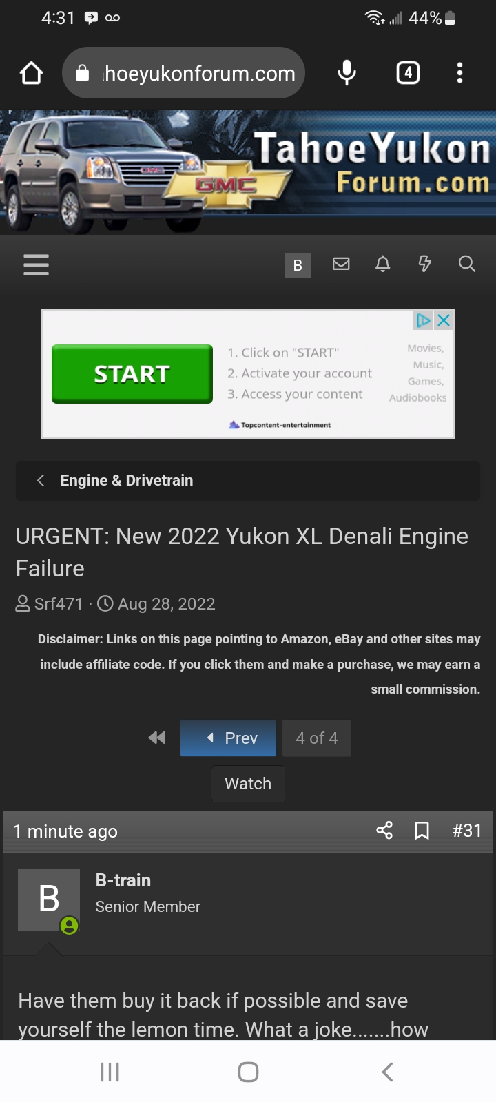

See this posting in attached pic.....it seems to be more common unfortunately. I'd go after by back or lemon if I were you
