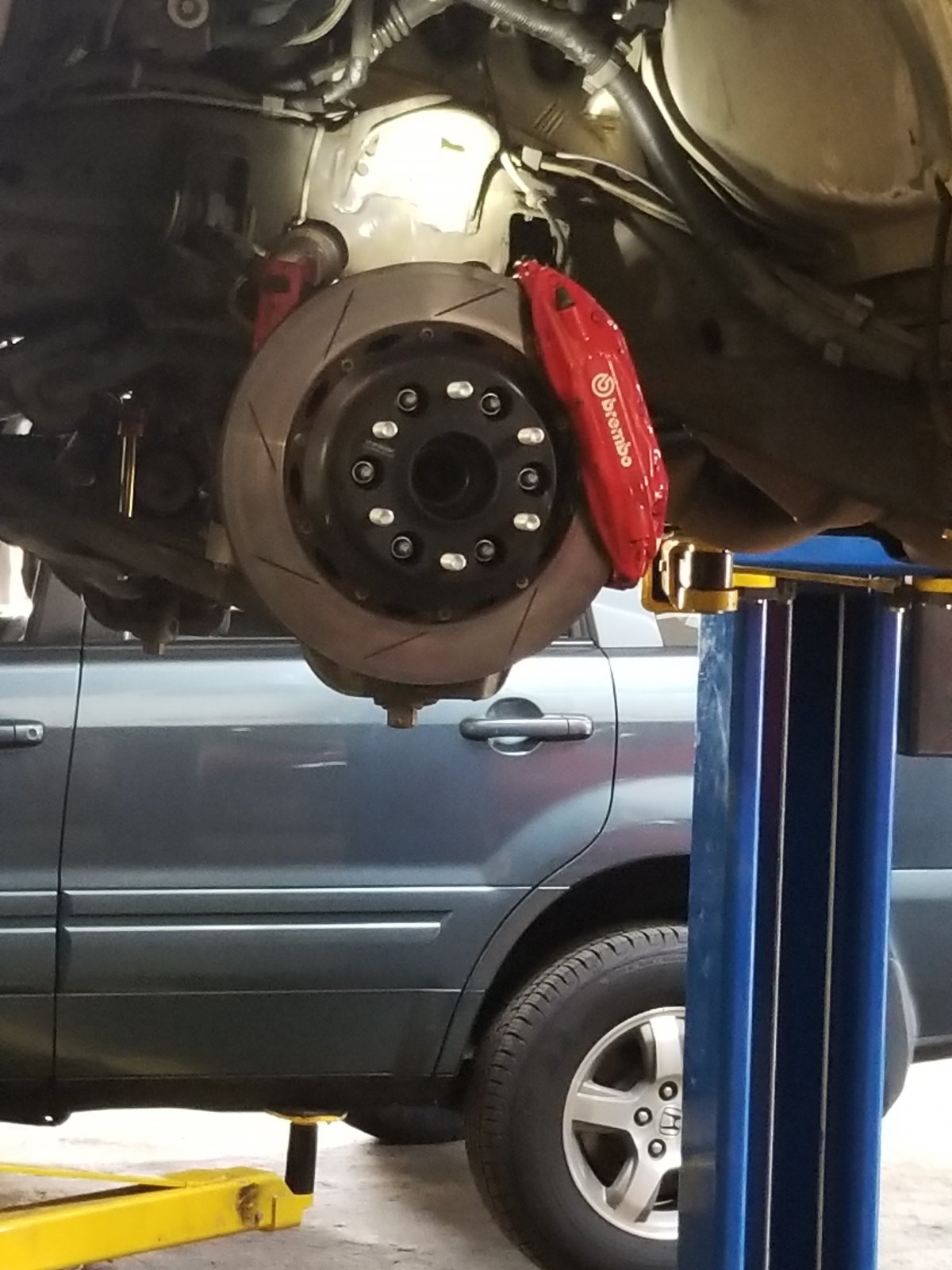

I never updated on what I settled on for brakes. I am talking to a local machinist about possibly making a bracket to bolt Cayenne Q7 and VW Brembo calipers on the back of the SUVs. I think the rotors are the exact perfect size. Upfront the rotors are a little bigger but Eradispeed +1 might work out perfectly. They made a bunch more of those SUVs than C6Z. The calipers are stupid cheap and readily available and replacing the front rotor might be all that is needed.

Well.... The NNBS rear rotor is nearly the exact same size as far as height as the NBS. The NNBS is also a larger 13.6" or 13.8" rotor (as opposed to your current 13" rear). The swap is not worth it because the NNBS has a single piston caliper as opposed to the NBS factory dual piston. BUT, If you are going to upgrade the caliper anyways...
Not sure how big you want to go.
I'll bet a bajillion dollars those NNBS rears are going to be a lot cheaper than a Porsche anything... Those rotors are probably cheaper than a Porsche keychain.

You were saying? If a bracket can be made to bolt these to the rear end housing and retain the stock rotors and parking brake assembly what's the problem?
https://www.ebay.com/itm/New-2008-1...AOSwcUBYUCZZ:sc:FedExHomeDelivery!36109!US!-1
These are the Cobalt SS Brembo calipers. They are more expensive and weren't designed to stop a heavy performance SUV like the Porsche calipers. Let me know and I'll pass along my PayPal info so you can send over that Bajillion dollars.
52,949
Neither of those were designed to stop a big SUV and it seems like a lot of hassle to have brackets built to mount something with unknown braking power up to your rig but if it rings your bell by all means go for it. I’m just glad I won’t be riding with you. My Wilwoods are 3 times the size of those and after some hard runs, I trust them with my life. Those, not so much.

A Cayenne isn't a big SUV? 5000 lbs and the Yukon is around 5400 lbs. 2 passengers in a Cayenne and you have similar curb weight to a Yukon. The Cayenne has 6 piston front Brembo calipers and 4 piston rear Brembo calipers. Do you think the Cayenne and Q7 calipers are better equipped than C6Z calipers? I'm glad you trust your life to your Wilwoods......because you'd have a bad day if you hit the brake pedal and it went to the floor and you didn't slow down.

I’m saying those brakes are waaaayyyy smaller than my Wilwoods. Have fun messing around with your life.

And those brakes are WAY bigger than what came on your truck. If some brackets can be made that make it possible for people to upgrade from 2 piston calipers to 6 piston calipers there's nothing wrong with it. By the way I'm not messing around with my life by the looks of it.......

Oh good for you. I was thinking you might actually be looking for the model that had brakes larger than what you already had, but guess not (13.0" vs 13.0"). Sounds like I was the one who should have specified that we aren't talking about the calipers that have pads TWO-THIRDS the size of what you have now.... but good luck with that custom bracket because it says "BREMBO" on the side.
While were at it; where did you get 5,000 pounds from? Try comparing curb weight to curb weight or gross weight vs gross weight. They are not close.
